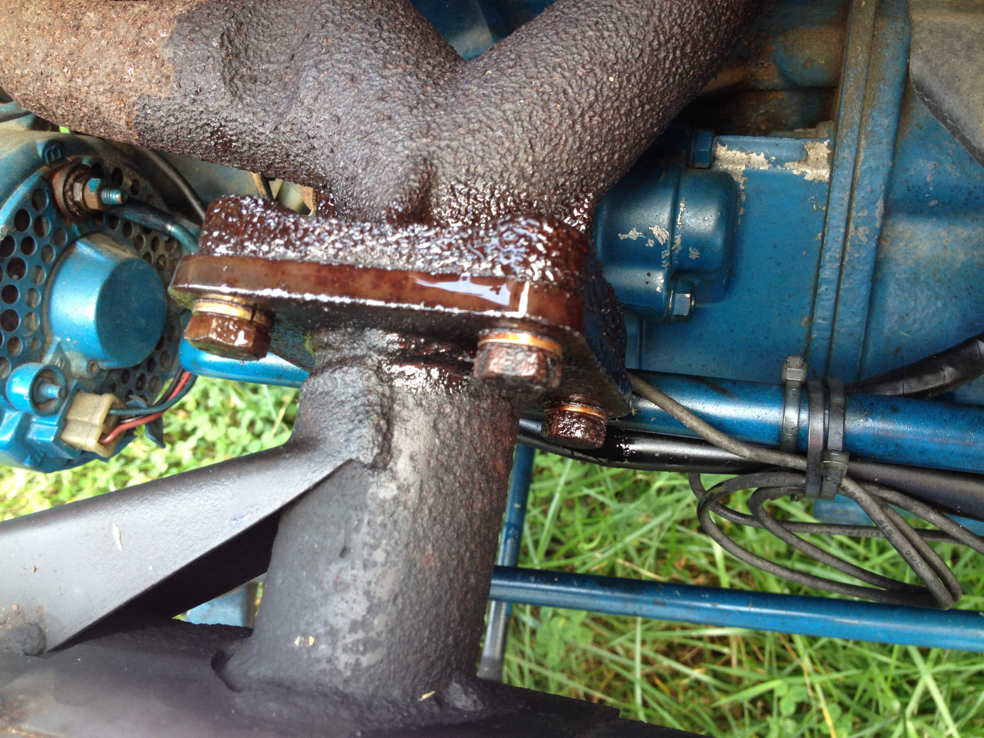

Back on 8/7 I posted that I'd started to soak the muffler bolts on the Ford 1210. I know I had the muffler off to repaint the tractor in 2002 or 2003 and the bolts haven't been disturbed since. For some of the time since then it was in my Mom-in-law's barn but it has spent a lot of time outside. The muffler leaks badly and needs replaced.
I picked up an old-fashioned oil can for the acetone/Dextron mix. I wanted to avoid seals, O-rings, etc because of possibly damaging them. Since 8/7 I've squirted the bolts a few times and tonight I took a 13mm combination wrench to them. To my delight all 4 bolts backed out.
:thumbsup:patience is the key
