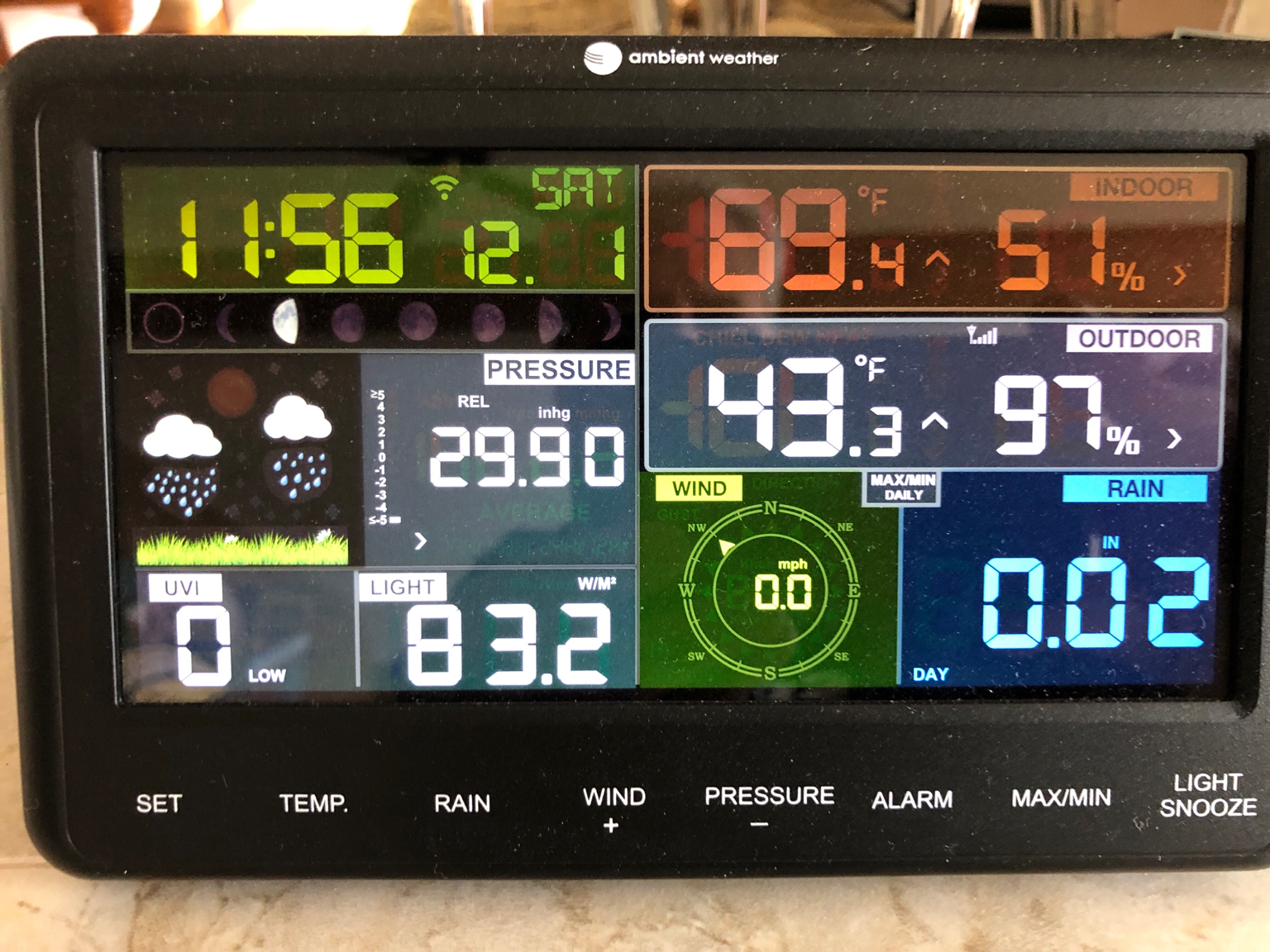

Here isa pic of my console. Showing 0.02in rain accumulation today.
   / Personal Weather Station - Suggestions? #74
Ha ha! I can say that I have zero rain for the day! Not very often that I can say that during this time of year :laughing: (might have to arm-wrestle you as to which one of us gets more annual rain!)
The total precip (whether hourly, daily, weekly, monthly or yearly) is, according to Ambient, reportable down to 0.01". For me it's the Rate (which is an extrapolation out to per-hour) that's seemingly odd. In the setup you should be able to set the rain reporting to instantaneous/rate. It's this value that is claimed by Ambient to be reportable down to 0.06 (it's stating hourly rate, meaning current 10 minute window times 6 window slices for the hour). On the 2902A I've seen the rate down to 0.05, and on the 1001 I've only seen (from three different reporting sensors) down to 0.07.
