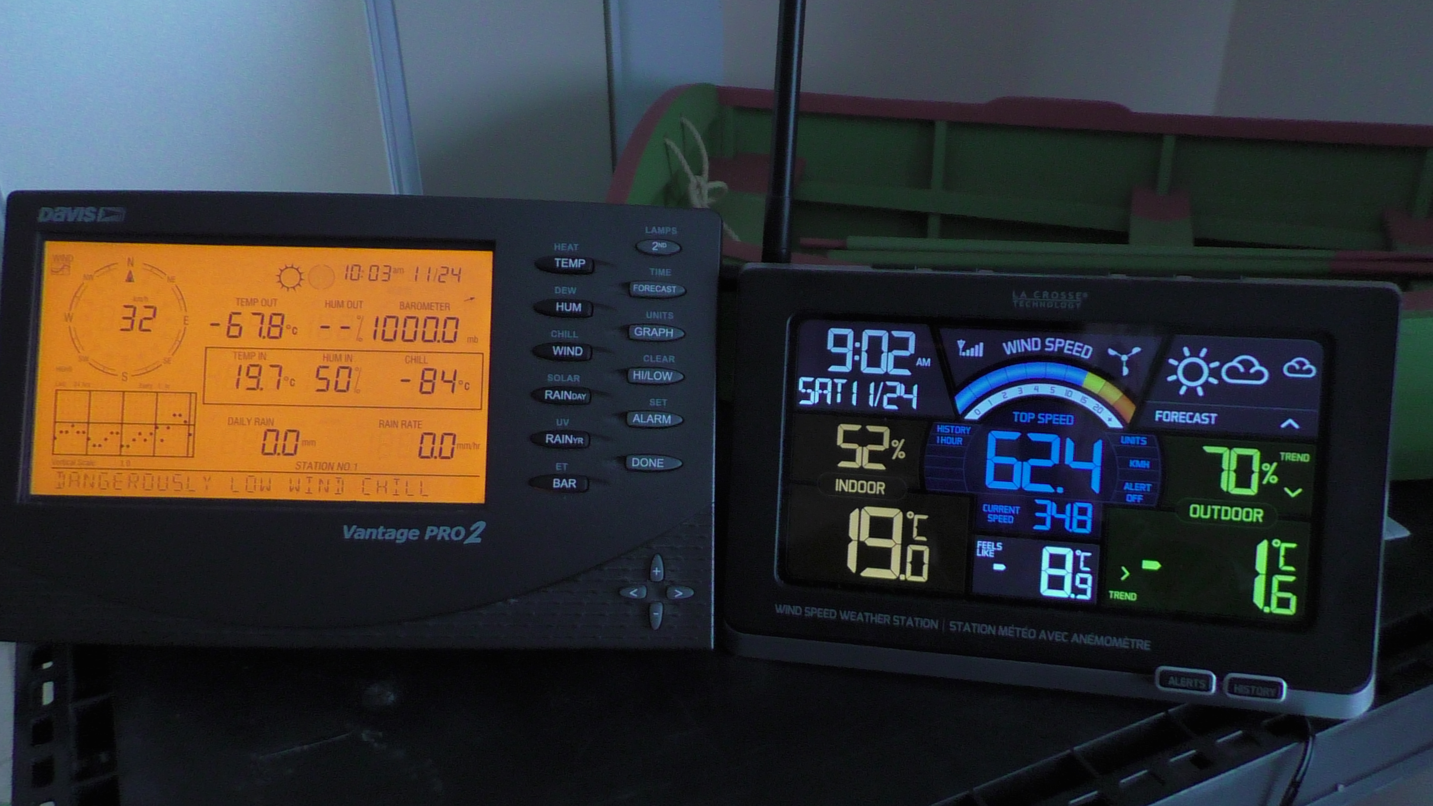

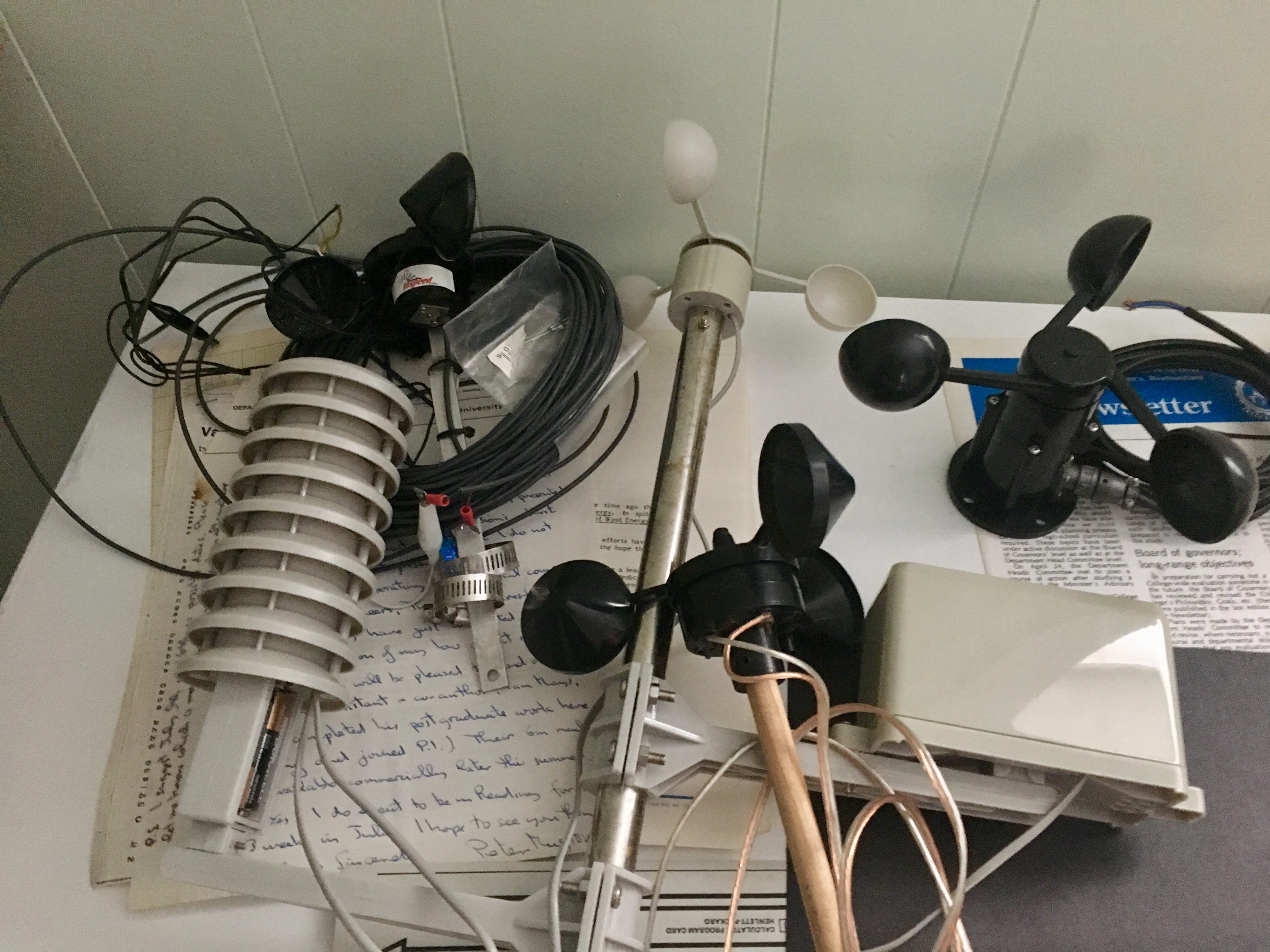

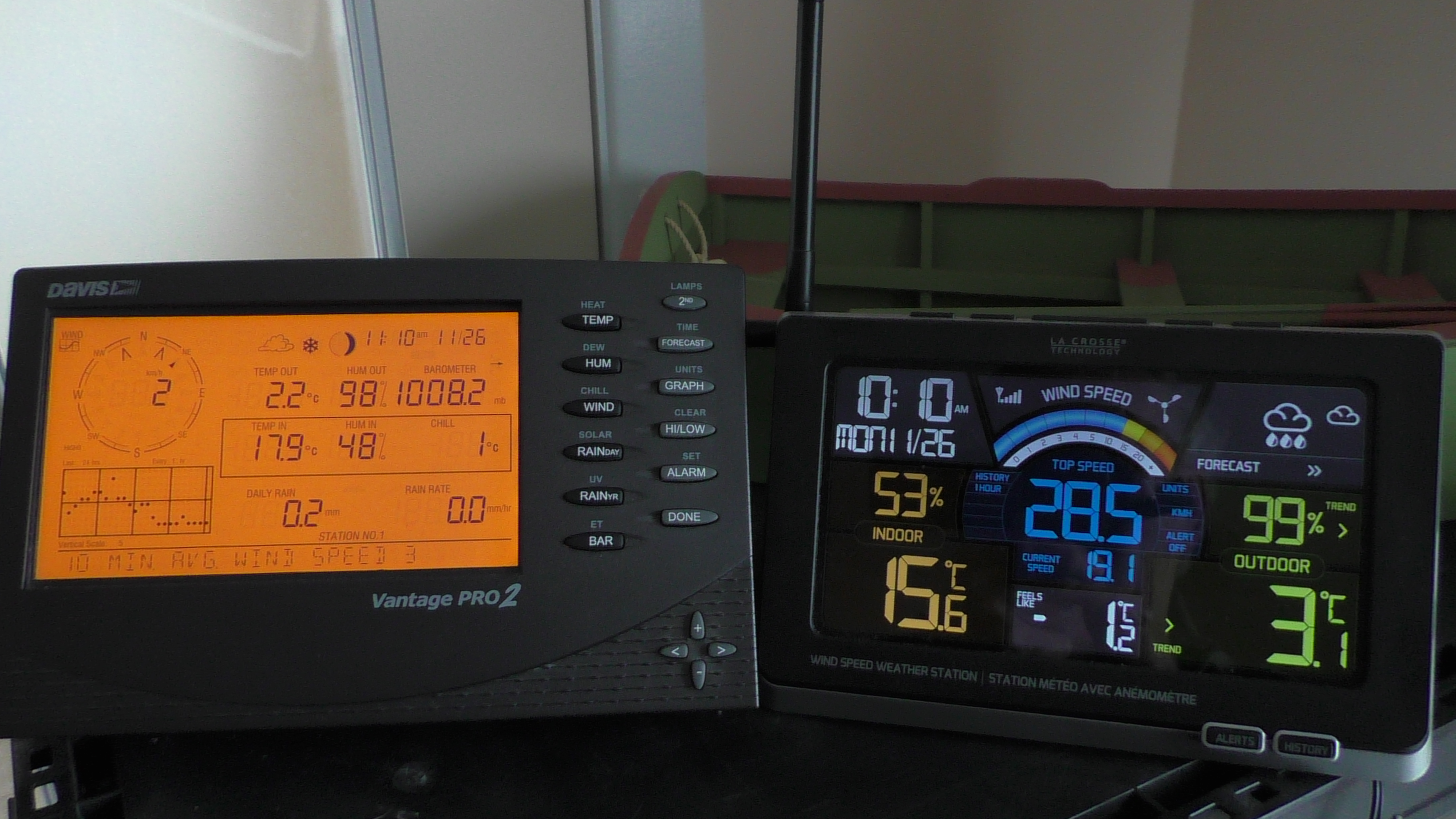

S5220001.JPGIMG_9594.JPGS5240001.JPGWind speed is the most important bit of info that I need but I've had a heck of a time getting anemometer system that will give what I need over long periods of time. Just took this photo showing just some of the units that have not made it.
I've had the Vantage Pro 2 for about 7 years and it performed good for most of that time but over last few years the wind speed has been reading low or zero even when the wind is way up there. This is a wireless unit. One peculiar thing is that the outside temp/humidity comes and goes in terms of the display.... but when the temp/hum is working right on the display (and when it is working it is accurate) the wind speed drops down to much lower than actual wind and at times will read zero even when the cups are going crazy. Anyway too early to be overly critical at this time as I am still evaluating the situation. That's an inexpensive La Crosse station that I'm using to show what is going on relative to the Vantage Pro. I am collection video clips on all of this and will get something done up for Youtube eventually.
