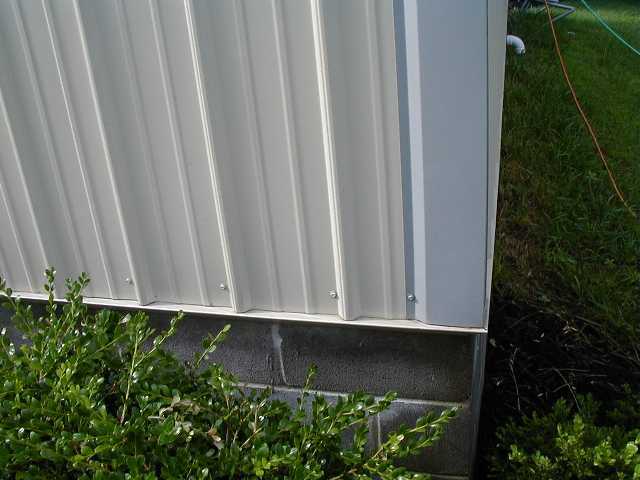

You need to click on 'Accessories and Trim' to find the rat guard. Instead of a J molding that would trap water, it is an L shape with the curl of the J going back down to the wall.

Guys,
Any boby have a good picture of what these look like installed?
They go on the outside of the building once the panels have been installed?
Fred
   / pests VS. a METAL sided pole building.. #15
Don't know if this is the one they are talking about, but this is what I have.
   / pests VS. a METAL sided pole building.. #16
That looks really good. I wish the place I bought my metal from would have told about that. Looks more like L channel than J and I guess the metal is folded over to avoid a sharp edge.
I would not use J channel as is will collect dirt and debris then get wet and rust in few years.
   / pests VS. a METAL sided pole building.. #17
Good job Milkman, that is the rat guard.
   / pests VS. a METAL sided pole building.. #18
Thanks.
That helps.
I guess there is no way to install this after the fact.
It goes on before the siding?
Fred
