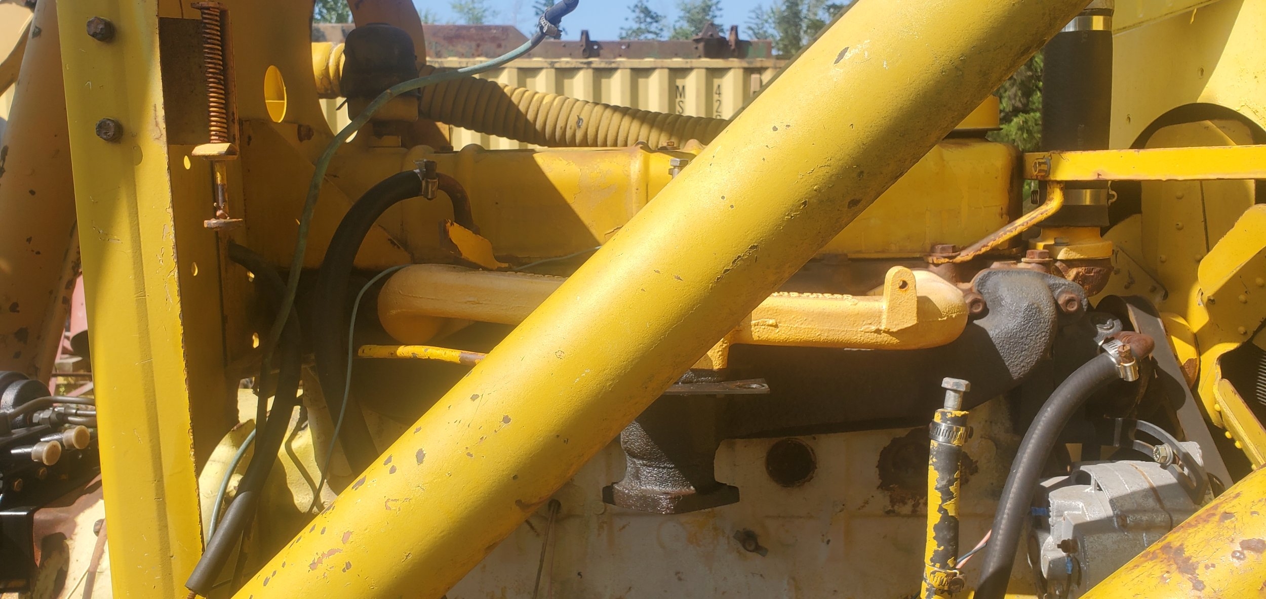

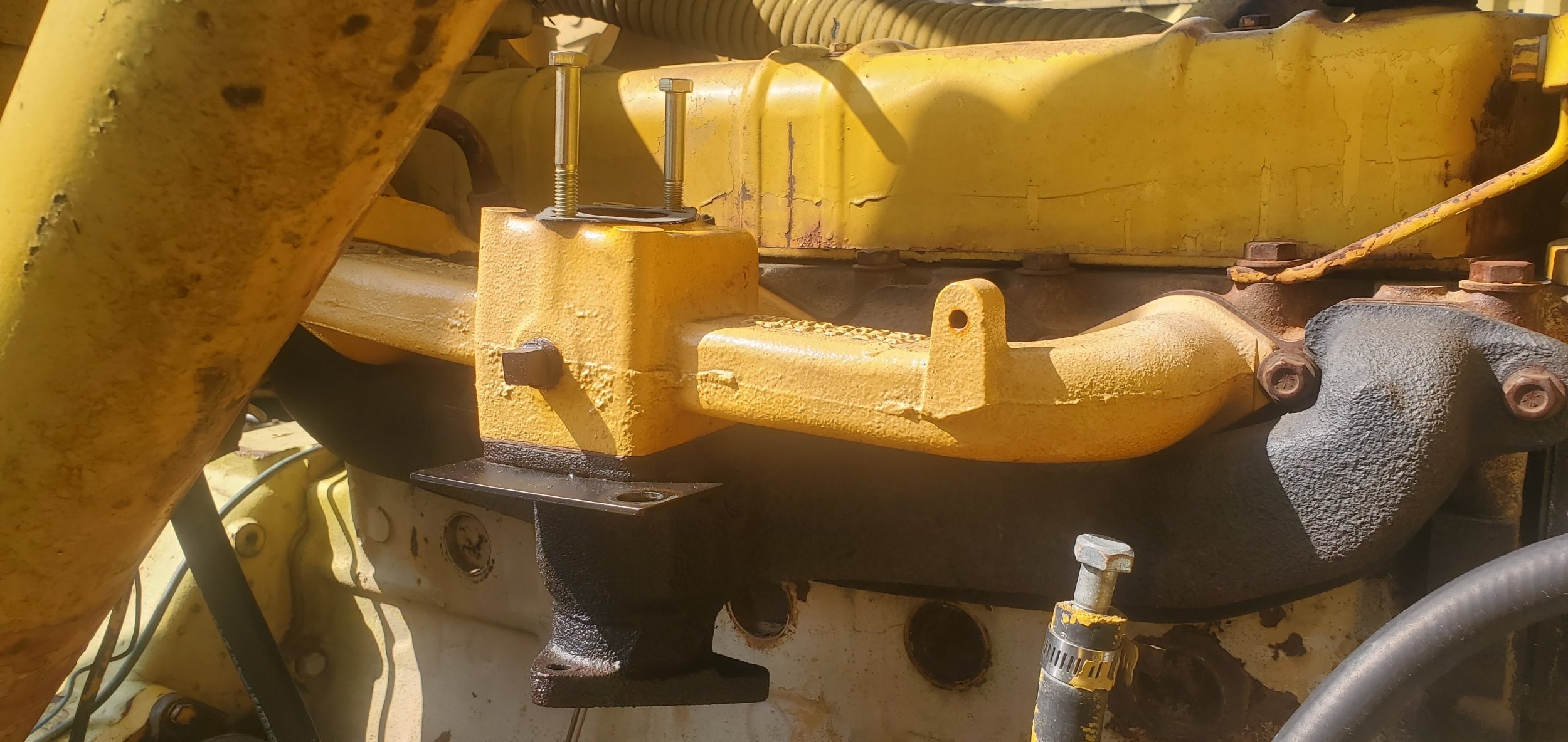

#9
I'm back on this machine and wondering if I can rotate the exhaust and intake manifold and switch to an updraft carb?
It would be way easier & cheaper to find parts for an updraft tractor carb, as the downdraft carbs seem to be collectors items now or something as replacements and kits cost stupid money. It would also be easier to route the exhaust out the top.
It looks to me the bolt pattern is reversible...
