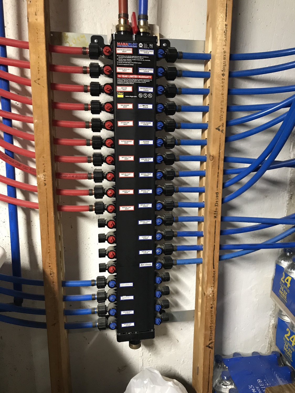

Then the third method I see is the manifold and homerun system. Obviously uses alot more pipe, probably not as efficient in terms of hot water usage unless local on demand types are used, but certainly easier if repairs are ever needed
