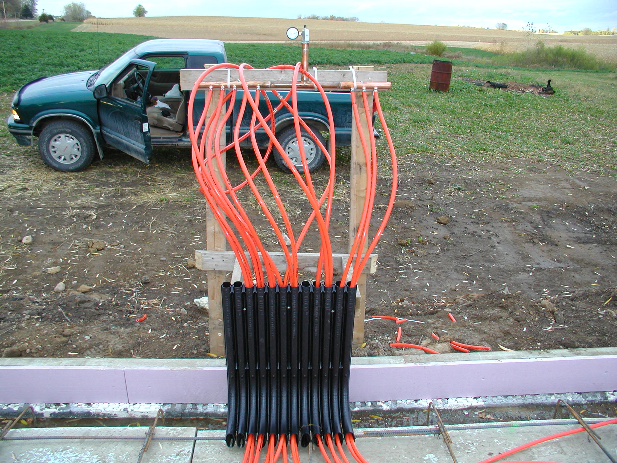

Here is a picture of my place using 3/4" tube

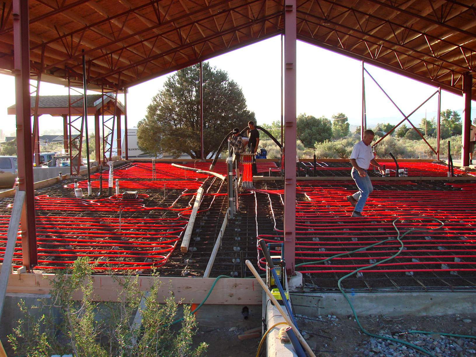

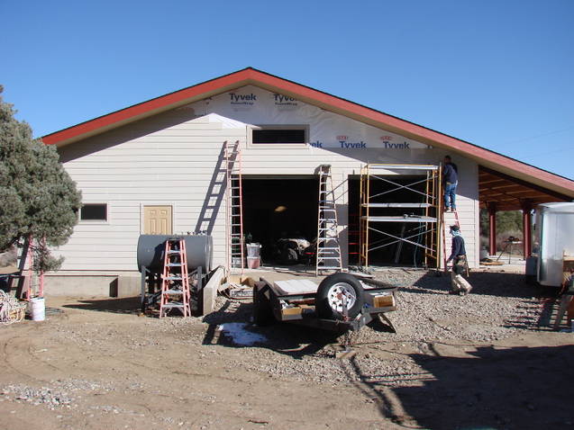

I bought a steel 48 X 60 building with a 12' extension on one side. I eliminated the diagonal seismic bracing and went with rigid box bracing that keeps the design open for windows and doors. Then I added their 3' overhang/eve kit, in steel, on the other side. I deleted the steel siding so I could use Hardy plank siding.
We set 3' square footings under every post. These go down 3' below grade. Then we poured connecting stem walls in between them. The front porch was poured hollow to make a room below for storage. A 12 X 60 back porch slab went in (under the overhang), the front porch was poured, then an 8" slab with radiant heating throughout. Then framed the whole house, sheeted the entire place with 5/8" OSB and sided it with Hardy.
I added a separate 12 X 14 steel frame and roof structure to become the front porch and set it at 90 degrees to the main building.
The roof was on for a year before we poured the slab and started framing.
Now I'm wiring, it's all closed in with windows and a wood stove.
We won't finish for another year or so.

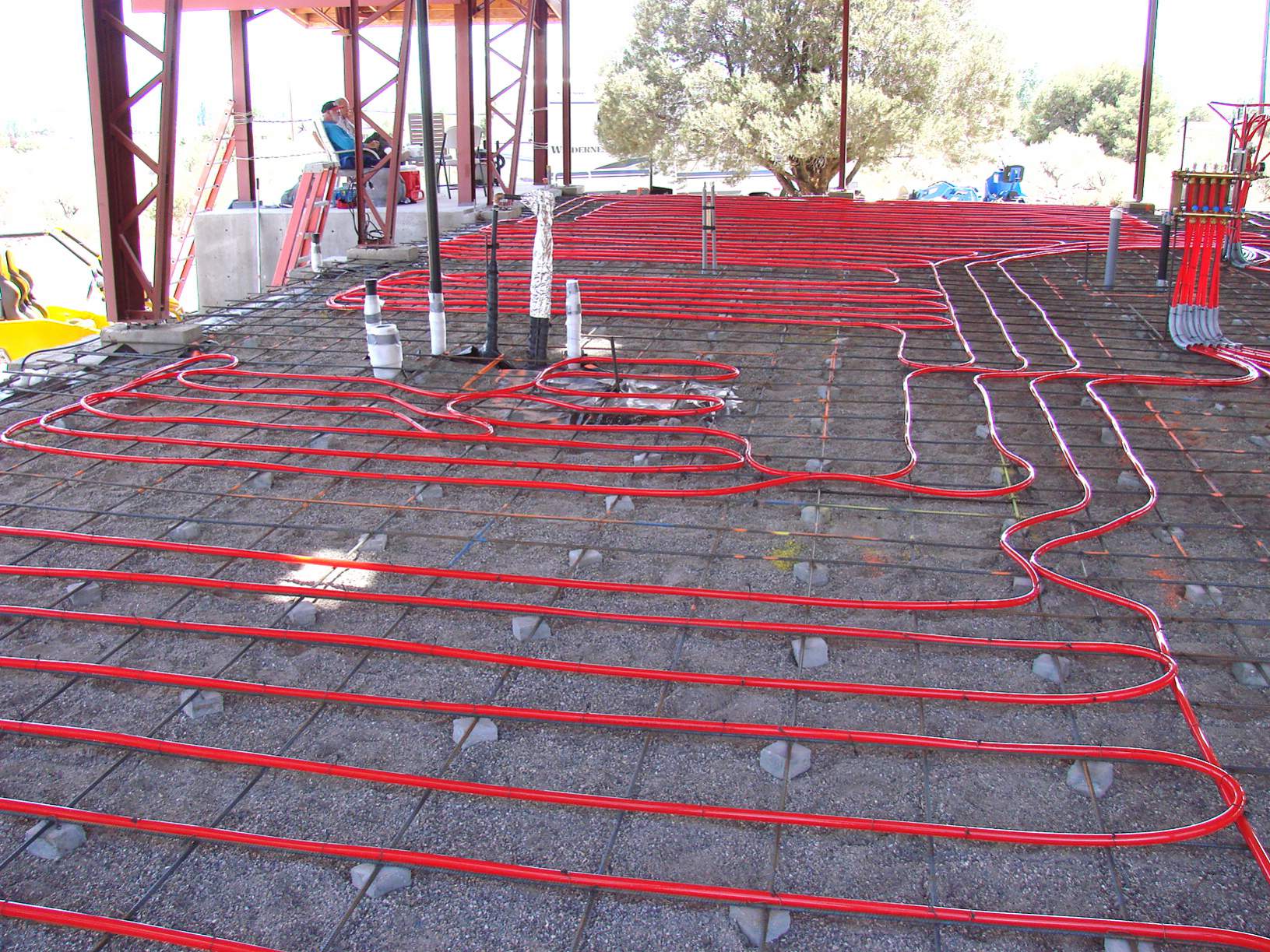

I can't show you anything on the heating system because I haven't installed the solar collectors, the storage system or the boiler. It will have (6) 4 X 8 collectors and 360 gallons of storage. The collectors will be arranged as a "drain back" system and will gravity drain to a small tank for freeze protection. A heat exchanger transfers the heat from the storage to the radiant loop. The setup uses a "solar" thermostat in the house for the "desired" or "max" temp. Then the other thermostats set the "minimum" allowable temp and run the boiler. A simple switchover system enables or disables the boiler burner depending on the available stored solar temp. So, the house has to be below the minimum temp and have no solar available before the boiler can start. The boiler vent pipe has an air to air heat exchange to supplement the garage heat. Fans in the living room and garage send down the stratified heat near the ceiling. Solar will be the primary heat source for the radiant and hot water. The backup will be heating oil on the radiant and an electric water heater for the hot water. There will be four thermostatic zones and a very simple control system.
With four thermostats we can just heat the areas we are using, and to different temps. The floor itself will act as some storage and wood heat will give the house a shot of heat in the mornings and evenings. The garage is about 1000 square feet and has it's own thermostat.
With radiant, the house doesn't have to be warm to feel warm. The nice floor temp can be cooler in the bedrooms for sleeping, warmer in the bathrooms and kitchen, and somewhere in between in the living room. It can be left off in the garage until I'm on a project and left off in the unused 2nd bedroom.
If I'm getting too much temp in the storage tanks I can add more to the floor for storage and if I'm beginning to use more oil than I want to I can lower the floor temp a bit or shut off unused rooms. Or the whole thing can be left alone and run automatically. I have (2) 300 gallon oil tanks to feed the boiler.
