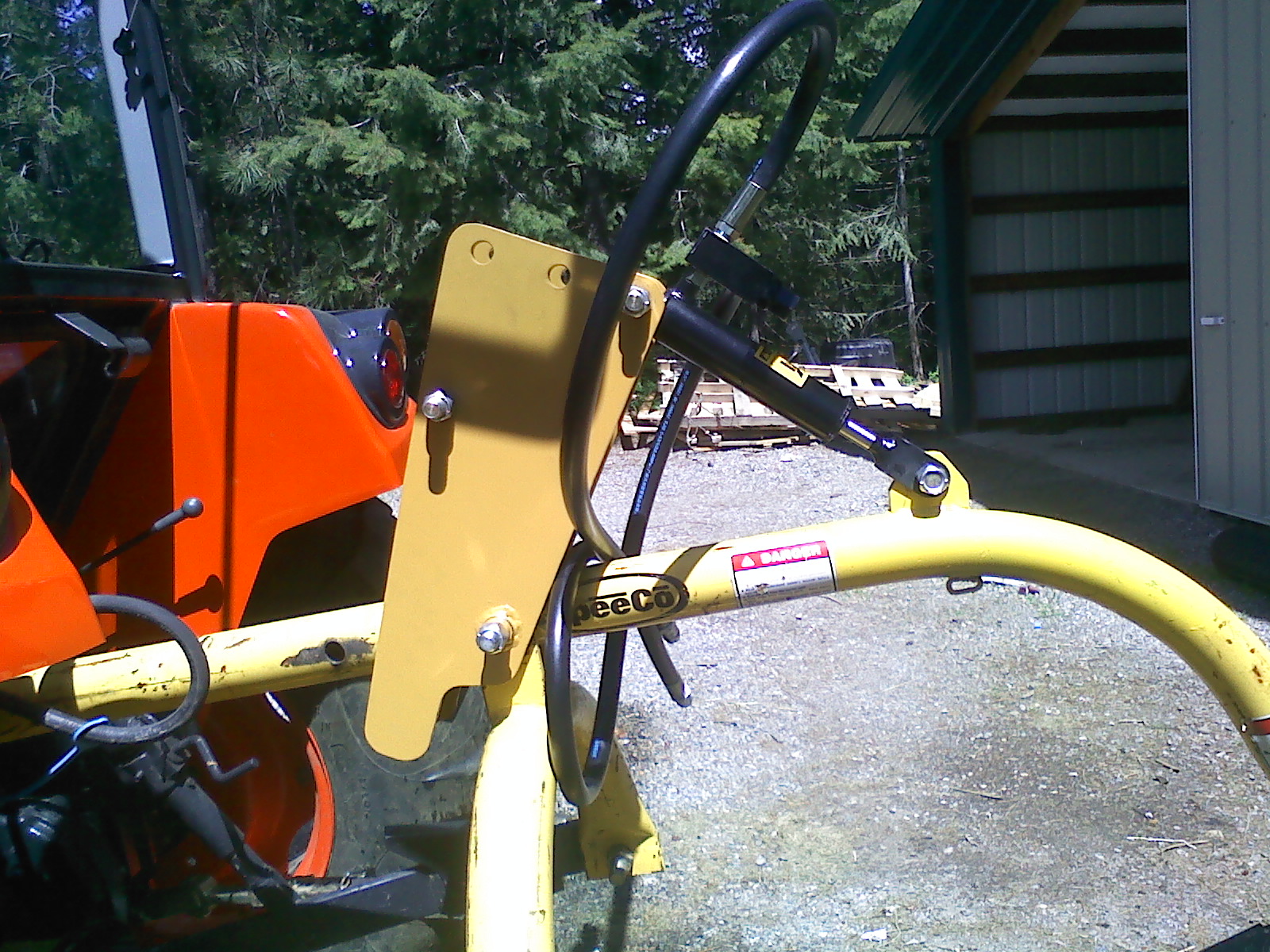

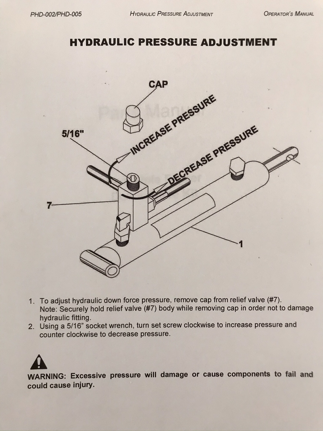

I purchased a Down Force Kit for a PHD from My local JD dealer. No one seems to know the answer to my question related to the plumbing of the hydraulic on this down force kit.
The hydraulic cylinder has two ports, you would assume that one end is to extend and the other is to contract but no, both hoses go first into a relief valve and the relief valve connects to one port on the hydraulic cylinder when the other port remains plugged.
I don’t understand how this works, because it doesn’t seem to work, and what SCV do I connect it to - I have a 3rd, 4th and 5th SCV. How does this work and where do I connect to?

The downforce kit requires hydraulic pressure from a tractor selective control valve (SCV) and a pressure-free return.

Thank you Peter 315, that makes sense. I assume the release is for the upward contraction so that the hydraulic isn’t fighting the 3 point lift. Where does each side (or hydraulic hose) connect to? Seems that one would be connected to one side or direction of one of the SCVs but the release side has to connect or dump into the non pressurized reservoir.

This is the configuration I am working with at this point.

It looks like hyd pressure all the time to force the digger down and you adjust the pressure , extra oil flows back to the tractor unrestricted to the tank...

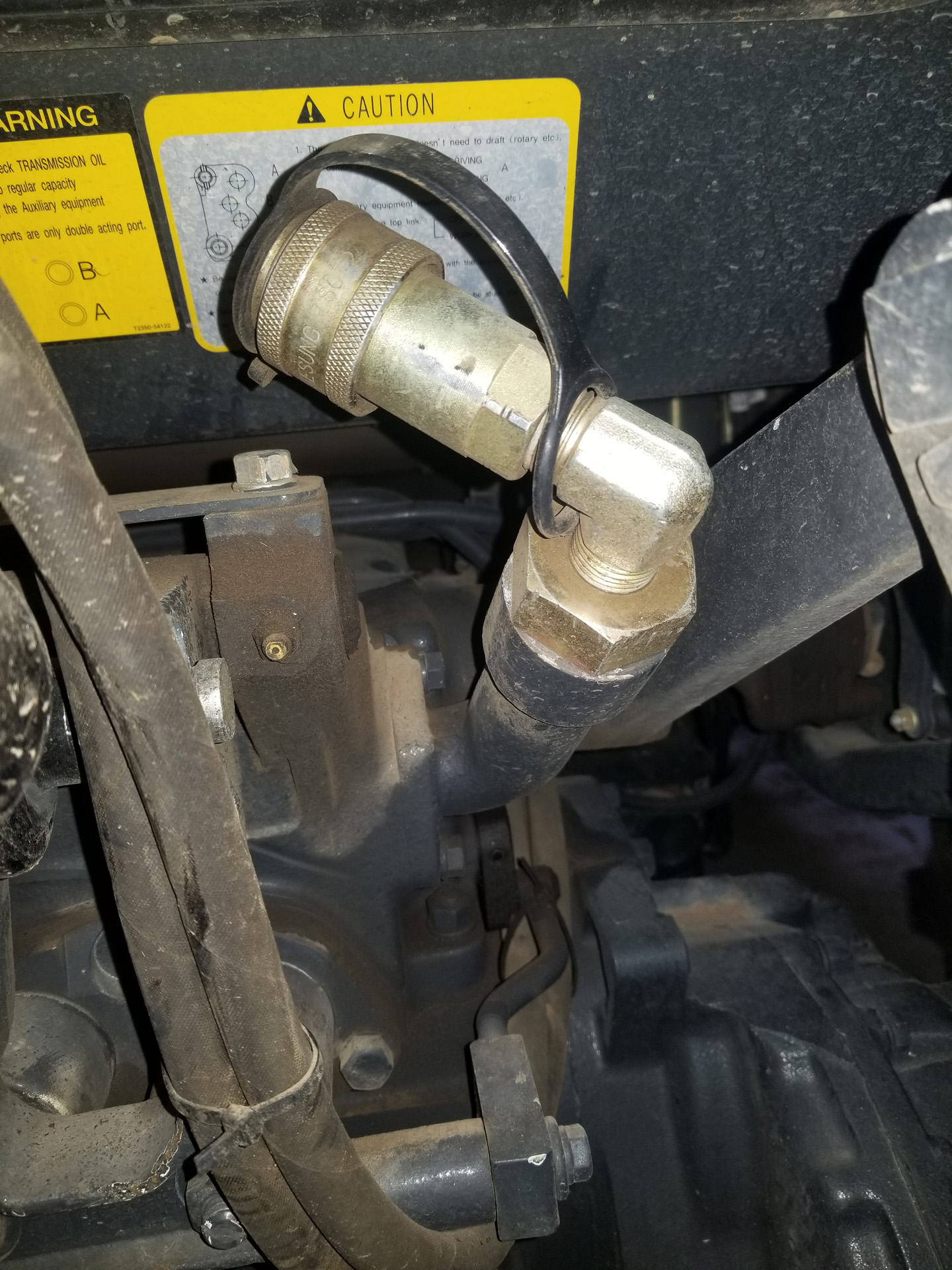

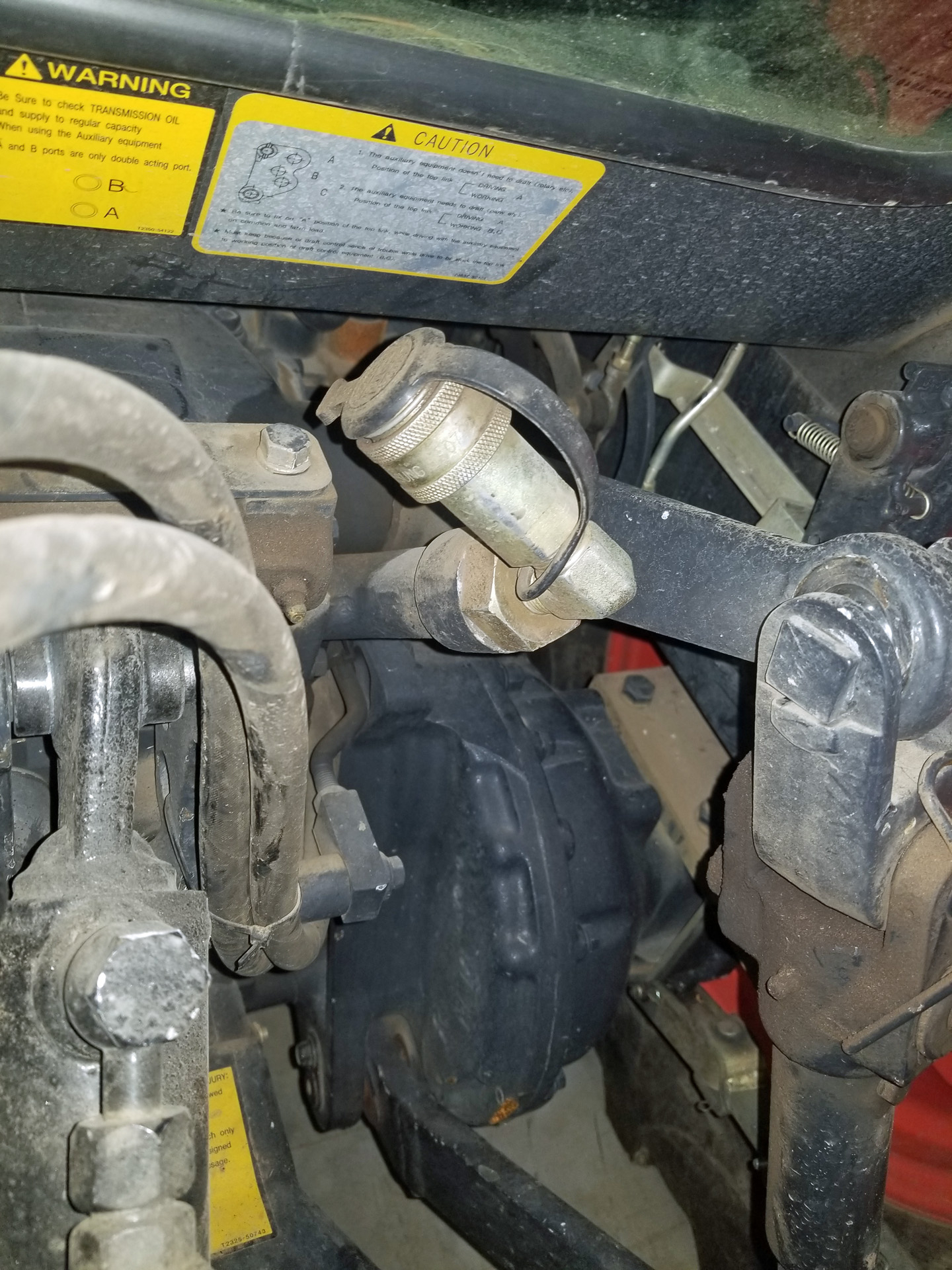

I have the speeco hydraulic down force kit on my phd. One hydraulic line goes to one rear remote, the other line dumps directly back into the hydraulic tank...the same adapter used on backhoe units. On the kioti you have to replace the hydraulic fill cap with a return line adapter. When I apply downforce, the ram extends. When I release pressure, nothing changes on ram, however as I raise 3 point the ram then retracts and dumps fluid back into tank. There is no power reverse.0520111221.jpg
   / PHD - Down Force Kit #10
I have the speeco hydraulic down force kit on my phd. One hydraulic line goes to one rear remote, the other line dumps directly back into the hydraulic tank...the same adapter used on backhoe units. On the kioti you have to replace the hydraulic fill cap with a return line adapter. When I apply downforce, the ram extends. When I release pressure, nothing changes on ram, however as I raise 3 point the ram then retracts and dumps fluid back into tank. There is no power reverse.View attachment 653651
Hi,
This sounds pretty much exactly what I need for my Kioti. Also trying to install down force kit and this zero return line stumped me big time. Would be very interested in seeing how you replaced your fill cap with a return line adapter. Thanks so much. 336Steven
