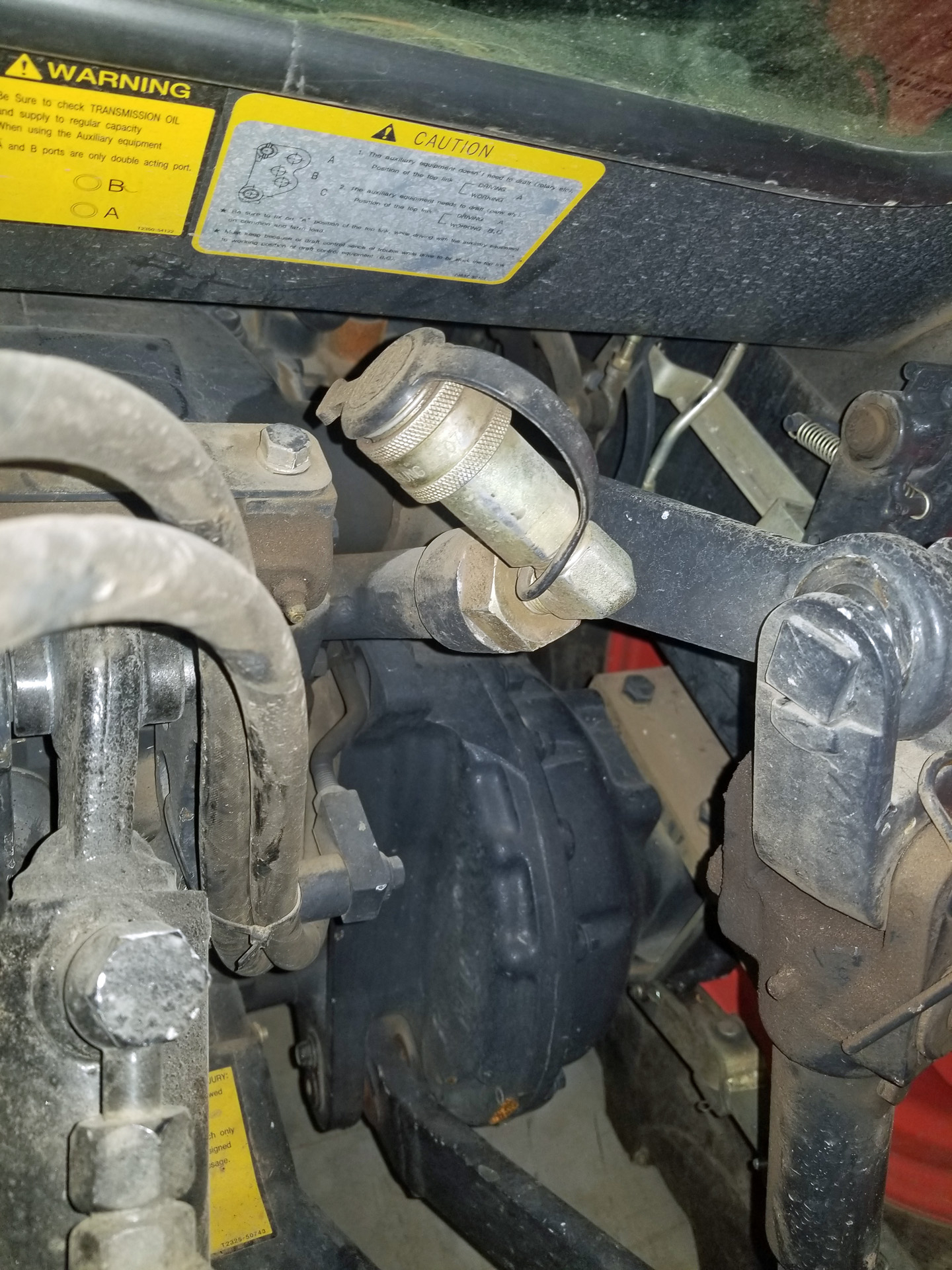

Hi,
This sounds pretty much exactly what I need for my Kioti. Also trying to install down force kit and this zero return line stumped me big time. Would be very interested in seeing how you replaced your fill cap with a return line adapter. Thanks so much. 336Steven
I’ll get a picture of it tomorrow.

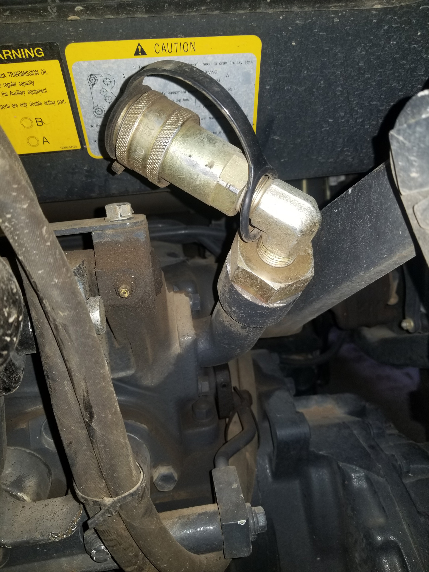

this is the piece i had to add to use hydraulic downforce kit. i got it thru my dealer. its the same kit they add if you add a backhoe...i was told. it just allows hydraulic fluid to dump back into tractor tank. it installs in place of the fluid level dip stick/fill port.
   / PHD - Down Force Kit #17
this is the piece i had to add to use hydraulic downforce kit. i got it thru my dealer. its the same kit they add if you add a backhoe...i was told. it just allows hydraulic fluid to dump back into tractor tank. it installs in place of the fluid level dip stick/fill port.View attachment 719977View attachment 719978
Thanks GRS...I will be stopping by my dealer tomorrow. This is a huge help for me as I am knew to implements with a zero return pressure. Thanks again. Steven
   / PHD - Down Force Kit #18
no problem. the adapter simply screws in. i have to remove it to do fluid change though.
