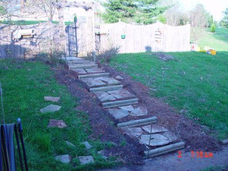

Yes it will be only a couple of hours, if that with the tractor but might take days with a shovel. I put in some steps up the slope for our pool and had to use a pick axe to break up the clay. This was before I had a 2210 otherwise I might have made 49" wide steps. /forums/images/graemlins/smirk.gif
