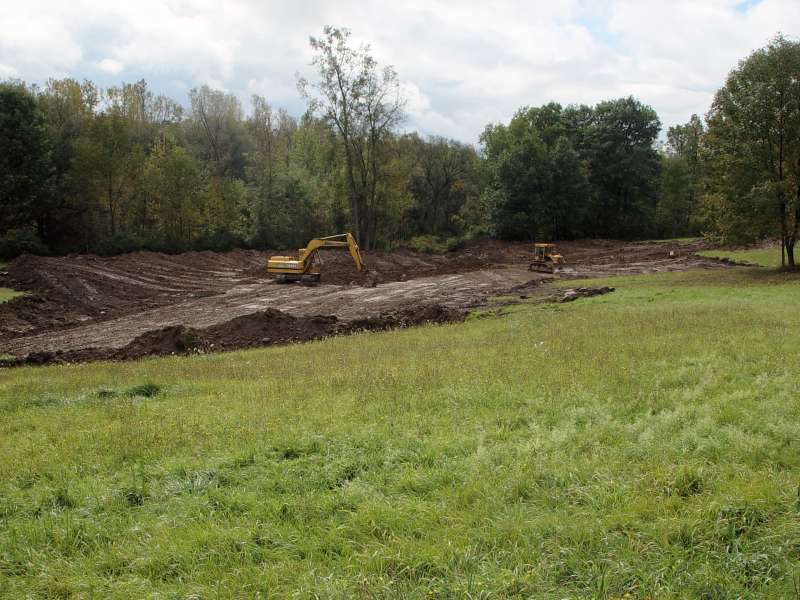

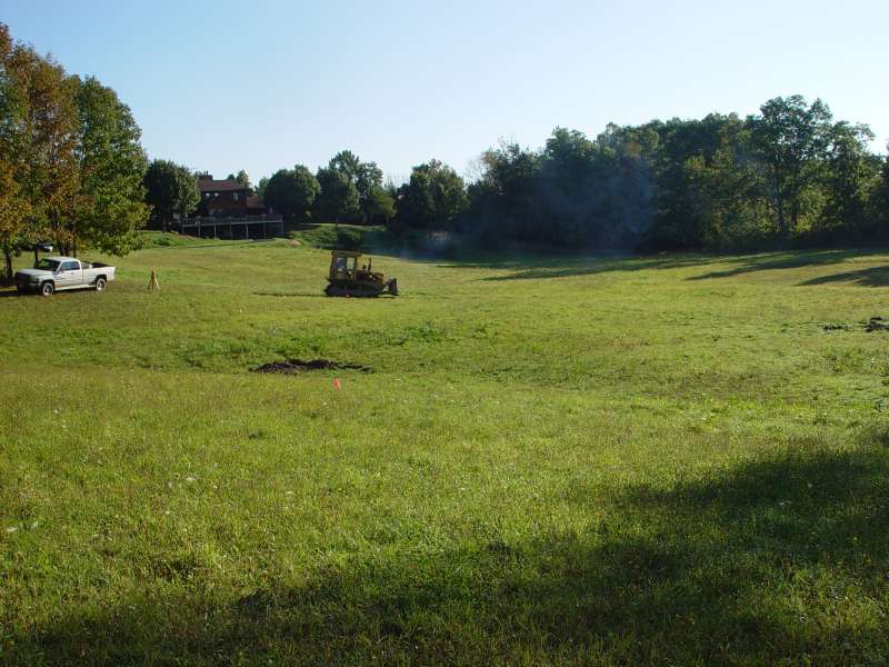

Picture #1 the site
Here is the site as well as the three test pits I dug with my backhoe down to 13 feet deep.

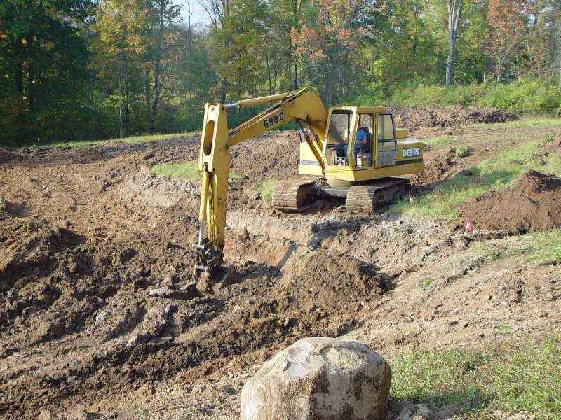

Picture 2: Dozer arrives
Pond contractor has a D6, and a Deere 690 track excavator

Picture #3: Topsoil stripped, core trench begun
Difficult to tell where the pond will be at this stage

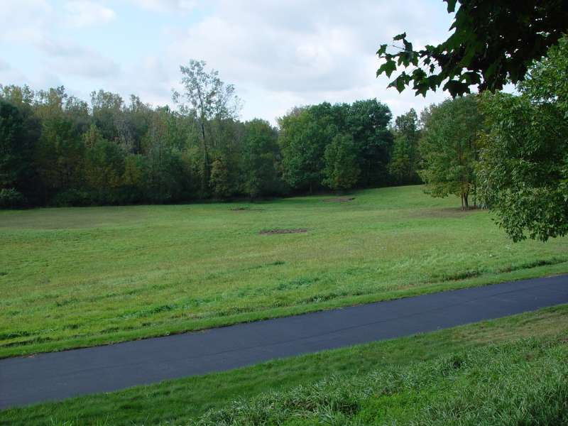

Picture #4: Another view
Looking back towards the house on the construction of the core trench

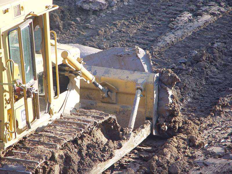

Picture #5: Initial excavation
Here is the initial excavation

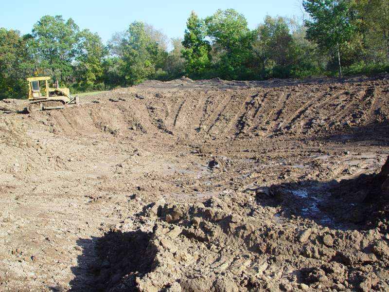

Picture #6: Pushing up the sides
Just to put things in perspective, that Cat D6 is about 10 feet tall

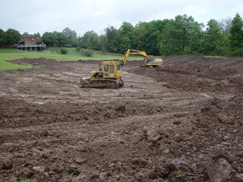

#9
Picture #8: Track Excavator at Work
The water was coming in through seems creating a slurry in some parts. The dozer got stuck a could of times. Glad we had the excavator there.

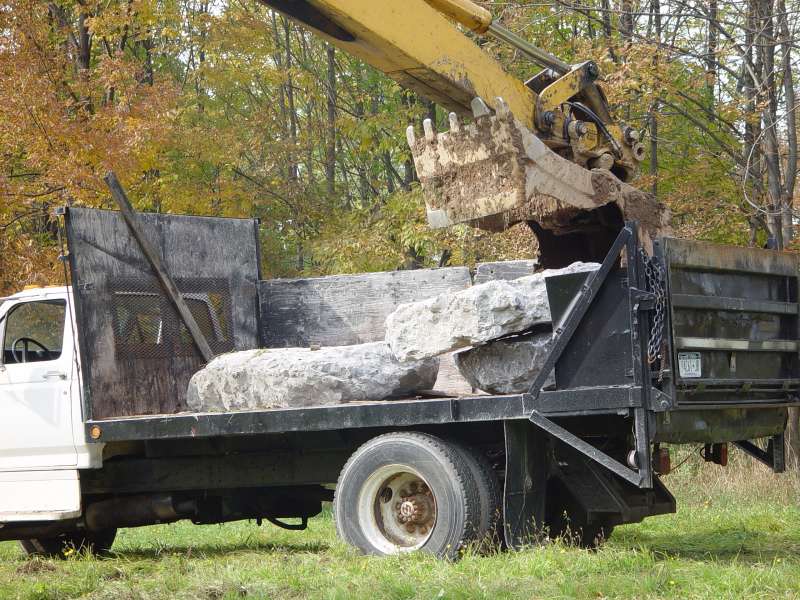

Picture #9: The Stones
Here is a picture of my truck with some of the stones that I am brining in from the local quarry to build the rock wall and waterfall. The stones range in size from 1 to 4 tons a piece. Beat the crap out of the truck. I have brought in 40 tons so far. In case you were wondering these babies are $12 per ton.
