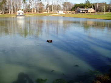

OkeeDon and Larry, when I built my pond, I used a 6 inch plastic pipe for the overflow. Then I took a 12 inch plastic pipe, and put it down over the 6 inch pipe. I put rebar through the top of the 12 inch pipe to hold it about 2 feet off of the bottom. The 12 inch pipe sticks up a few inches higher than the 6 inch pipe. The reason for doing this is two fold:
1. Apparently water on the bottom of the pond does not have much oxygen, so you want to draw that water out vs. water from the top. Pressure will push water from the bottom into the 12 inch pipe and up the sides between the two pipes and into the top of the 6 inch pipe to be drained.
2. Since the 12 inch pipe is a few inches taller than the 6 inch pipe. the 12 inch pipe acts as a screen to prevent debris, fish, turtles, etc. from entering the 6 inch pipe and clogging it. Also, in case of a major storm, water will run over the top of the 12 inch pipe into the 6 inch.
My description may be a little hard to understand, but basically you have a 6 inch pipe inside a 12 inch pipe to draw water off the bottom of the pond. I'm going to try to attach a picture that will show the larger pipe sticking up above the smaller pipe.
Took me a little while to find 12 inch plastic pipe, but finally found a company that had some. I needed a 10 foot piece. They sold it in 20 foot lengths, but had a piece that was damaged. When I went to get it, they gave it to me just to get it out of their way. Very nice people to deal with.
One caution is don't use 12 inch pipe that has double walls. Water will get between the walls, and it will be almost impossible to lift it should you ever have to remove it.

That picture did not show the pipe too well, so let me try this one. Hopefully in this one you will be able to see the rebar holding the large pipe over the smaller pipe.

What is holding your 12" pipe down? is it just held over the 6" pipe by its own weight? I understand your description of how the flow works, I like the hydrostatic method of pumping water off the bottom.
   / Photo Diary of 1/2 acre pond construction #65
Yeah, it is held down by its own weight. That 12 inch pipe is heavy. This 10 foot piece probably weighed 60 - 70 pounds.

Bob,
Nice idea! I hadn't thought of this as a way to draw water from the bottom. Wish we had exchanged 3 months ago.

Larry,
All you need to expel water from the bottom is a single pipe. The lower end should be near the bottom, the upper end should exit the pond on the maximum level you want the pond to be. When the pond gets even a little over full, it drains from the bottom up. A foot valve (usually just a cheap flapper or ball valve) can prevent water from flowing the wrong way in case of a real flood.
