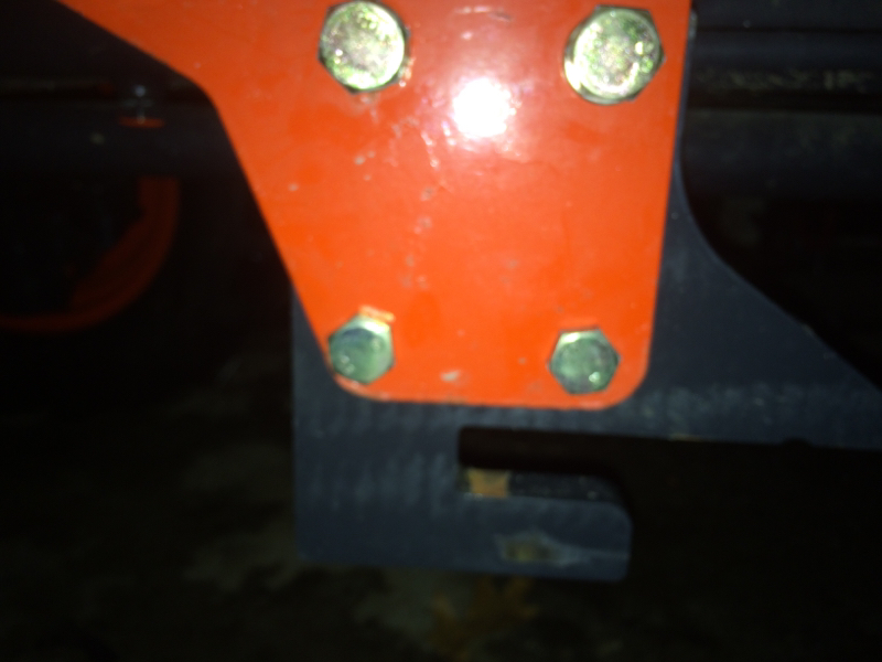

Here is a picture of one of the front mount brackets on my CK20 .the front bracket is formed from plate steel that looks to be about .875 thick , it is bolted with 4 bolts into the existing loader bracket. When installed , the slot that the subframe fits into is even with the rear mount.... KG
