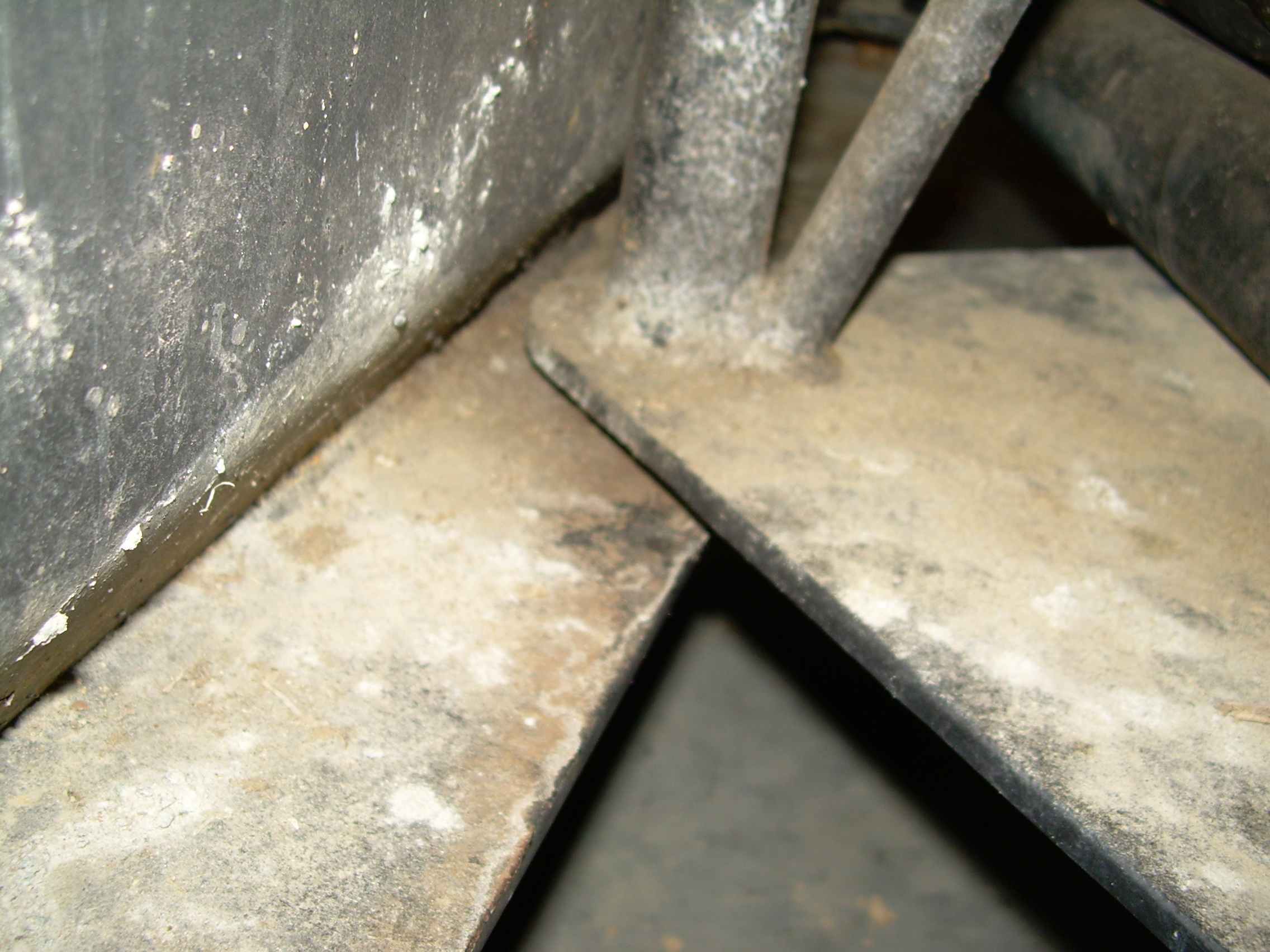

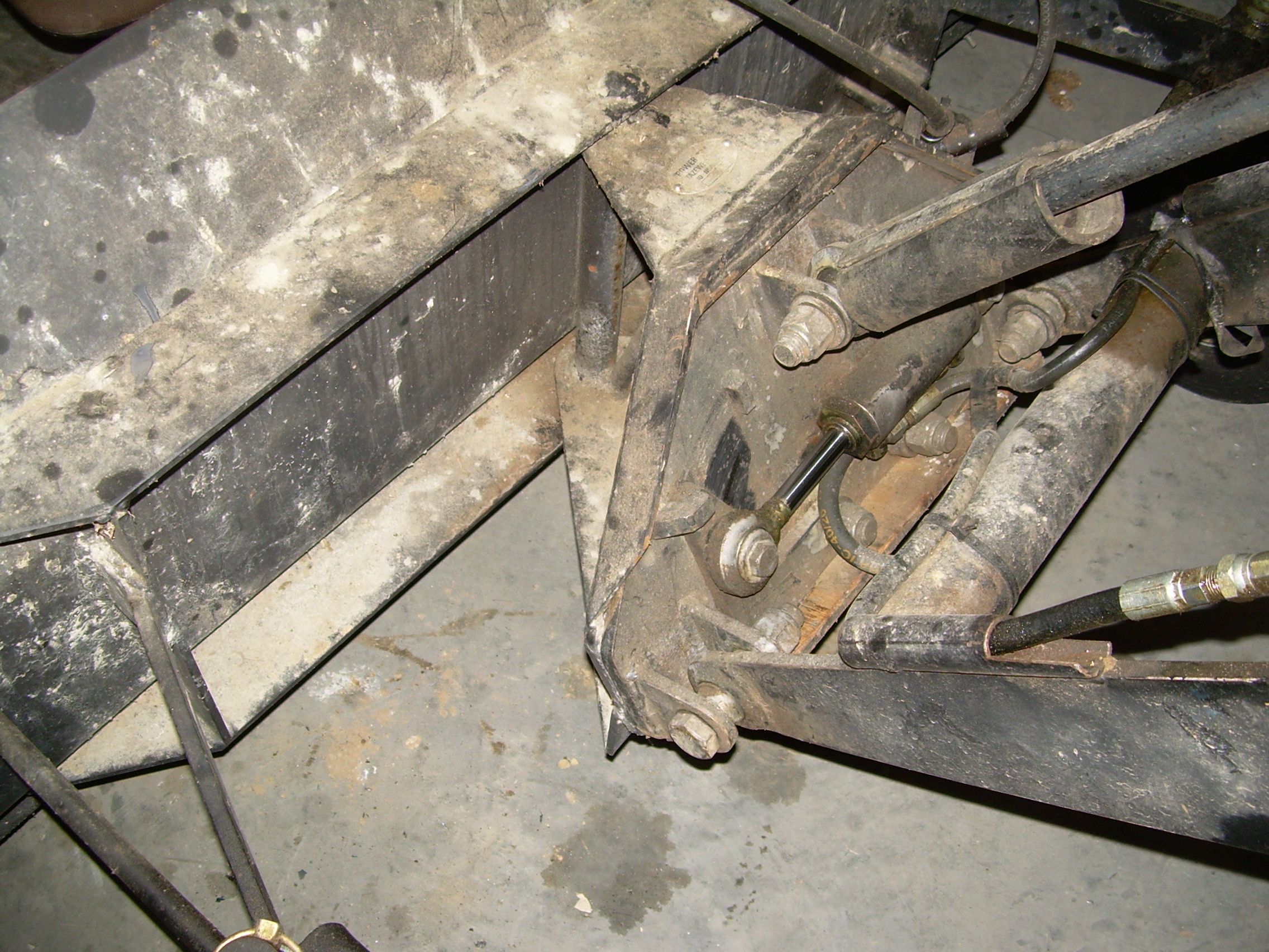

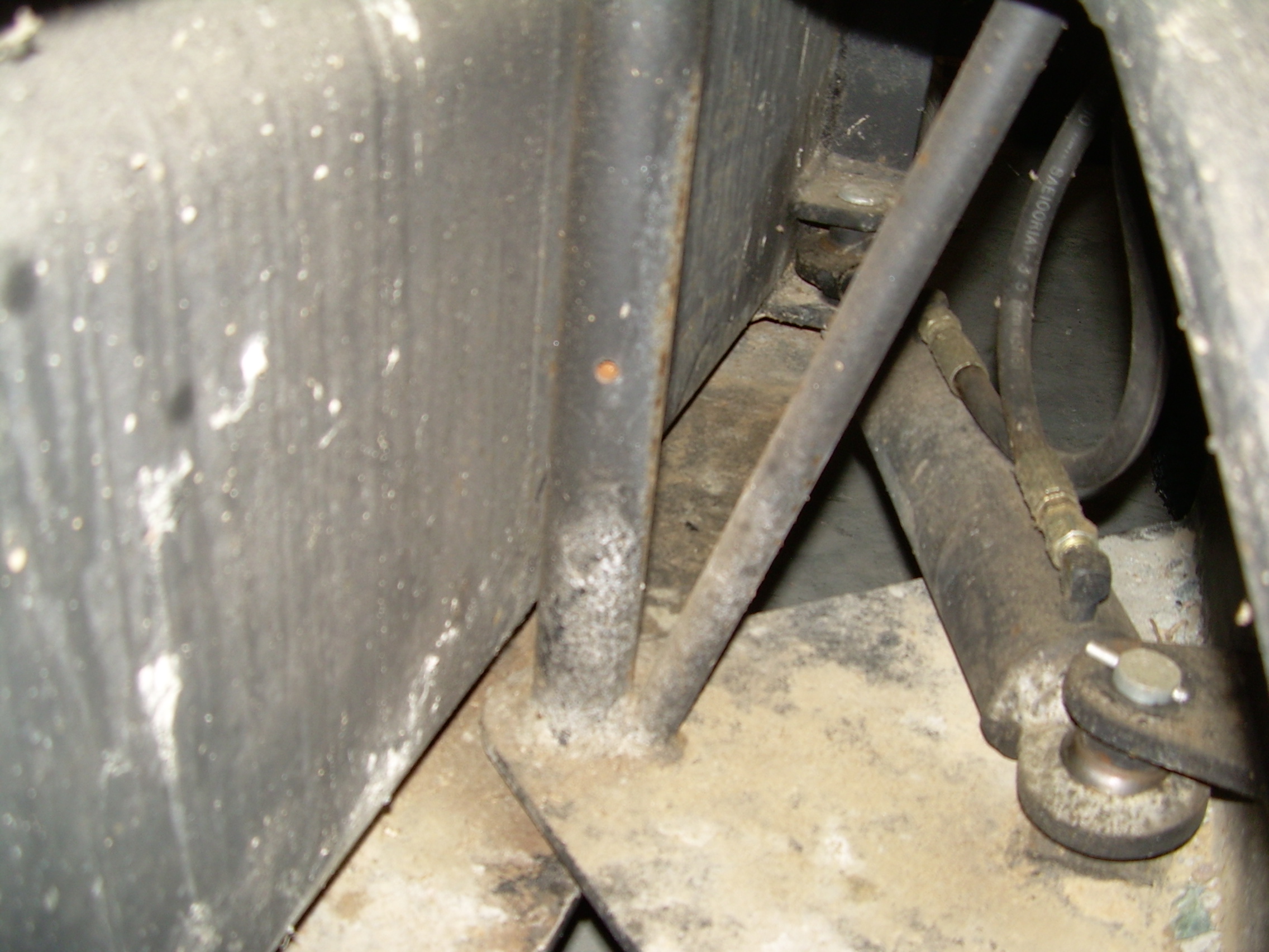

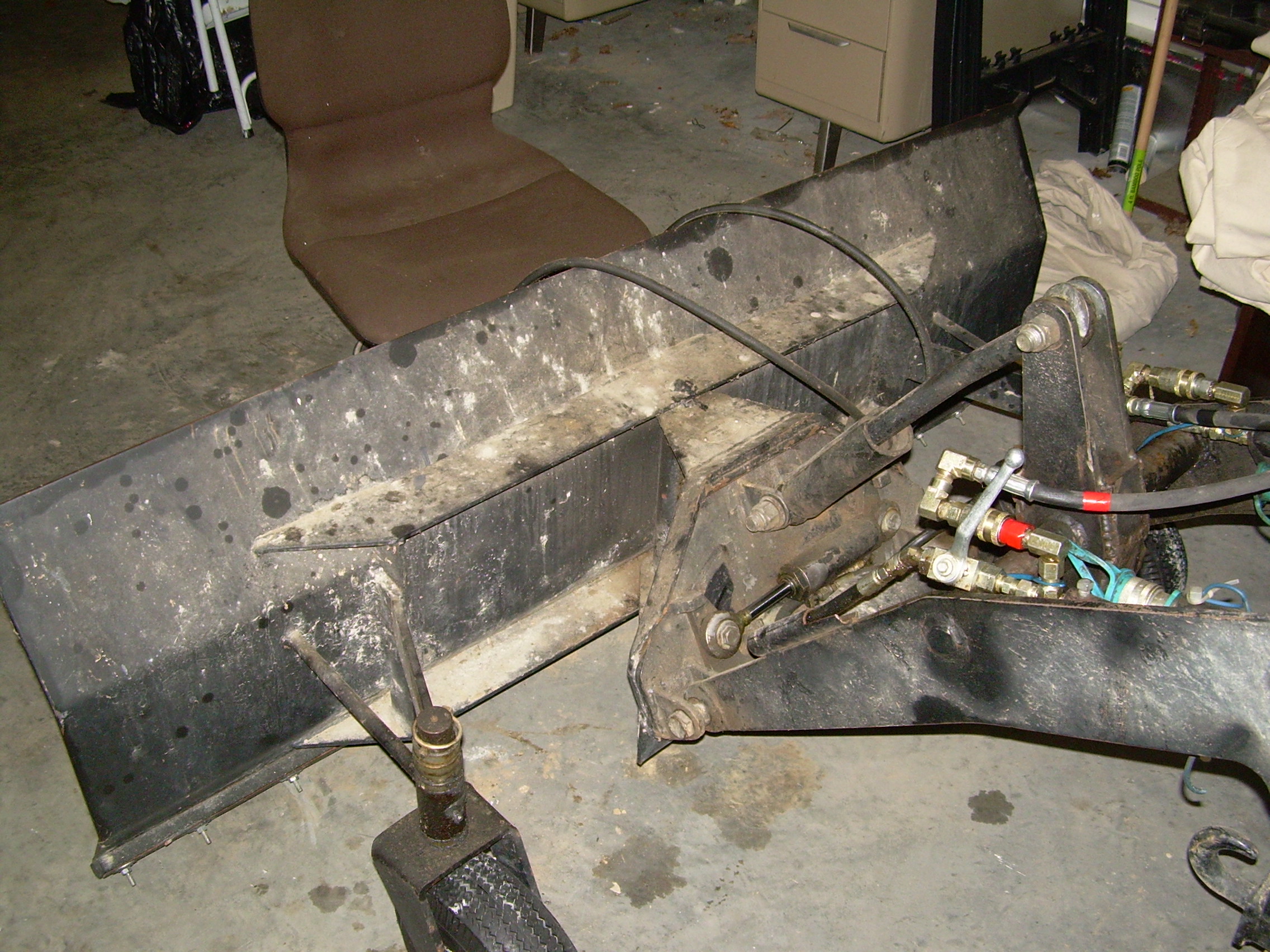

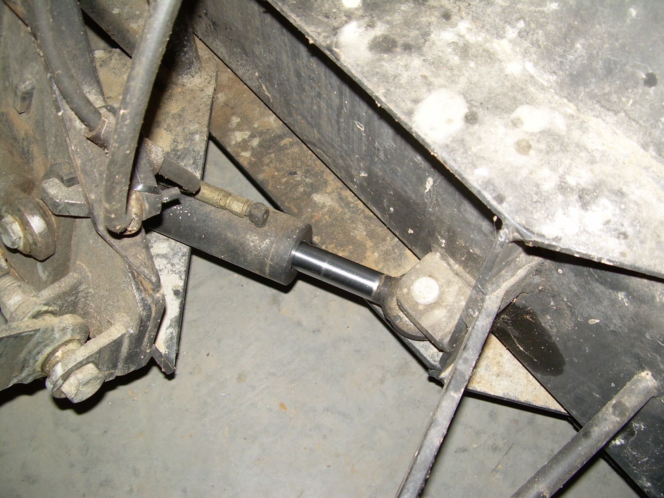

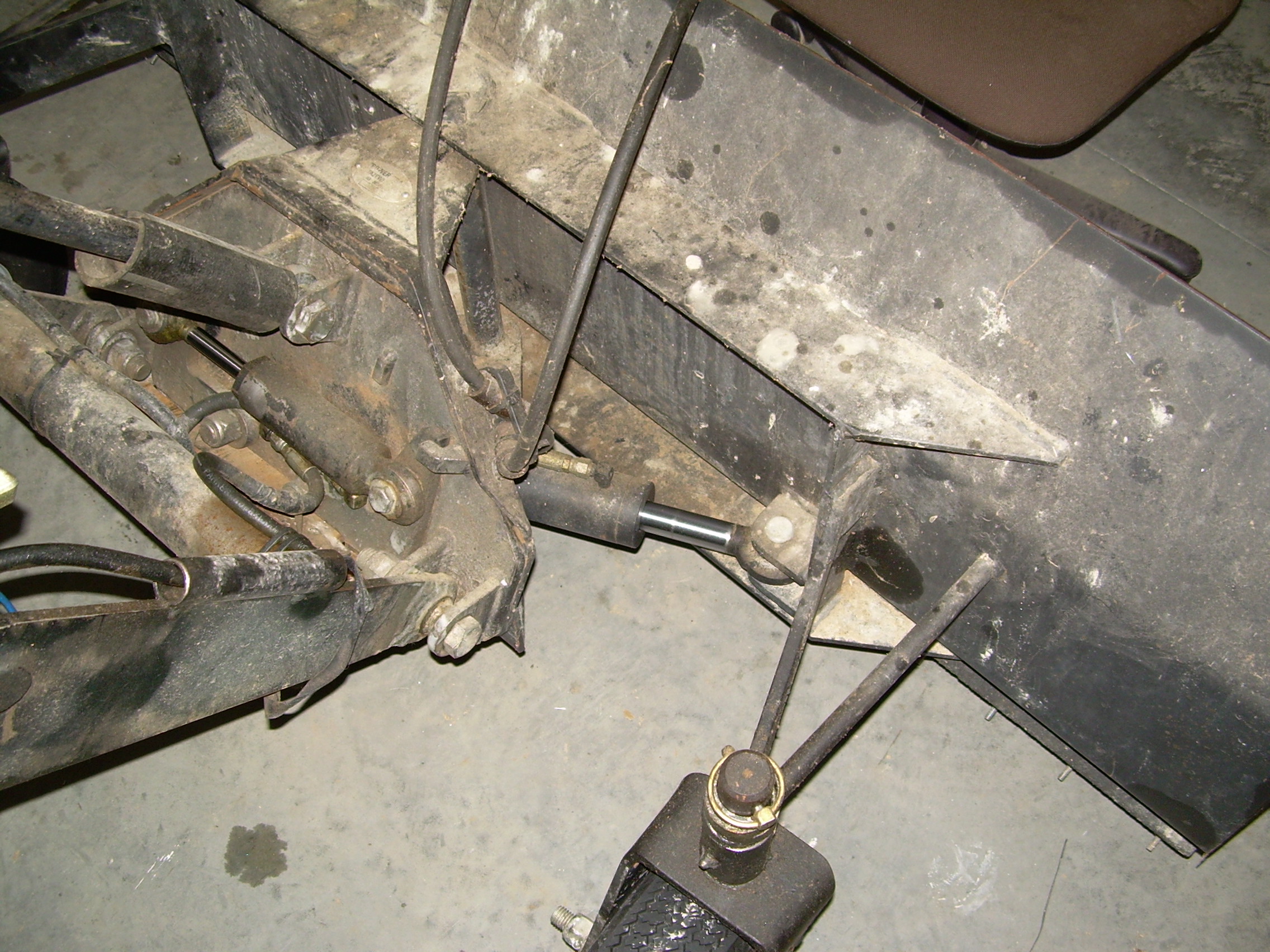

I took a few pictures. See attached. I have used the snow blade for muddy dirt smoothing going backwards. You can angle the blade left to right. Nice feature. Kinda worked ok. It is not a dozer.
Looks to me like their should be a grease fitting on that pivoting post. I don't see one, but have not really looked closely.

Your blade is quite a bit different from mine. Mine does not have the welded supports for the casters. The casters were an extra cost option that I didn't buy, so my blade has some bolt holes for the brackets. It also looks like yours has extra bracing around the pivot.

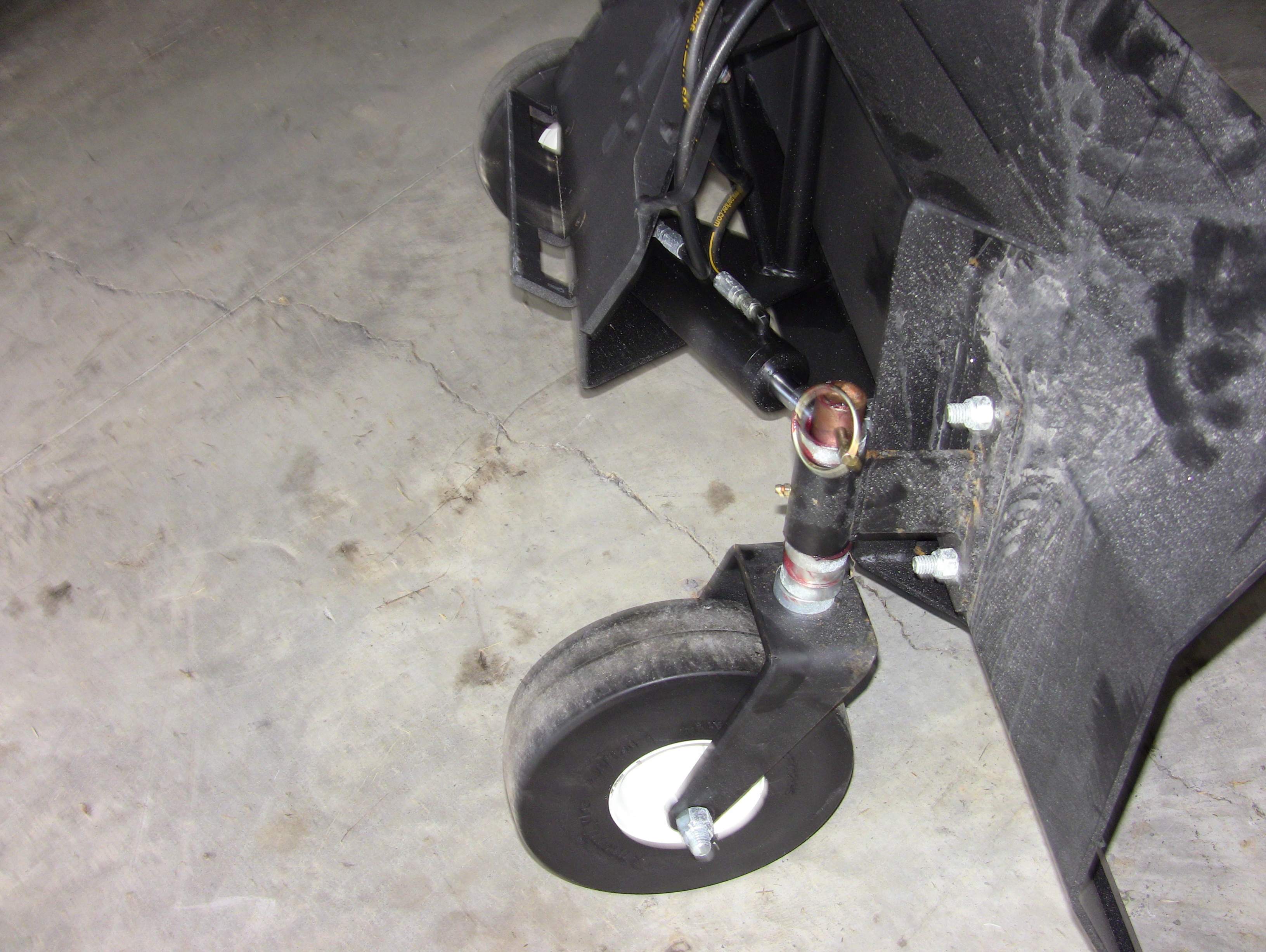

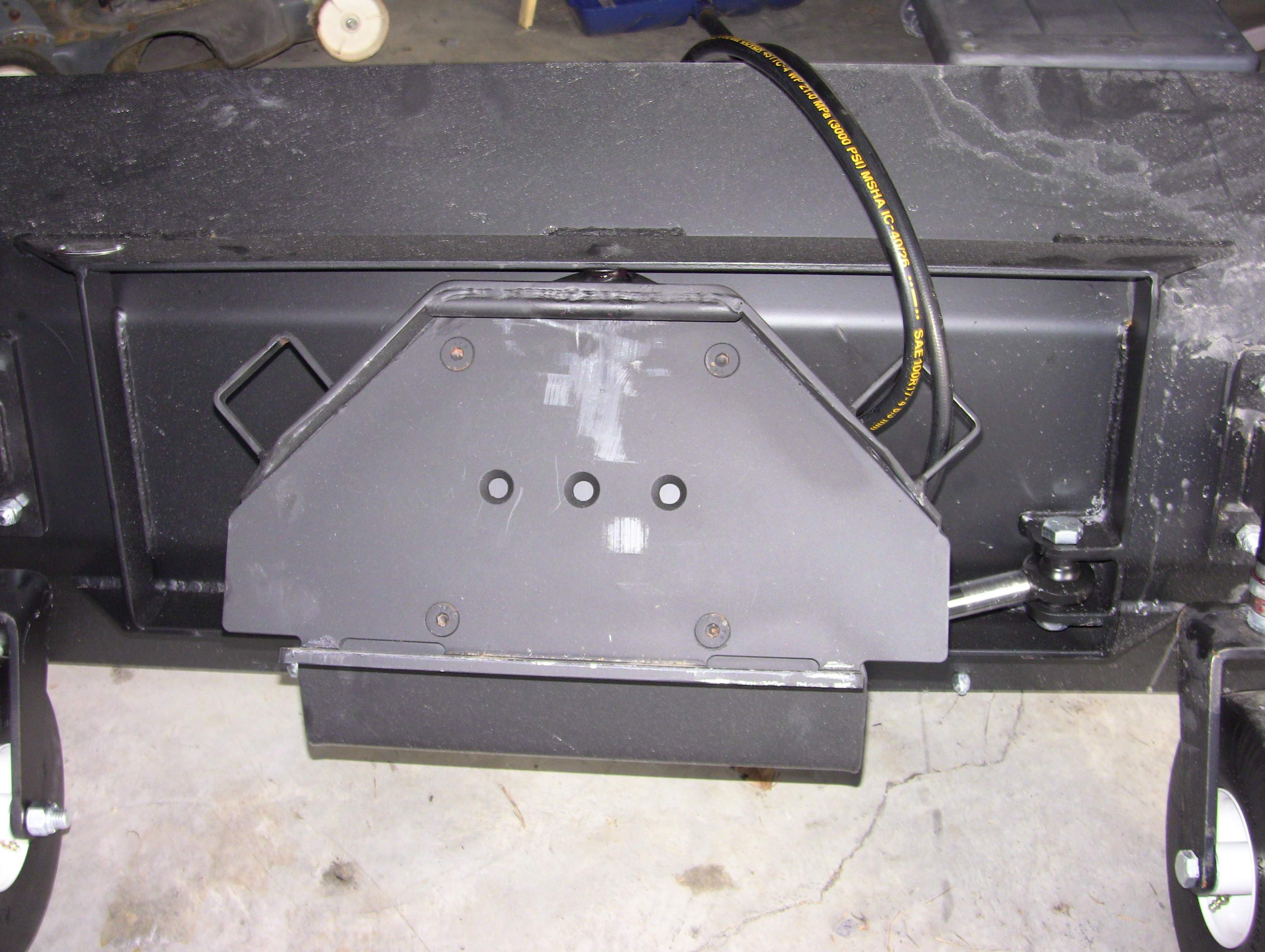

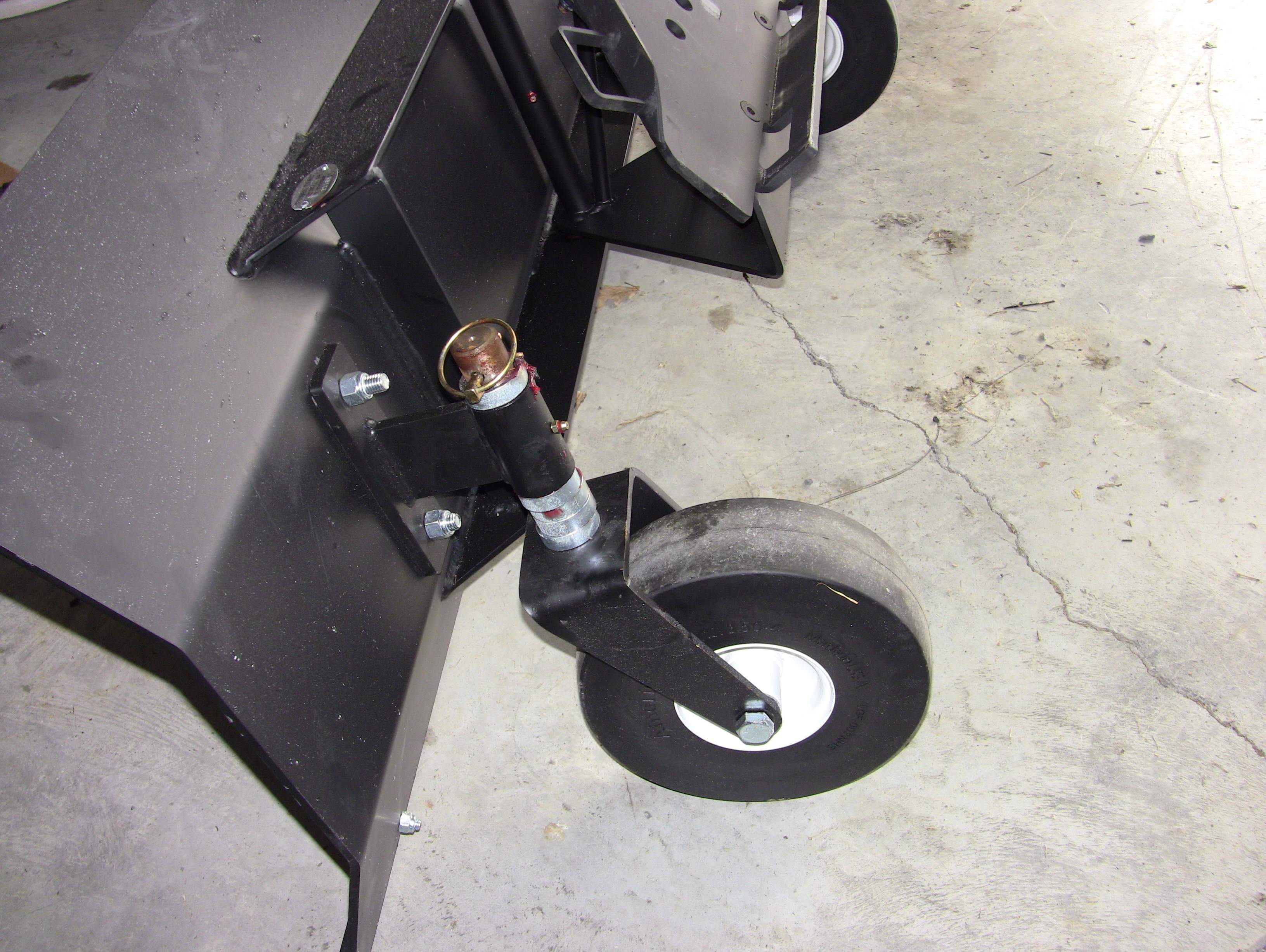

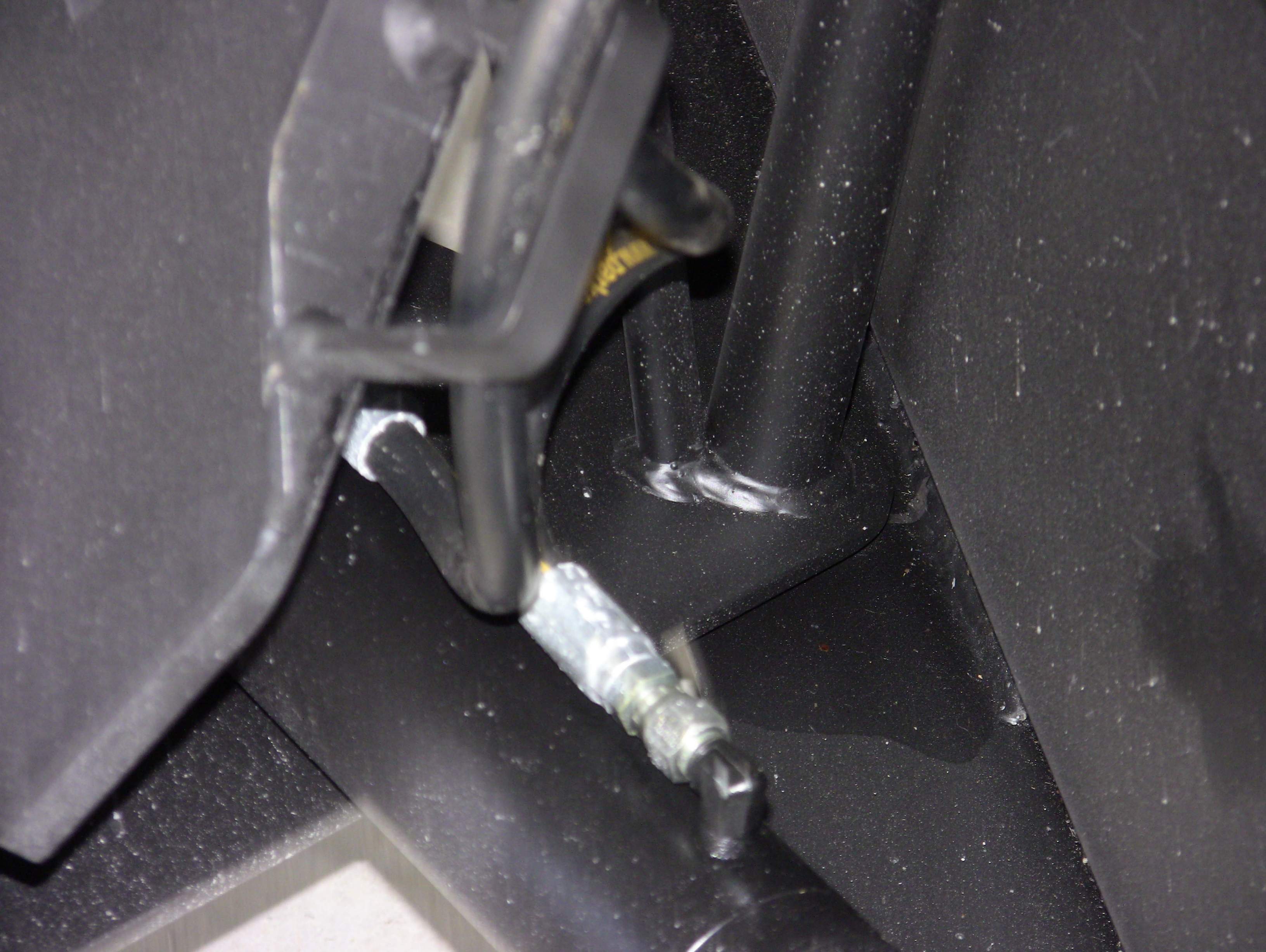

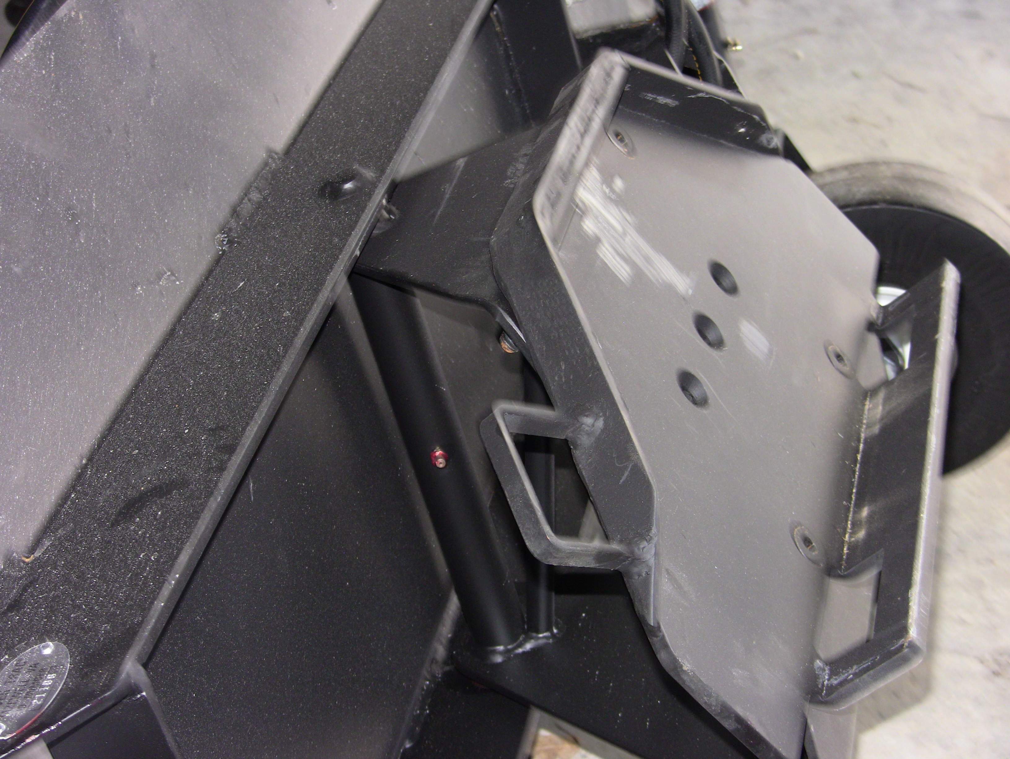

Here are photos of new PT-425 Snow Blade purchased last Dec 2010.
Note the grease nipple on the left of the pivot.
Patrick

   / Photos of PT425 Snow/Dozer Blade & Grease Question #10
Thanks for the pictures. Did you add the grease fitting?
Mine does NOT have one.
Thanks!
