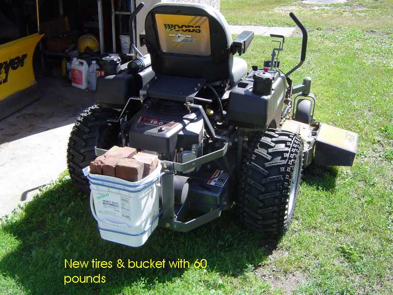

On some of the smaller ZTRs, it might be back further, due to the light decks. However, on the mowers with welded decks, the CG falls pretty far forward. I can't even pick the front of mine up ... I use a chain hoist. In addition to the mower being heavy in the front, the operator sits ahead of the rear axle. There is a bunch of weight on those front castor wheels.
Here's a picture I took several years ago, before I added any weight. 60 pounds on the back, still didn't let me lift the front!
