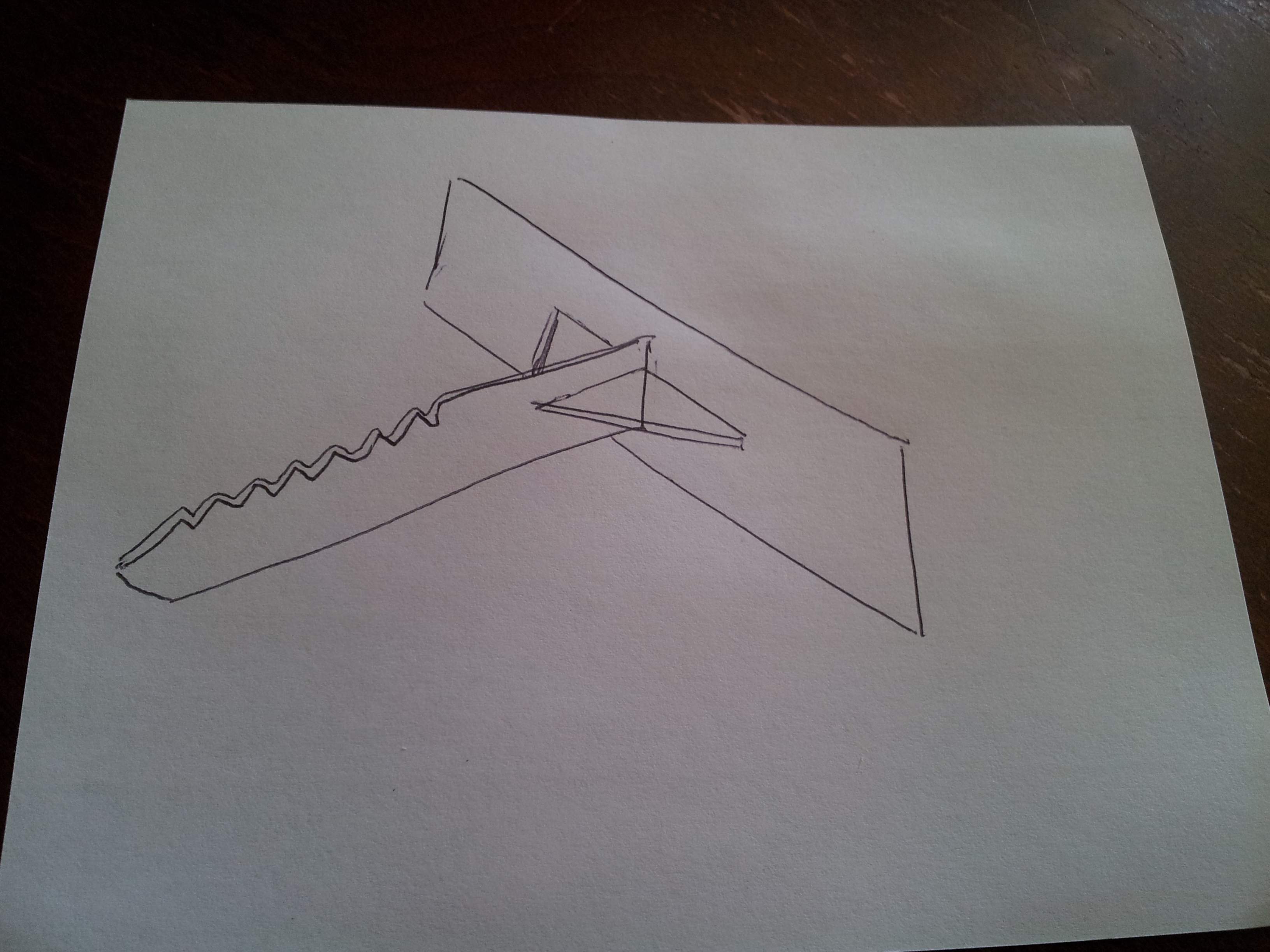

What I have thought about doing is making a specialized implement that would be a single "root-cutter" style shank, welded to the middle of a QA plate, about 36" long, with sharp teeth... that you could just go around a stump cutting the roots with, then pull it out with the bucket later.
Anyone seen one before? Maybe we should make one and start selling them?

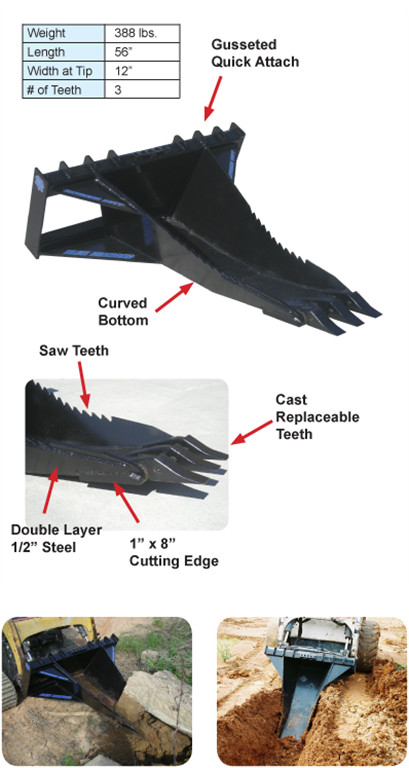

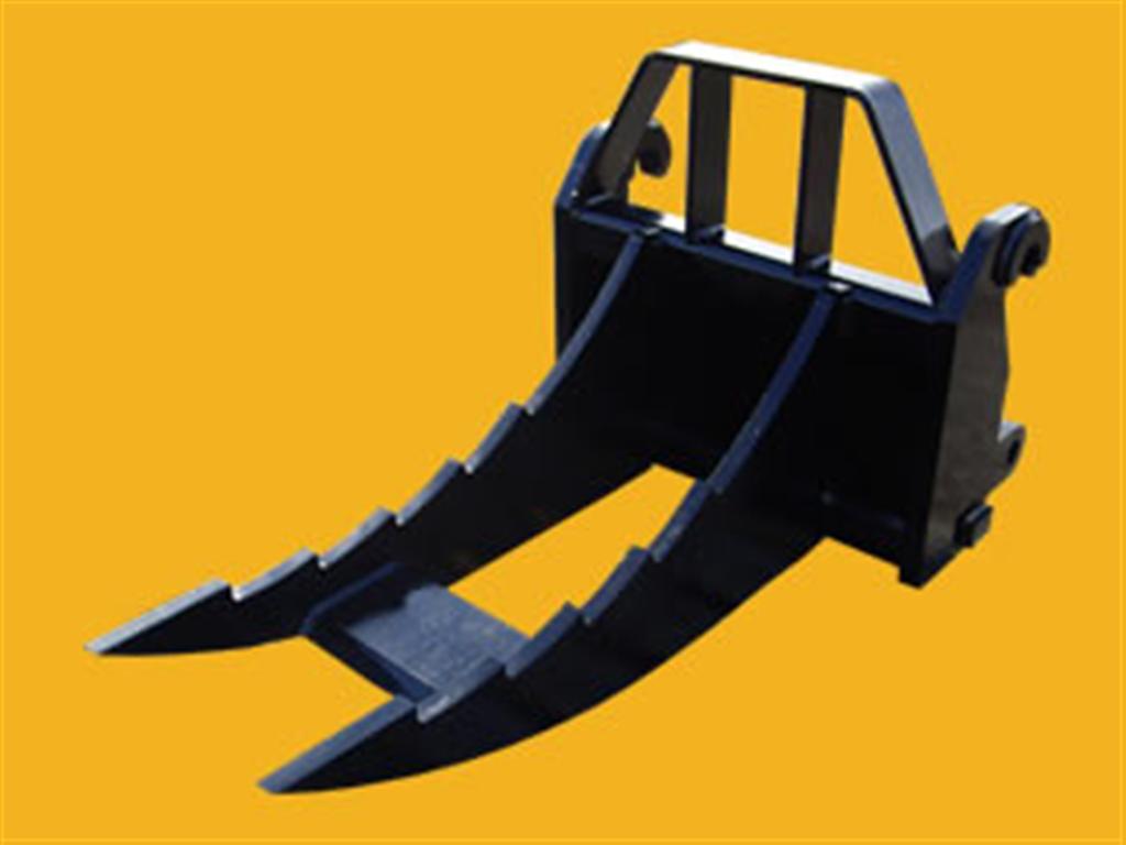

I have seen some with double tines.
ANBO makes this one.
I have seen a yellow one, but can't find it now.
My stump bucket has cutting teeth on it, sure helps on big roots.

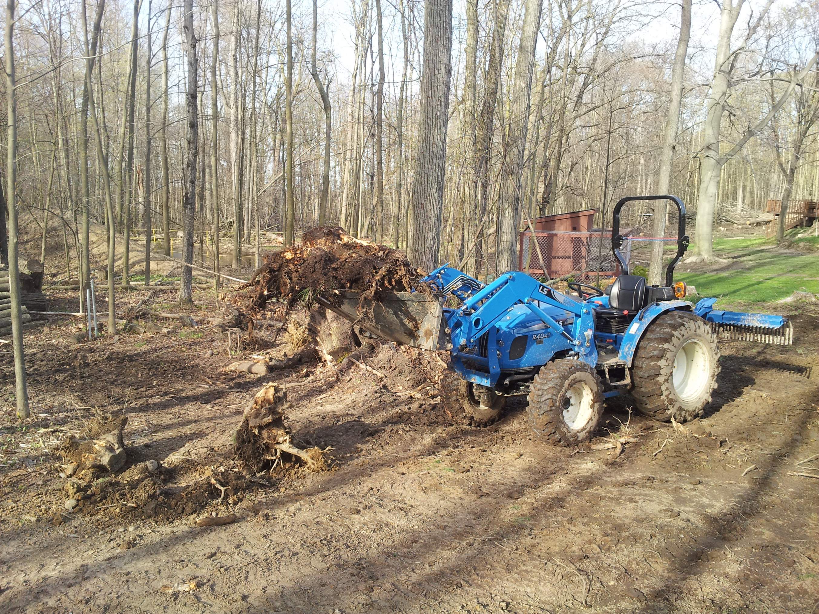

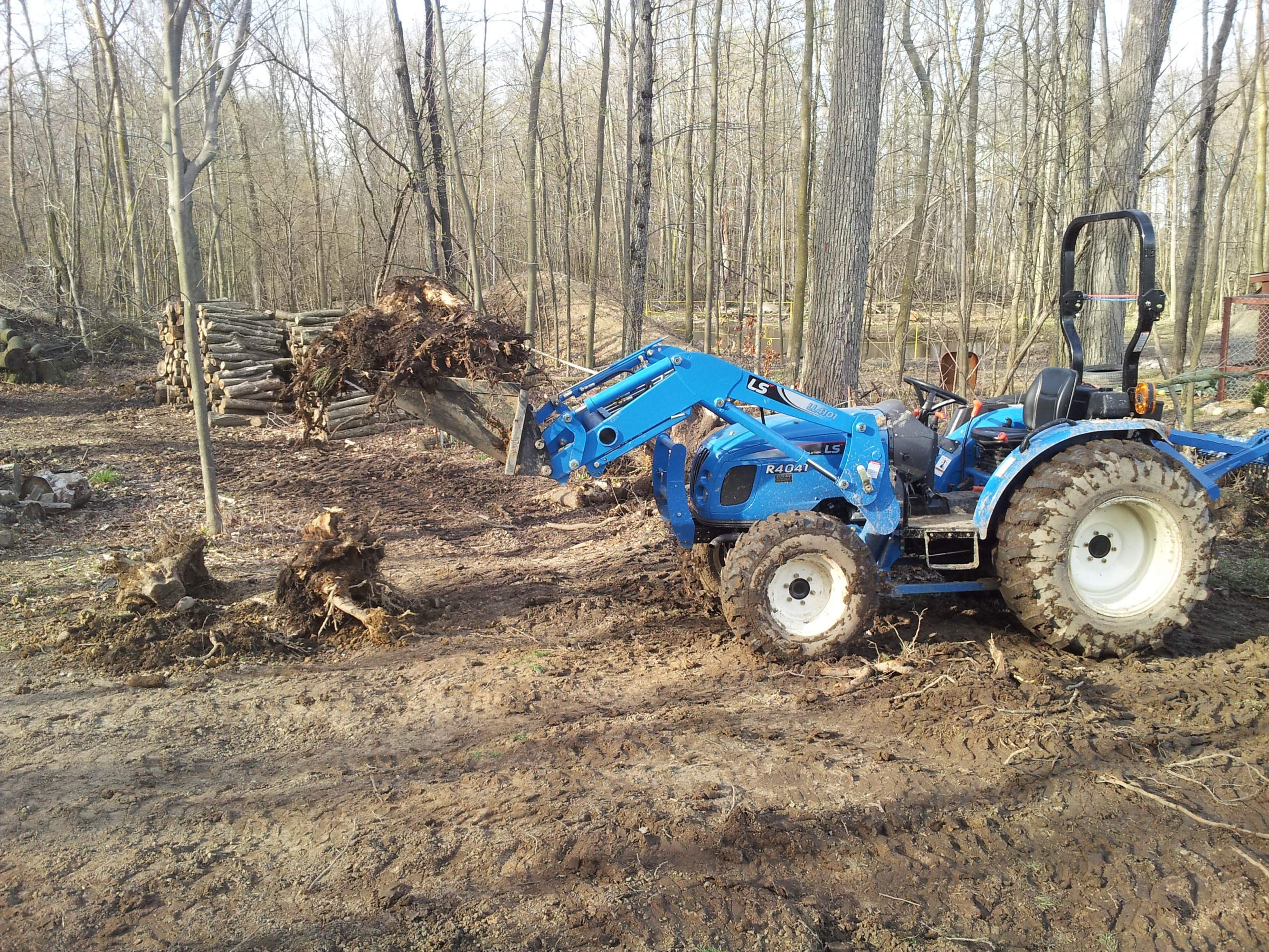

OK... well, decided to do 3 more stumps to finish an area before the day closed. In the first pic, you can see the remaining 3 in this area, all of which were Oak or Maple, which I had cut down last year. The 2 on the sides were maybe 8" diameter, and the middle one was my biggest attempt yet, approx 13".

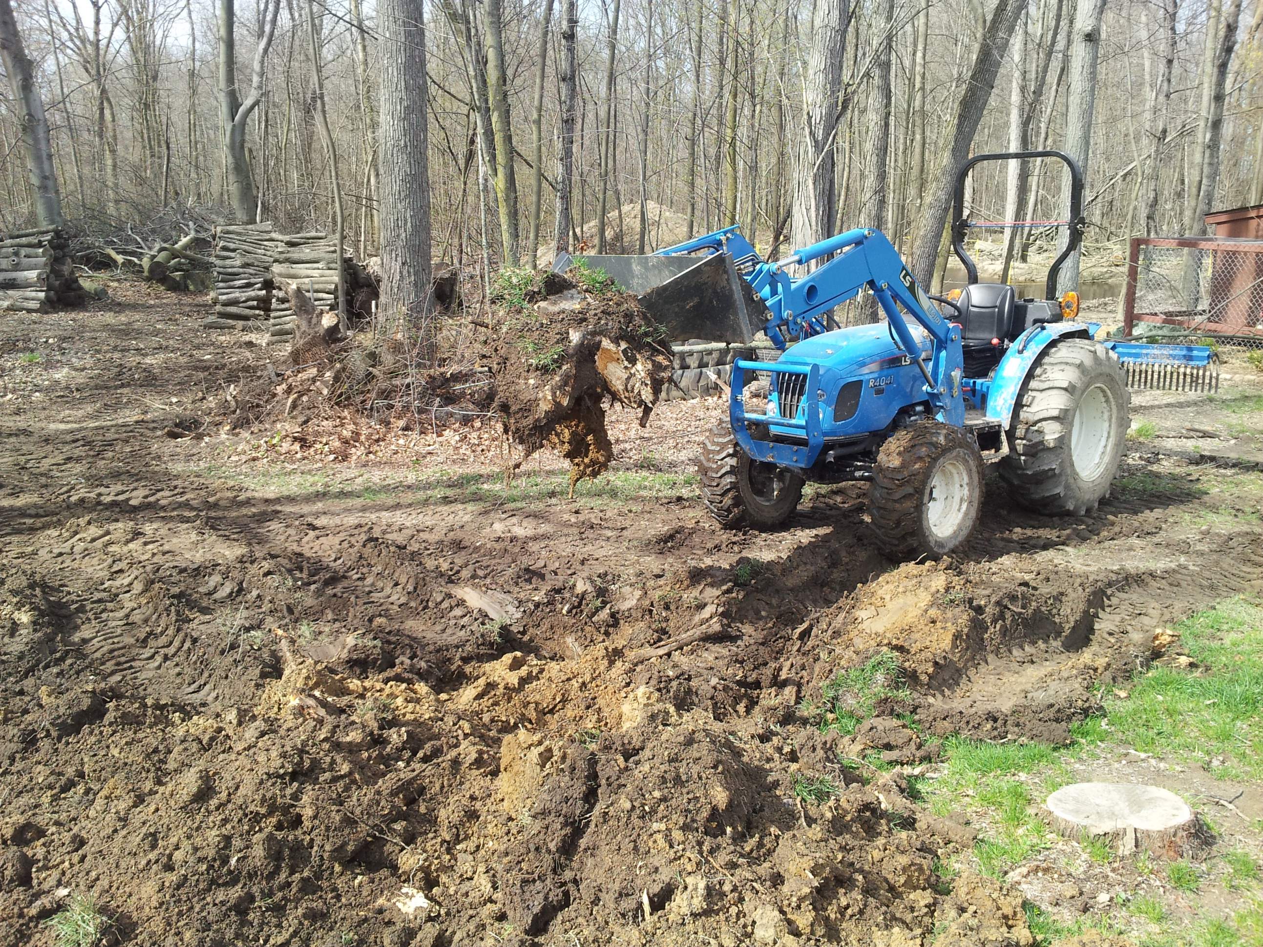

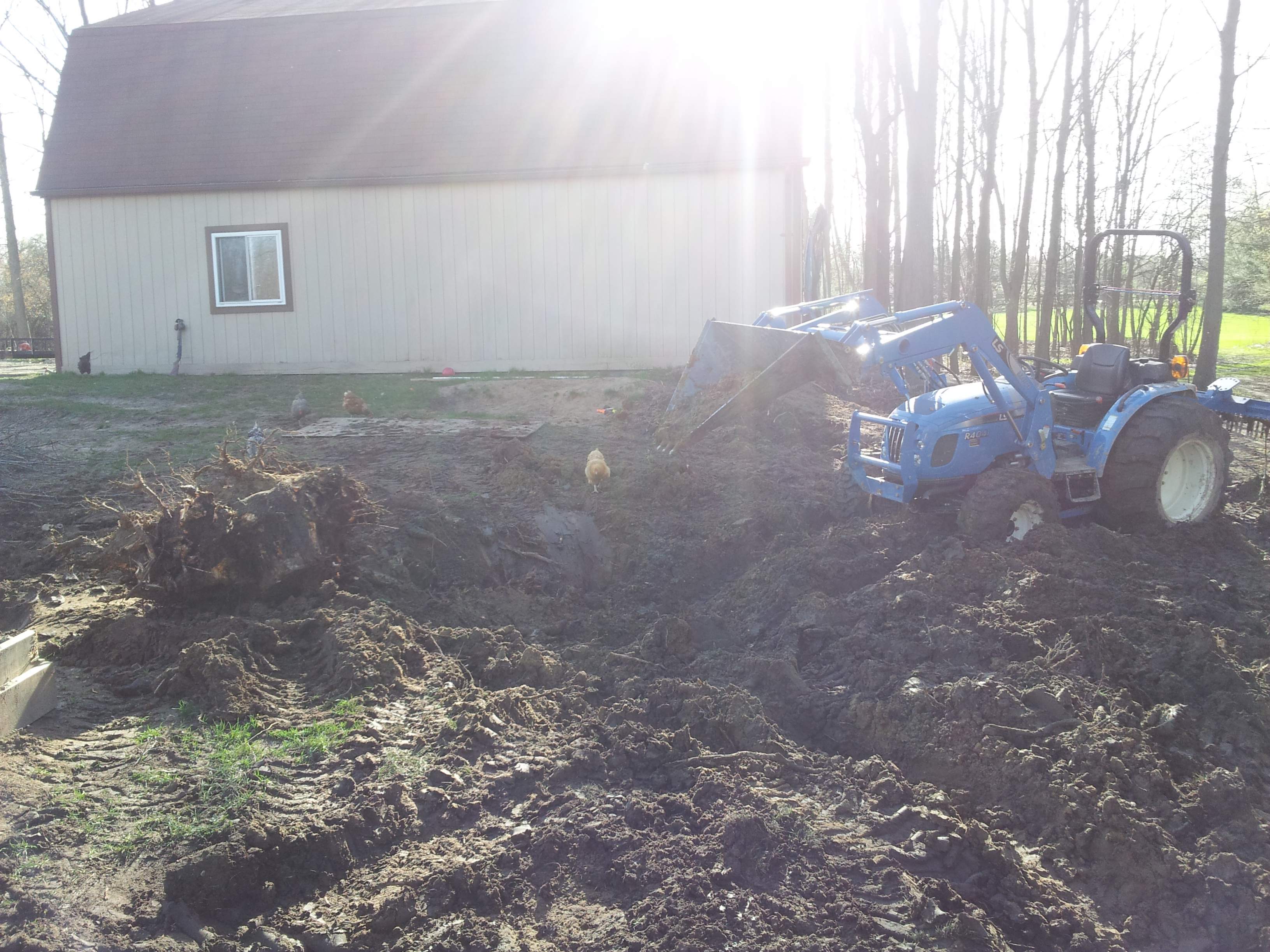

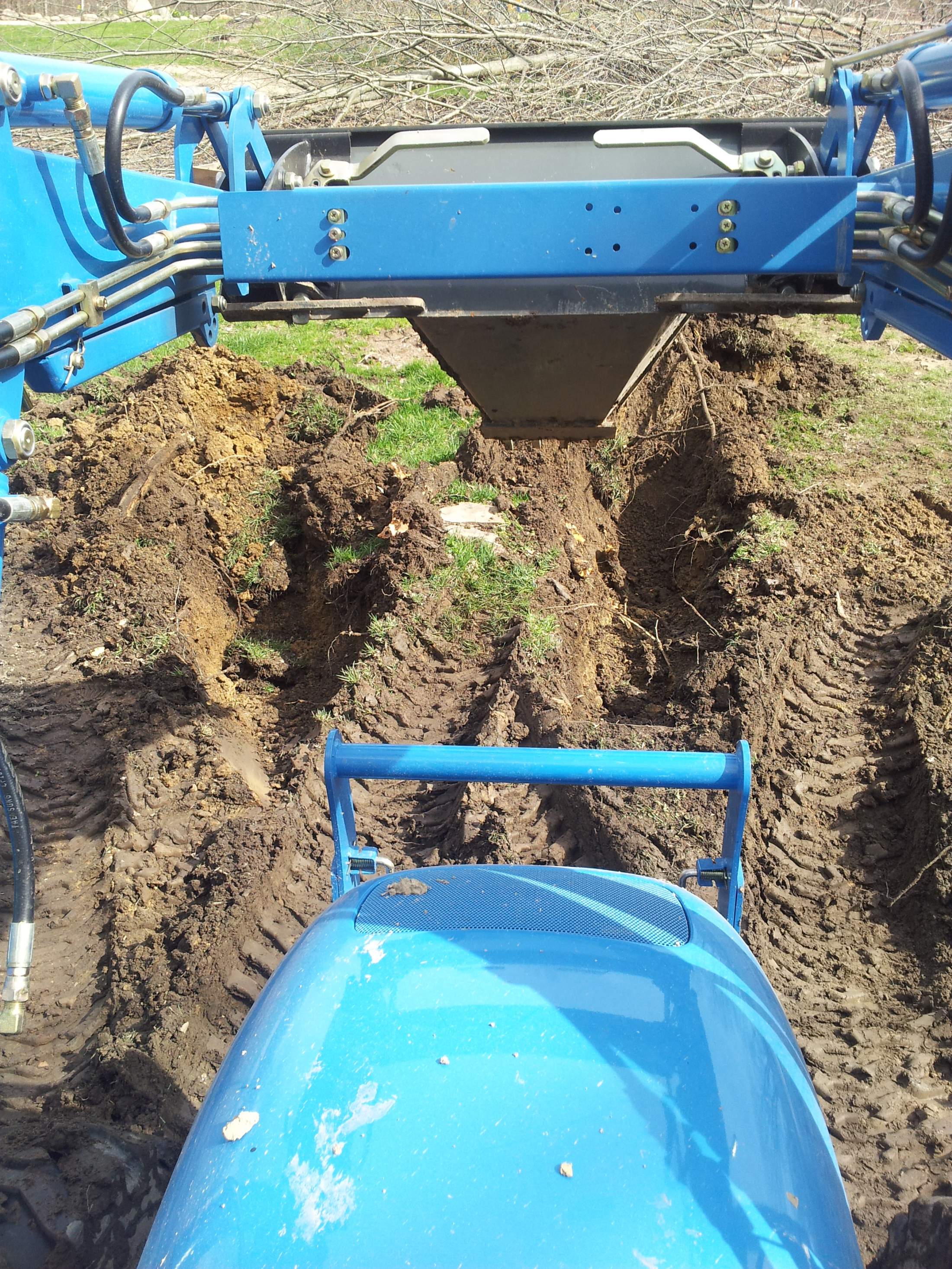

Okay, so I got started on the first one, and within 5 minutes I had it out... not bad. You can see the process in this pic, where I start with a couple passes on either side (Basically this thing is a short-fat reverse backhoe).

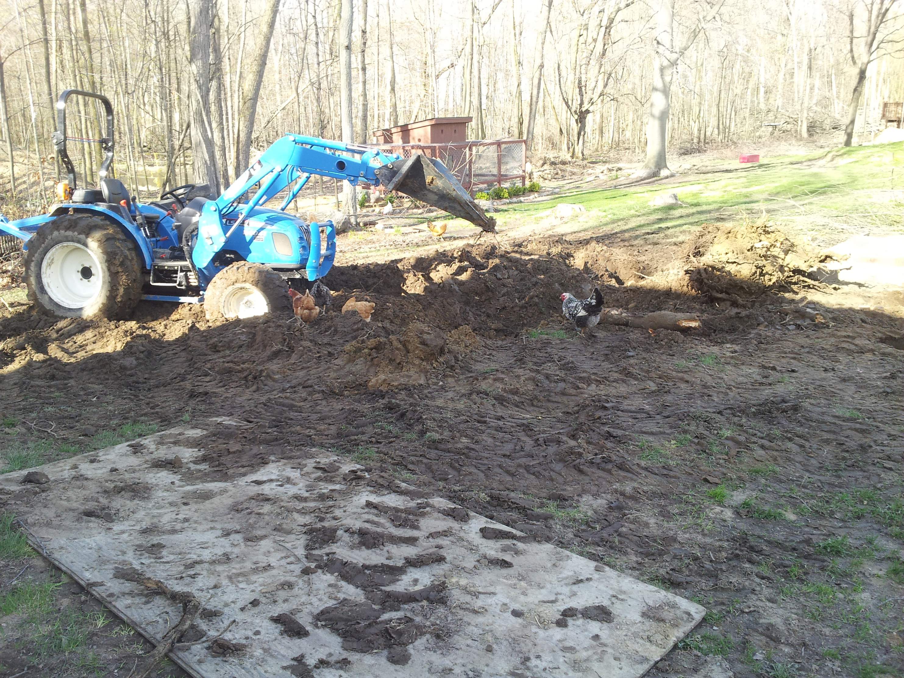

The 2nd one probably took another 10 mins or so, and I was feeling pretty cocky. Then onto the 3rd one. Wow... If it wasn't for sheer stupidity and stubborness, I would've given up after the first 30 mins. But, I kept up with it and after roughly 75 mins, finally got the GD thing out! Because of my stupid Shuttle-Shift (yeah, at the moment I'm regretting getting this over the HST) my left foot & knee are throbbing, and my left shoulder ain't feeling all that hot either. Could barely lift the thing up because it's so packed full of moist clay, but finally got it up in the bucket.

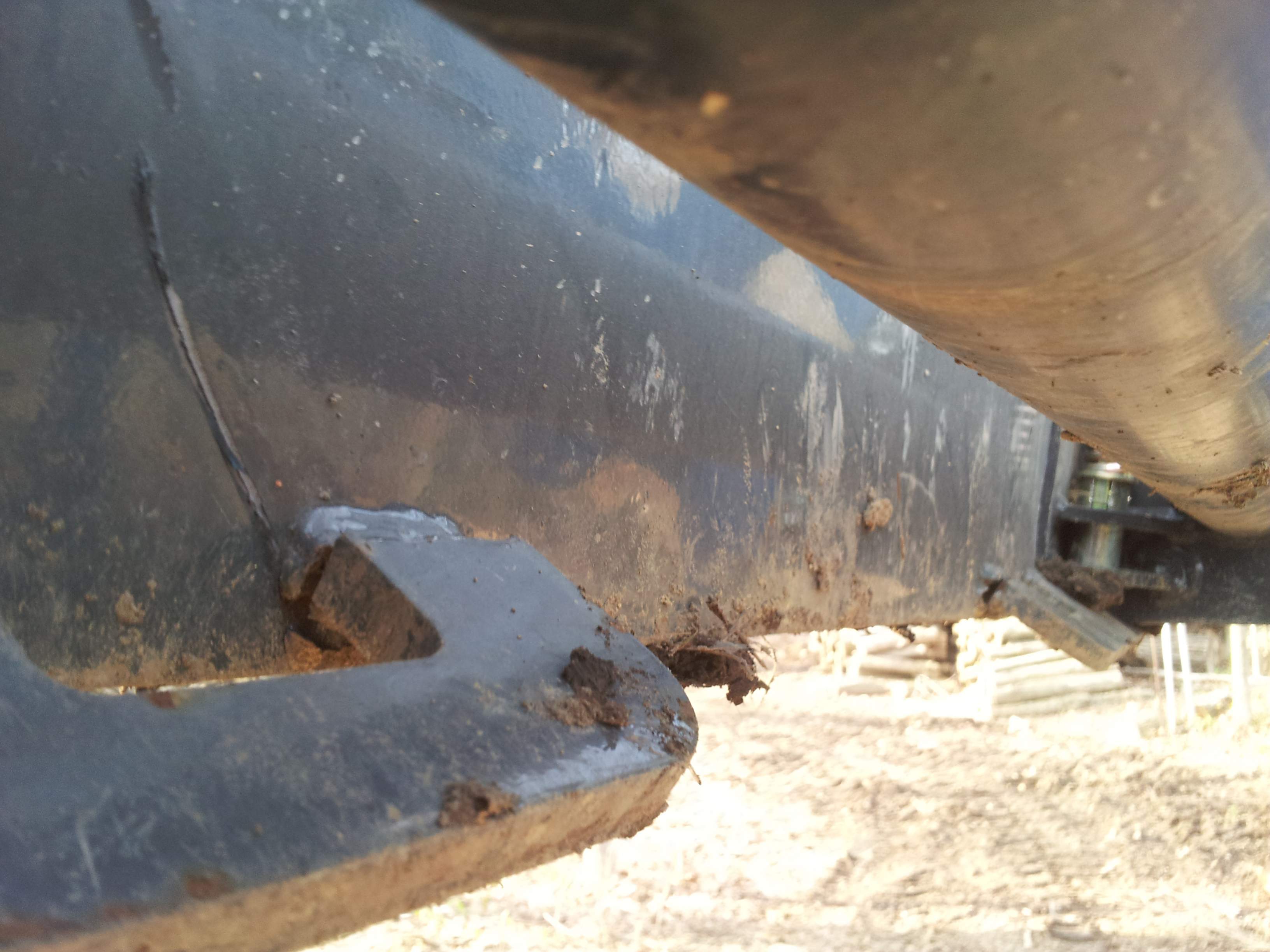

In the process, I found the weak points of the bucket construction, which I'm gonna have to take somewhere to get fixed... should just need a few new welds, maybe something to reinforce it to prevent future damage. Basically, the inner portions of the lower QA mounting points broke off the bucket.

2: the broken "weld" was never welded in the first place.. classic example of a pretty MIG weld. that never was.. Absolutely no penetration into the parent metal, just a pretty bead laid next to it. When I see these, it makes me glad I have a nice cheap Chinese stick welder. I know great welds can be made with a MIG welder, but this is not the first factory "weld" I have seen that had no penetration because the operator was not running it hot enough to tie in to the parent metal.
rant off.. I wish you had bought the hydro. and the broken weld will be easy to fix. And my observation is you are getting better with the bucket with every stump you take out.!:thumbsup:
