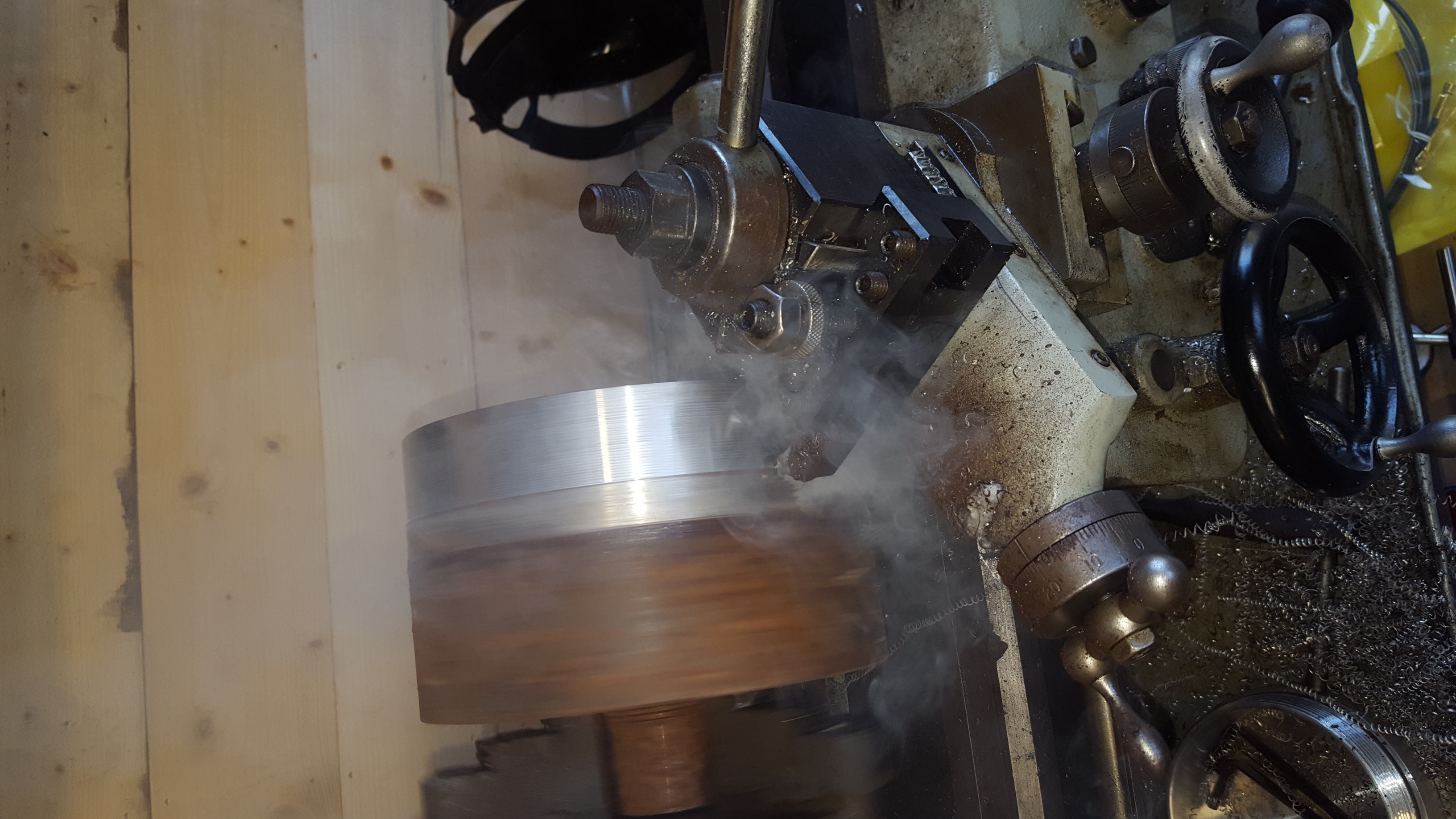

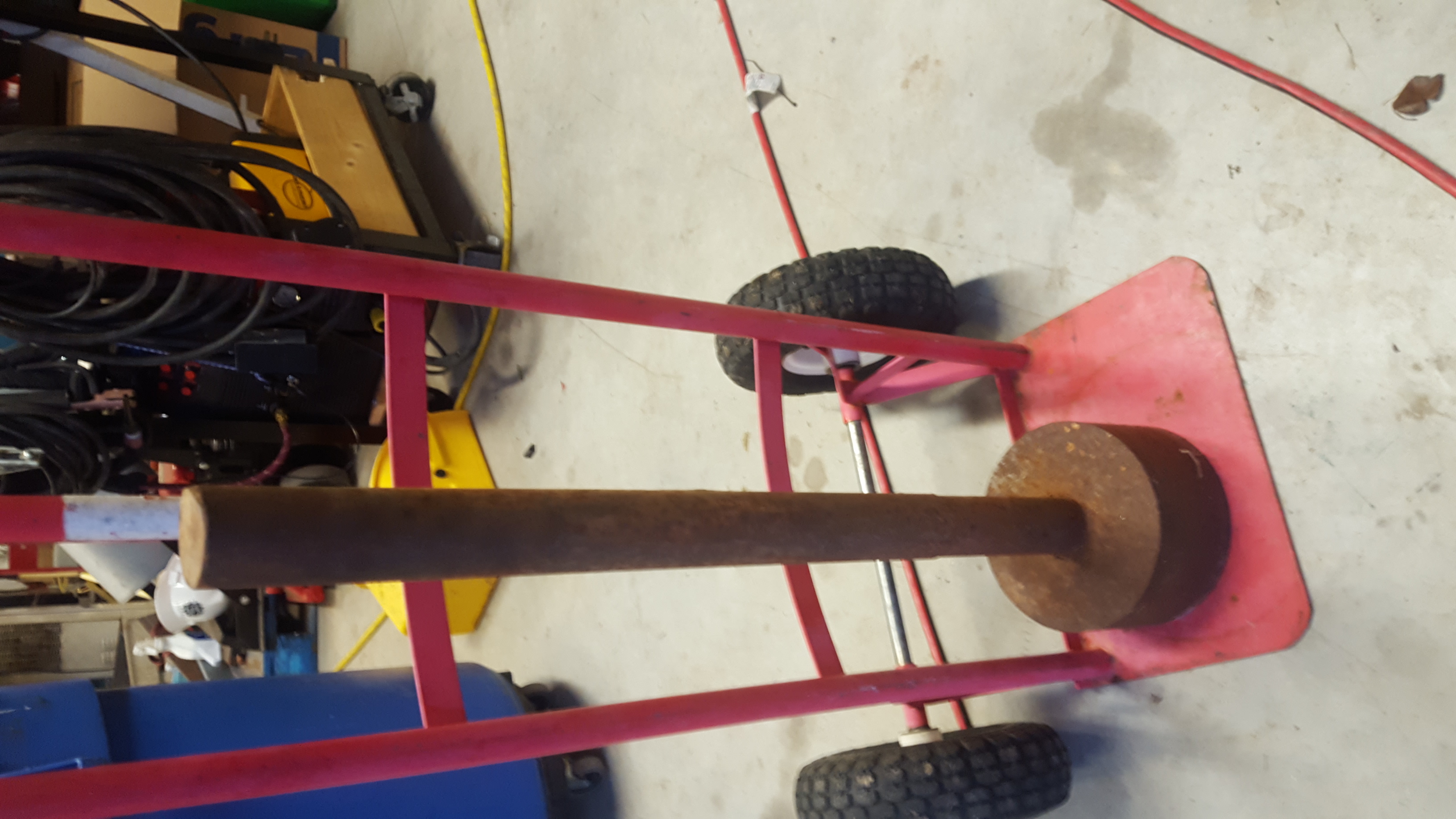

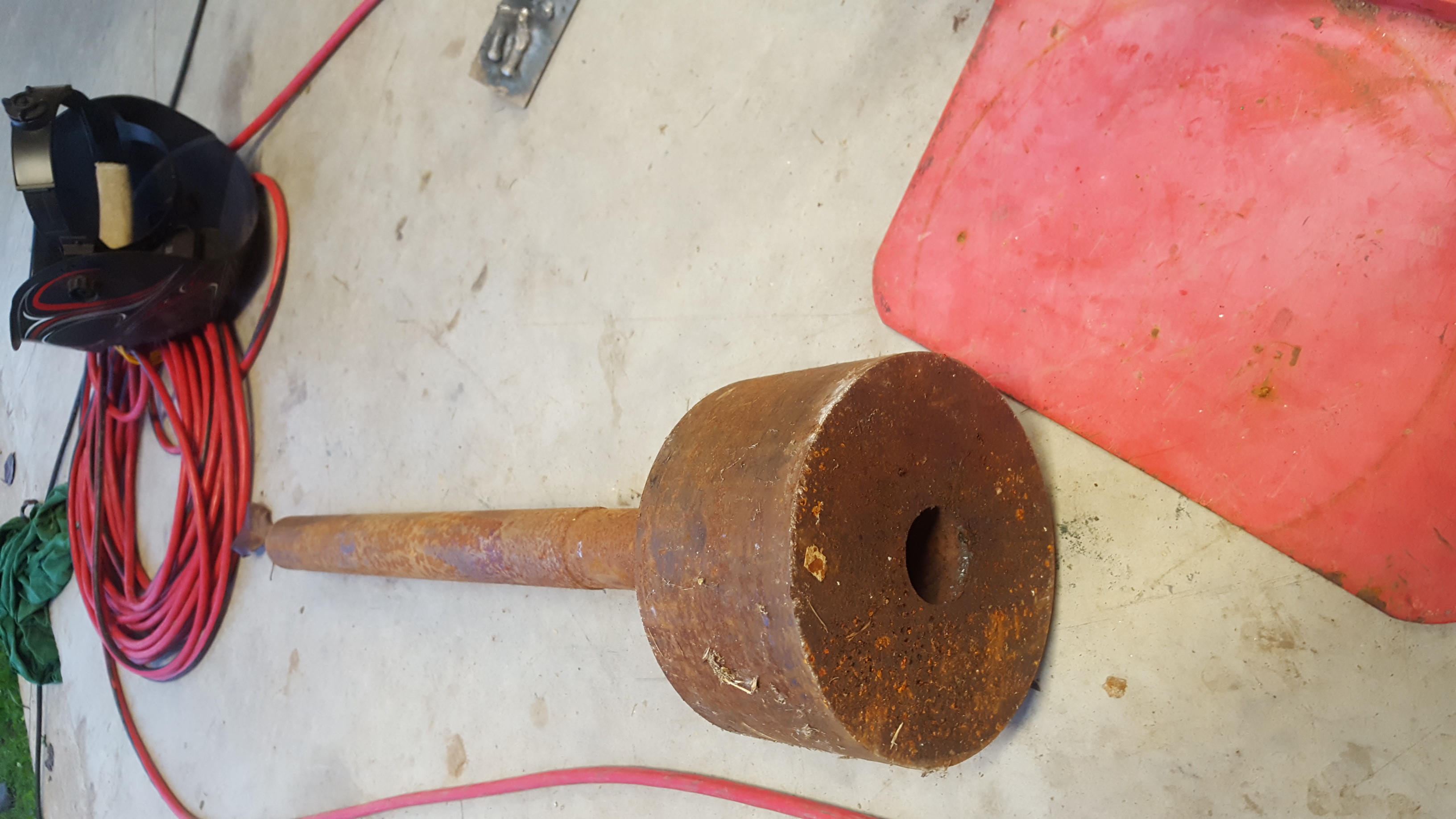

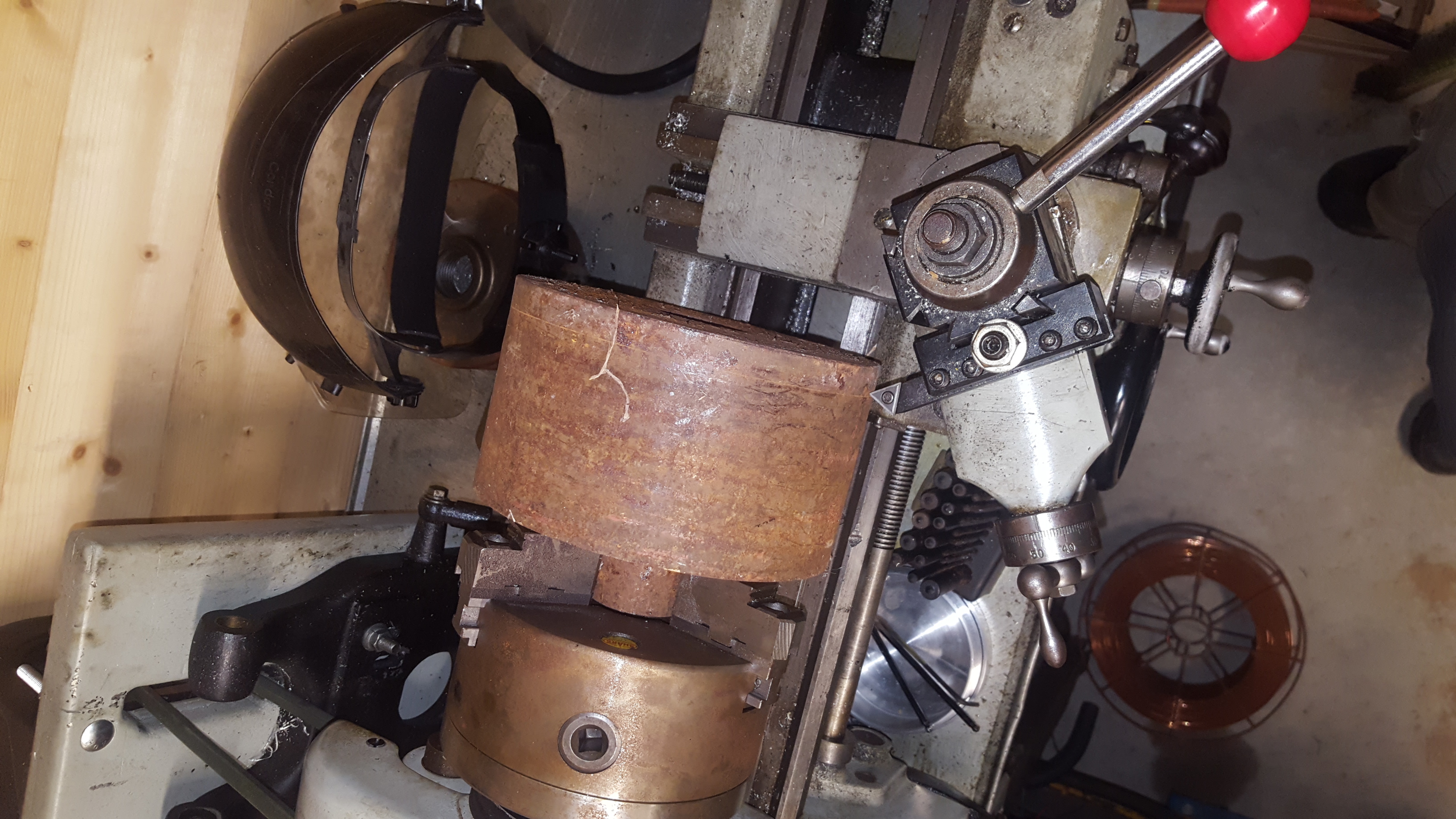

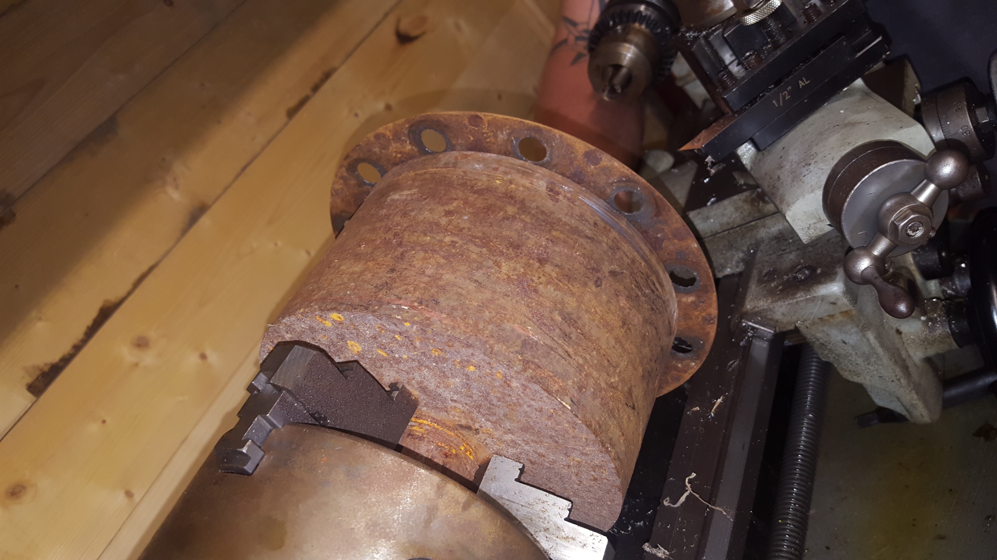

I got some bearings in the mail yesterday and I know I said I wasn't going to work on this for a while but seeing the bearings just sitting there is making me itchy. So I decided to get started machining the shaft adapter and bearing housing. For that I'm using this chunk of rusty steel which is a remnant of a project abandoned long ago. I was going to try to build a DIY lathe years ago, and this is what was supposed to be the spindle and chuck. It's a piece of 2" shaft that I turned down at the end and threaded 1.5"NPT and threaded this piece of 7.5" solid round stock onto it. I made it after hours on a lathe they had at a place I used to work (with permission, off the clock).
It's a good thing it has that shaft sticking out, because otherwise I wouldn't have had a way to chuck it up in my tiny lathe. It is requiring some creativity to machine it. I have arranged my tool holder in the most awkward and unorthodox way ever, and can just barely turn the OD.
