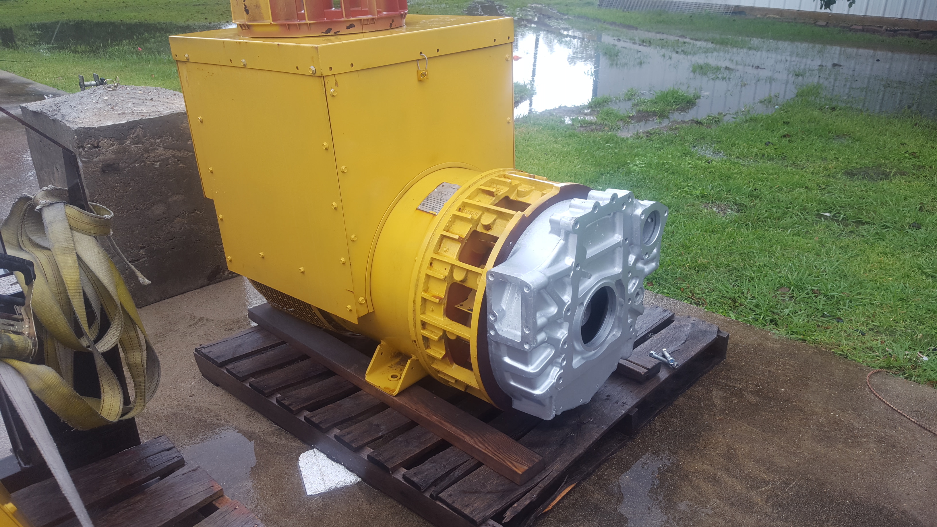

Picked up half a megawatt worth of Caterpillar power, think I'll make a PTO generator

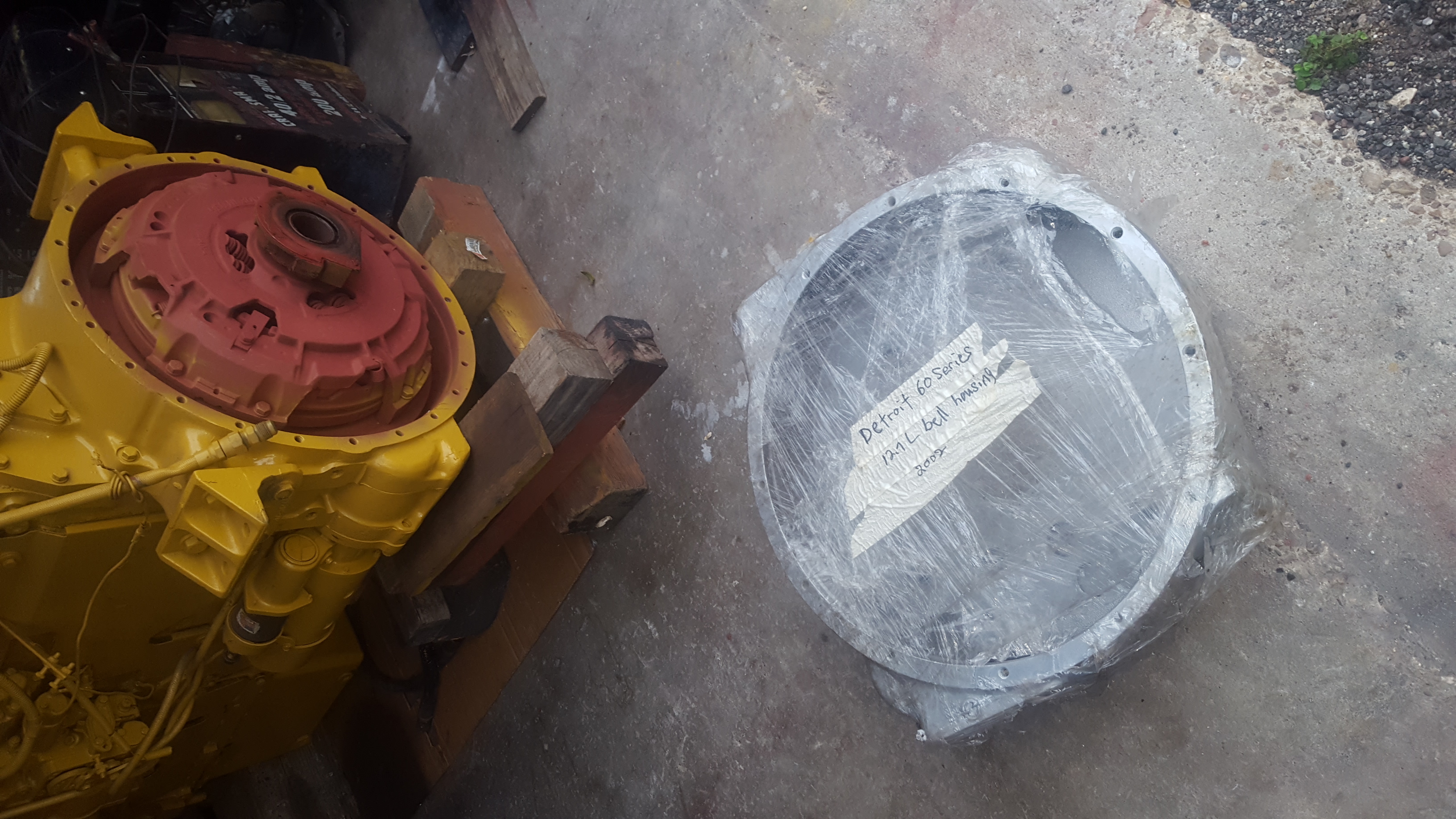

I am curious, though. it was never mentioned, but the second picture shows the proper diesels to mount the heads on, THAT would have been best.. and as far as efficiency goes, neither a gasoline nor a diesel gets more than a few percent efficiency!. but there are aircraft APU's that get 40% to 70% efficiency, the only problem is you'd need to remove the generators from them, since they are 400 cycle units, and mount your gen head to it, the other problem is, you'd have to make an interesting muffler, since the APU's are small Jet Engines..

I知 betting this generator head powered with a 40 hp diesel will stomp all over the efficiency of a regular person grade pto generator. This head is a quality piece that is probably more efficient than the much smaller and cheaper head. There痴 no parasitic loss to a gear box if it痴 direct drive. There痴 no parasitic loss to the tractor either. And retaining the use of the tractor counts as useful.
I cannot find published efficiency numbers for this head. Heads this "small" are apparently sold exclusively coupled to Cat engines, and the only efficiency-related data Cat publishes is the overall efficiency of the genset (engine + head), and fuel consumption data for various load from 25% load to 100% load. Caterpillar publishes much more detailed specs on their larger units, and they are typically 89% - 94% efficient at 25% load, and 95% - 97% efficient at 100% load.
The head is going to be less efficient at lower loads, as parasitic loss constants will occupy a bigger piece of the pie. I'm thinking that at any given percent of load, there will be the (more or less) fixed combined loss of generating the rotating field current, plus the load of spinning the fan, plus bearing losses, air drag of the spinning rotor, etc. I will be operating the head exclusively below 15% its rated load, usually 10% or less. So in order to estimate efficiency below 25% I've just taken the numbers from the larger generators and calculated the waste kW @25% load as a fixed parasitic loss, which looks like this:
...90% efficiency at 25% load, that's:
210kw * 0.25 = 52.5kw generated @ 25% load.
(1/0.9) * 58.33 kW mechanical
58.33kW - 52.5kW = 5.8kW (7.7HP) waste
So that's 7.7HP (conservative/worst case) just to spin the thing, with no electrical load.
If I were to utilize this thing at 10.5kW (5% rated load), powering my house, and there was 5.8kW tacked on top, that's only 64% efficiency. BUT...
I've done the math already on the field current generator and that's 1HP/746W.
Maybe another 1HP for the bearings, rotor drag, etc.
So I think it's reasonable to assume the big fan accounts for about 5HP. It's a pretty big fan.
That fan is designed to move the waste heat of a 210kW load. At 95% efficiency, that's 11kW of waste heat the fan is responsible for getting rid of. I won't be dissipating anywhere near that. I'll have the heat generated by field coil (746W) plus whatever inefficiency of generating 25kW max, so maybe 2kW.
I think I can ditch the fan, or at least shave the blades so that they don't throw nearly as much air.
I think I can this beast within the 95%-97% efficiency realm at my max load, with a single easy modification.

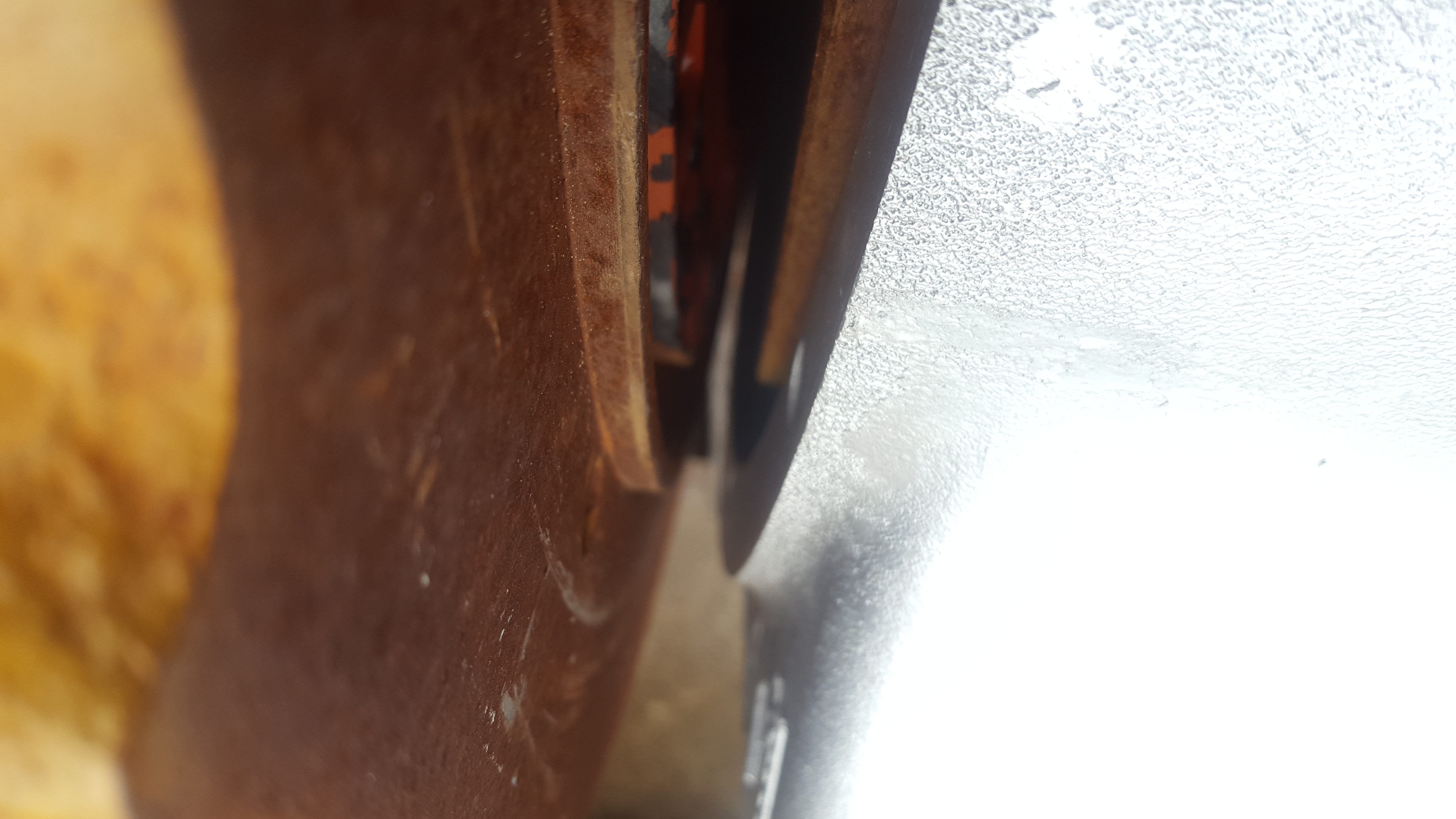

I got some bearings in the mail yesterday and I know I said I wasn't going to work on this for a while but seeing the bearings just sitting there is making me itchy. So I decided to get started machining the shaft adapter and bearing housing. For that I'm using this chunk of rusty steel which is a remnant of a project abandoned long ago. I was going to try to build a DIY lathe years ago, and this is what was supposed to be the spindle and chuck. It's a piece of 2" shaft that I turned down at the end and threaded 1.5"NPT and threaded this piece of 7.5" solid round stock onto it. I made it after hours on a lathe they had at a place I used to work (with permission, off the clock).
It's a good thing it has that shaft sticking out, because otherwise I wouldn't have had a way to chuck it up in my tiny lathe. It is requiring some creativity to machine it. I have arranged my tool holder in the most awkward and unorthodox way ever, and can just barely turn the OD.

Well today was eventful. What should have taken until lunch took until dinner, and resulted in bloodshed and bruises. Machining that big chunk is more than my little lathe was built for. I had to cut the stub end off the rotor so the flange adapter I'm fabricating can mate up. It would have taken 5min if the bandsaw fit, but the space was too cramped. So I went after it with a cordless sawzall, which worked, but was taking forever. 4 batteries drained, 3 blades ruined, I gave up on the sawzall and put an old 14" chopsaw blade (worn to ~9") on the angle grinder and cut it off with that. At the end the blade pinched and pulled my hand up against something that took a big chunk out of my hand.
After a successful fit test I put the adapter back in the lathe the other way and tried to remove the old rusty tapped stub with the parting tool, which snagged and popped the whole 40+ lb adapter blank out of the chuck and slammed it down on the back of my other hand. I called it a day after that. Had a chili's burger for dinner, it was excellent.

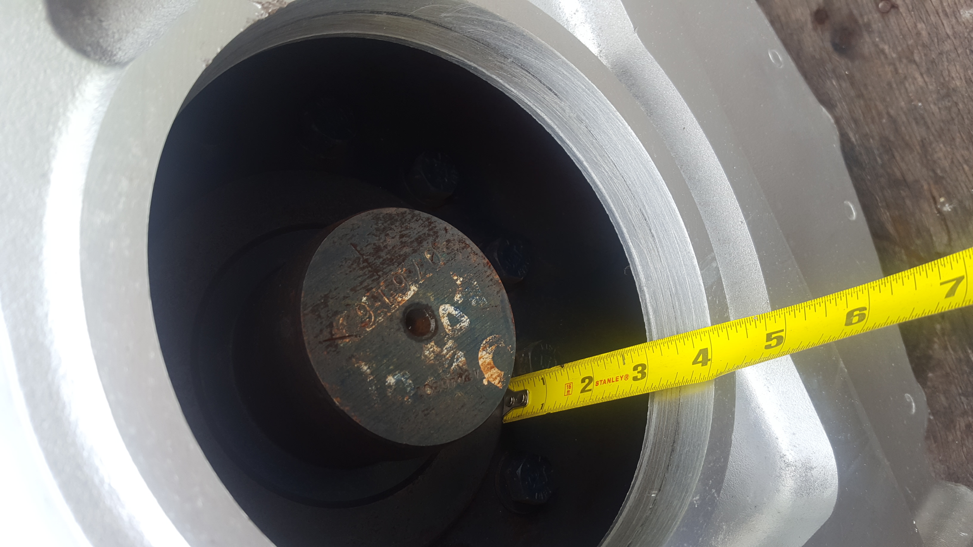

Just a clarification on the captured bearing. The bearing itself is just a common ball bearing, not a thrust bearing of any kind. If it's captured the housing the bearing fits in has only enough width for the bearing and is captured by the bearing cap allowing no axial movement. The end opposite the engine in the original use was likely a floating setup. It too is probably just a common ball bearing, but might also have been a straight roller bearing with a separate straight inner race. In the ball bearing case, the float would be in the housing being wider that the bearing and allowed to move axially as needed. That housing would not necessarily have a bearing cap.
I was going to go ahead and order a bearing for the end so that it's already here when I get ready to move on this project again, but then I remembered what you said about the captured bearing. I need to check out the existing bearing and see if it has any thrust support built in. If not then I might need to go with a pair of opposing tapered roller bearings on either side of a flange to keep the rotor from walking around in there.[/QUOTE]
Does this look right? I spent most of the day planning it out and machining it. Cut two disks out of scrap 3/4" plate with an acetylene torch. The plate on the outside is machined with a outer recess to nest into the bellhousing opening, and an inner cutout to for the bearing to nest into it. The other plate goes inside the bellhousing and isn't machined (yet, might just leave it that way) except for having 4 tapped holes. It's only purpose is to give the bearing and outer flange something to bolt to. The fit is pretty good; not a press fit, but close. Maybe 2 or 3 thou of play total (before tightening the bolts)
Looks like that should work.
