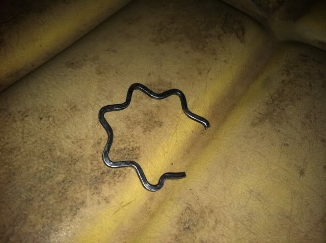

We only have one problem. When backing the tractor off the trailer, the left shift lever pulled completely out of the transmission. It appears that the star shaped snap ring was broken and I found the large part of it next to the shifter. Will have to wait until Monday to get a new ring.

R80839 Snap Ring ADD 3.78 USD
Check for missing shims key 12 & 13, (3 of each) plus the bearing key 14. You may need more than the snap ring.
Also if your shift boots have any cracks or tears replace them now. This is the main way water gets into the transmission fluid.

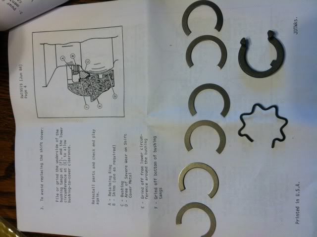

12 and 13 are missing. All that I could find is the pictured clip and #14.
   / Picked up "new" 2240
#18
Picked up the kit (RE18116) and installed it today. The instructions were very helpful and I had to grind and file down the collar/bearing to make up for the cover wear and the resulting vertical play. Ended up using 4 of the shims and the tractor seems to be shifting fine now.

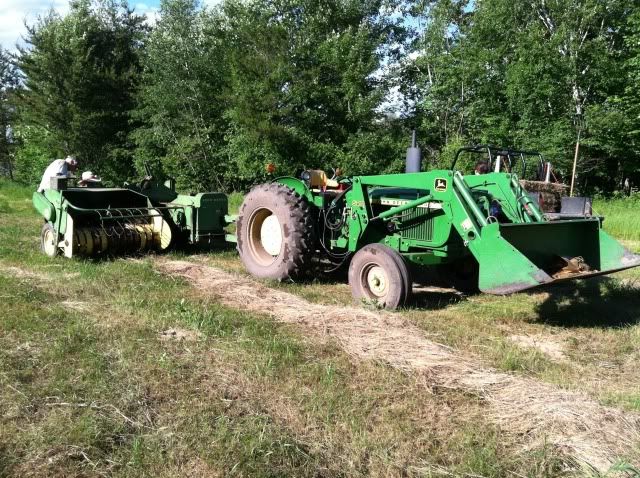

Put her to the test this afternoon. Tractor worked great. Probably the first time our JD bailer has been hitched to a JD.
