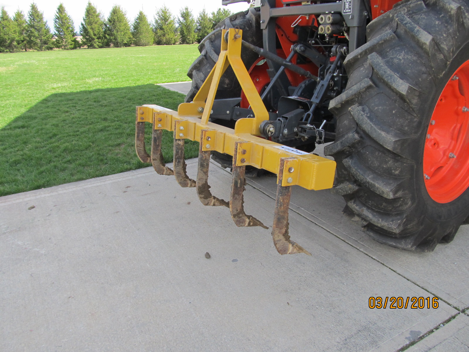

They were an add on though I initially started to cut the tines that way but changed at the last second. They allow me to push backward. Once the pile gets so big it's just no feasible to drive over it so I'll drag stuff up to the pile then cut hard at the last second dump the load then push it into the pile.

That looks great. I love the reverse tines!

A question about pushing backwards on a 3 point linkage - are all tractors/linkages made so that it is safe to push backwards on them? Are there limitations on this? I have always tended to the view that they work best pulling rather than pushing, but haven't thought too deeply or researched why I think that :)
   / Pics of my homemade rake in use #24
You can absolutely use a three point implement to push backward. No harm done. Just use common sense and don't beat on it too hard.
Chris
   / Pics of my homemade rake in use #25
Yep, you can do it, but it's definitely designed to be used primarily the other direction. Like Chris said, use common sense. For example, don't go ramming things in reverse, and keep your speed low while going backwards in case something snags; that way you'll have a chance to react before something breaks.

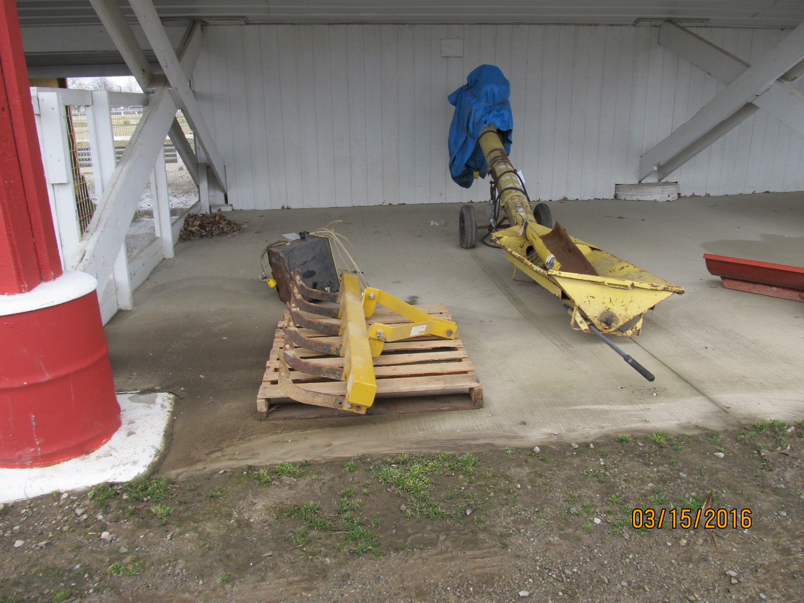

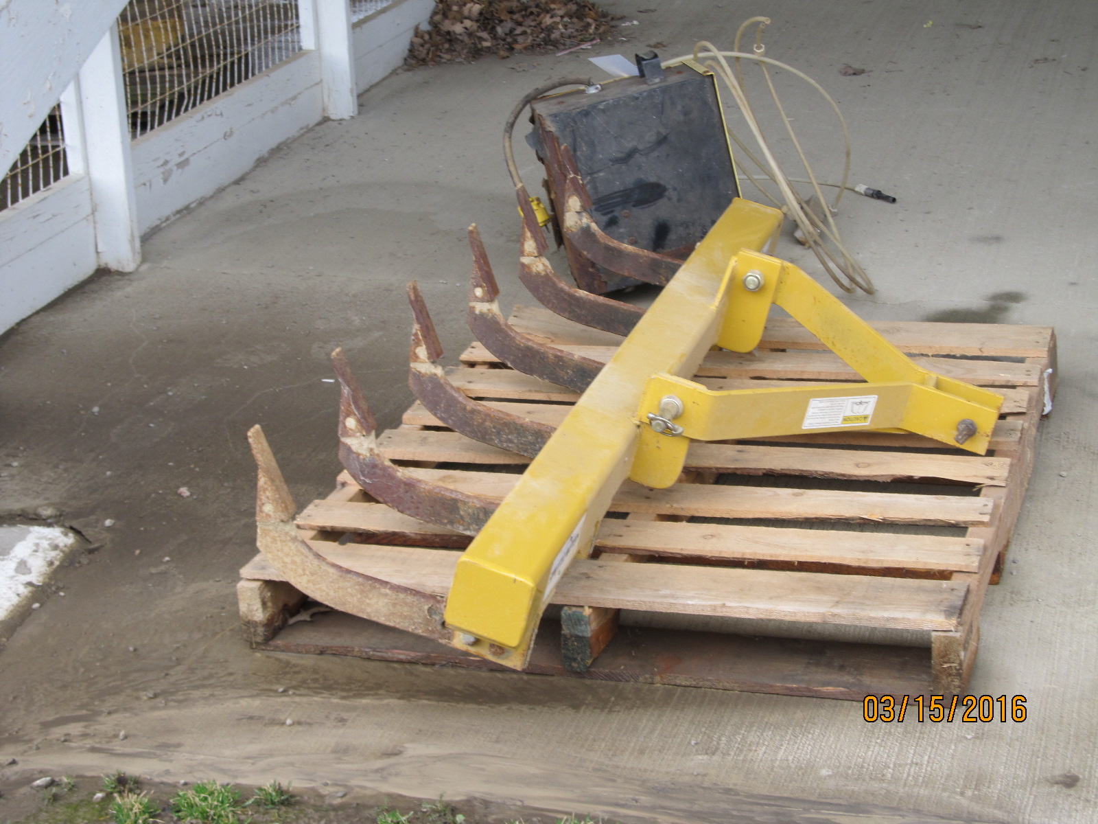

I knew I had seen something similar. Here's a photo I took at a farm auction today . Yours looks much better for brush with thinner tips and the reverse tine section. This thing is laying on it's side awaiting a farm auction this weekend. Yours is a great build.
   / Pics of my homemade rake in use #27
I have seen a tool like this before and I can see where it would make a great rake for bigger trash. I believe it's a smoothing and leveling tillage tool for use after plowing or aggressively working the ground but before some smoothing tool like a drag harrow. Of course, all this was before all the tillage trips were eliminated by different farming practices. It's great for small farms and I would like to find one.

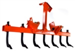

Maybe you saw the Land Shark Scarifier Bar From: Tractor Scarifier Bar from Everything Attachments

A better picture of the Land Shark Scarifier Bar, from the previous post.

Here's an even better view. I bought this one at an auction over the weekend. I'm hooked.
My use is different from aarolar, and I would prefer his thinner shank design but this one will work perfect for busting hard ground for me. I'd never get around to making one like he did. Anyway, this is a perfect mini ripper for my use. Thanks aarolar.
I'm hooked.
Yep, the best view, it is yours and on your tractor :thumbsup:.
