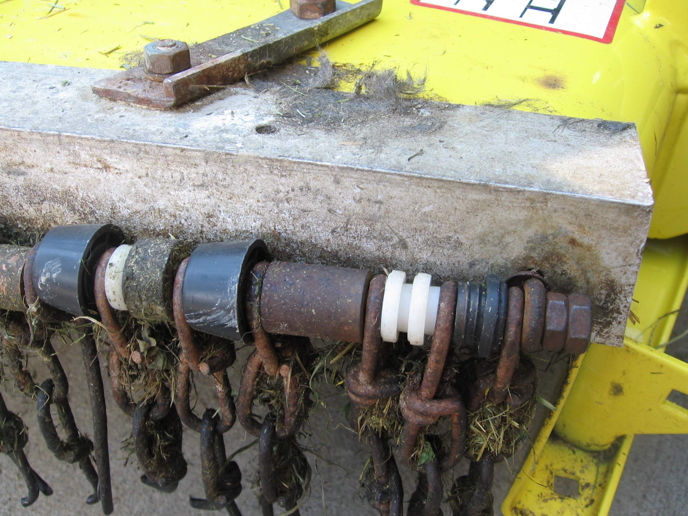

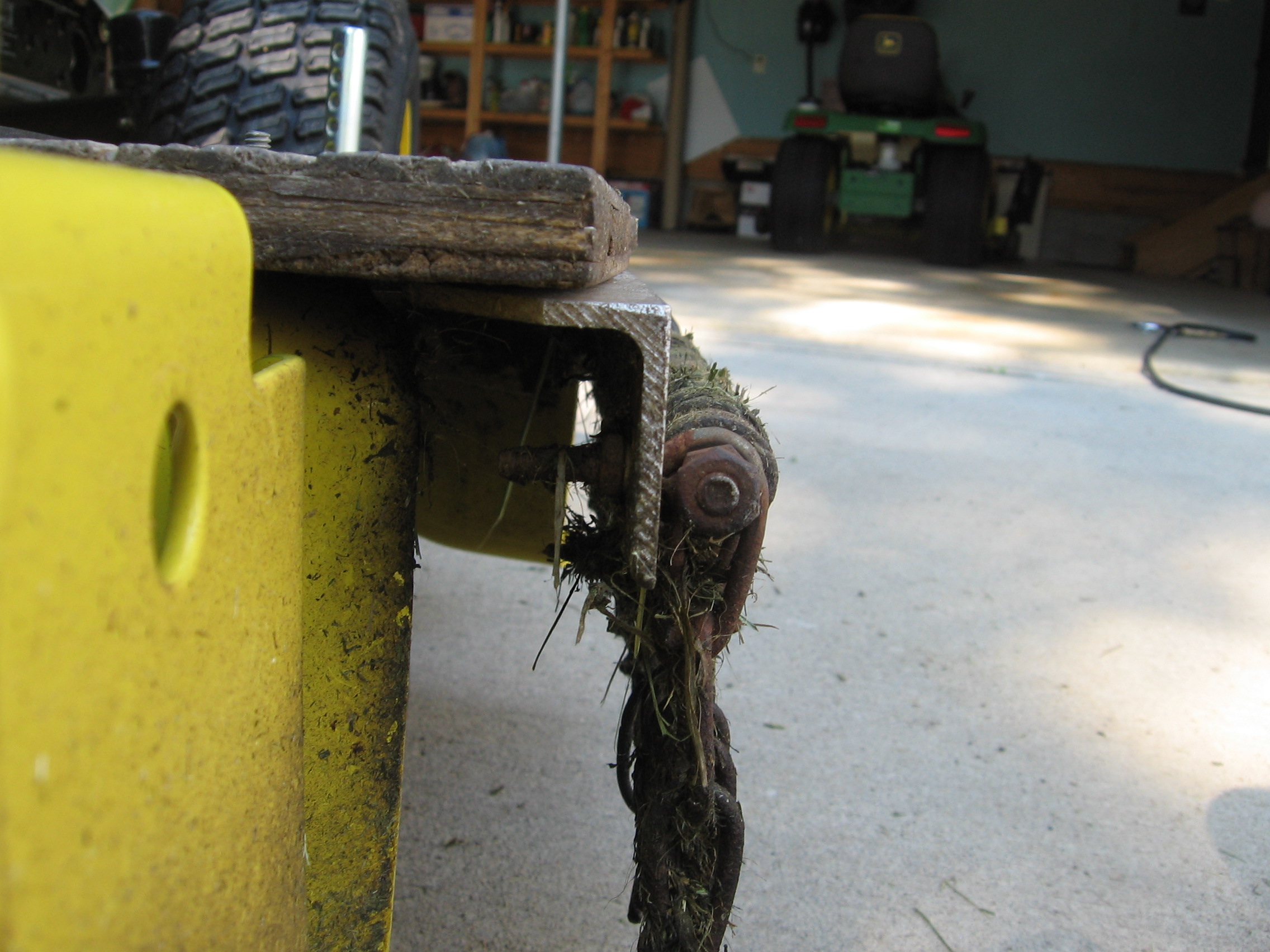

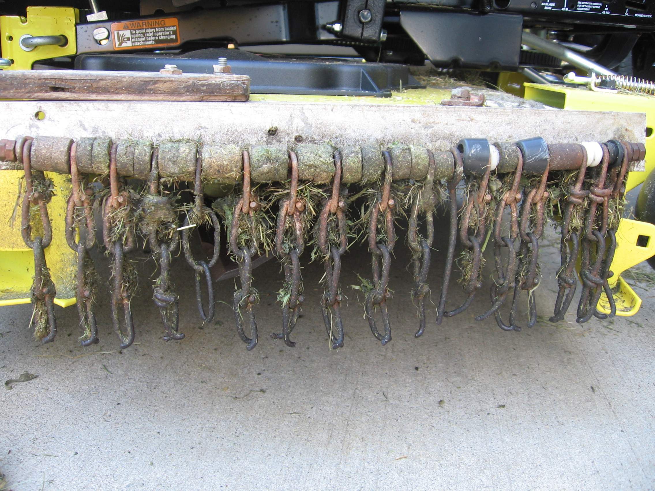

IMG_0292.JPGIMG_0291.jpgIMG_0294.jpgHere are some closeups of the chain gizmo I made for the discharge area. I used the piece of plywood you see instead of a metal strip like in the front because there is a gap in the rear area that the aluminum angle doesn't cover. The rest is 2 small eye bolts into the angle then a threaded rod through them with pieces of chain hanging between spacers I had or made. Using this type setup will tend to make the grass "clump" instead of dispersing evenly when it comes out. So if you care about that, it might not be for you.......... Link to tach was in my last post..........
Thanks for the additional pics and description. Doesn't seem too difficult to do...I should be able to figure out something for my 54HC.

View attachment 382359View attachment 382358View attachment 382360Here are some closeups of the chain gizmo I made for the discharge area. I used the piece of plywood you see instead of a metal strip like in the front because there is a gap in the rear area that the aluminum angle doesn't cover. The rest is 2 small eye bolts into the angle then a threaded rod through them with pieces of chain hanging between spacers I had or made. Using this type setup will tend to make the grass "clump" instead of dispersing evenly when it comes out. So if you care about that, it might not be for you.......... Link to tach was in my last post..........
Personally, I would use a heavier chain closer together. The heavier the chain, the better it will be at knocking down rocks and other nasties.
