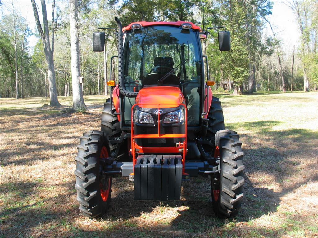

the grill guard that normally comes with a loader won't work. the one stu needs allows for the weights to be taken off or put on. the regular one doesn't have enough clearence for the weights. in the summer when i am doing hay, i take the loader off and put the weights on. also when i'm brush- hogging. when i put the loader back on, i can take the weight's off but leave the front weight bracket on. the weights have to come off for clearence for the loader. hope that makes sence.
Tractor is at the dealership having the Grill Guard and front weights installed. I'm also having the dealer widen the rear tires from 60" on center to 64", and to widen the front tires as well.

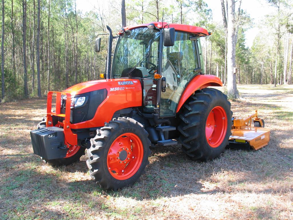

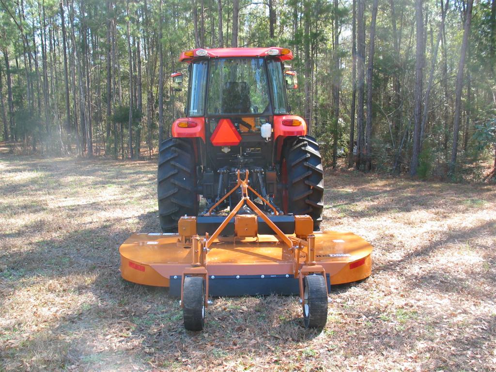

stu, do you have any pic's with your upgrades?
Bill,
Here are a few I took in Feb right after the Grill Guard was added, and the Rears were widen'd to 64" on center.
Glad I had the new grill guard installed as I am now planning to install the LA1153 loader this summer.
Stu

you're tractor looks great. i think you'll like the wider stance when you get on side hills.

How does the 5040 handle the 8' cutter? Any hills or problems so far. I have a mx5100 and was curious if it could handle an 8' cutter
It doesn't even know it's back there! Mine is the 3pt version, but you can also get a Pull type, and some offer a Semi-Mount version of 8' cutters. I don't have a FEL so I added about 500lbs of front weights. I can't help you with whether or not your MX5100 can handle a 8' cutter....but lots of folks on here own a MX5100 and maybe they can answer.
