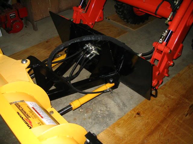

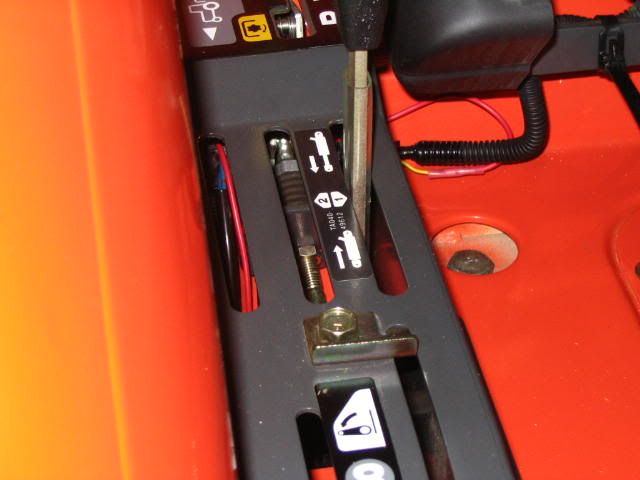

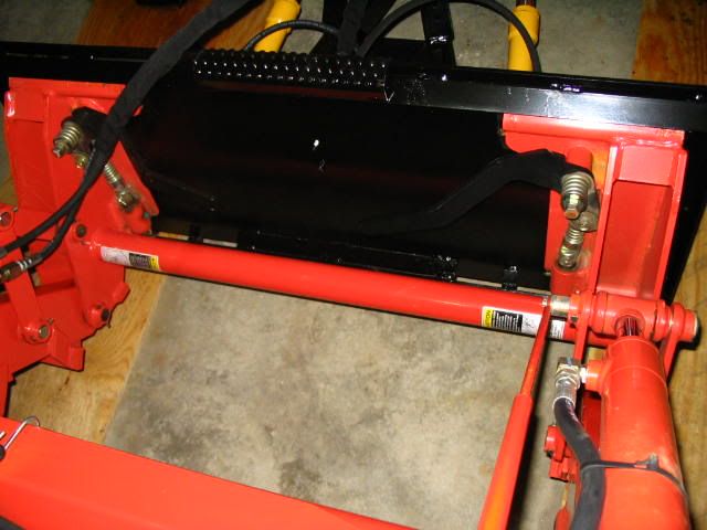

hi. they installed a remote on the rear of the tractor and routed the hoses up to the FEL. i've attached a pic of the valve lever which controls the power angle. it is to the right of the operator's seat, just above the 3ph control.

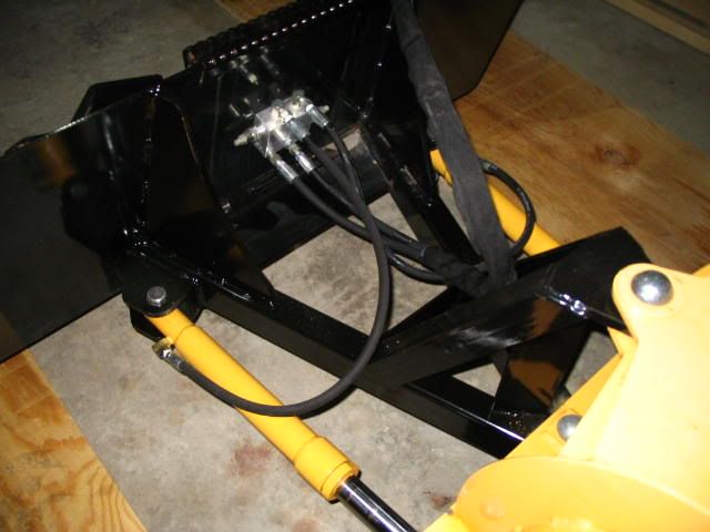

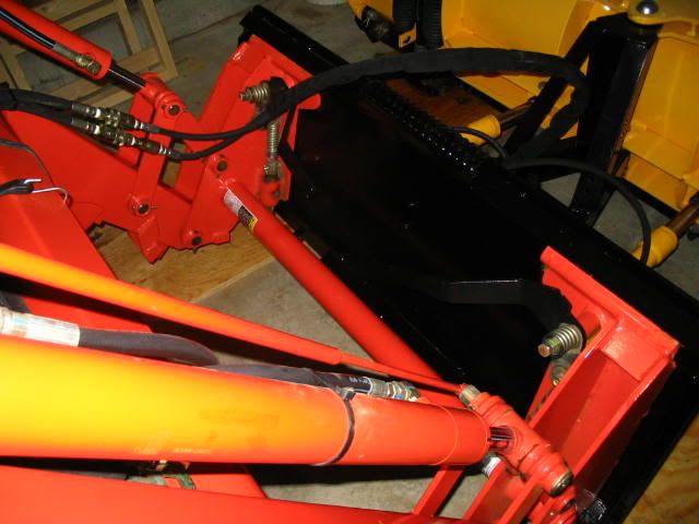

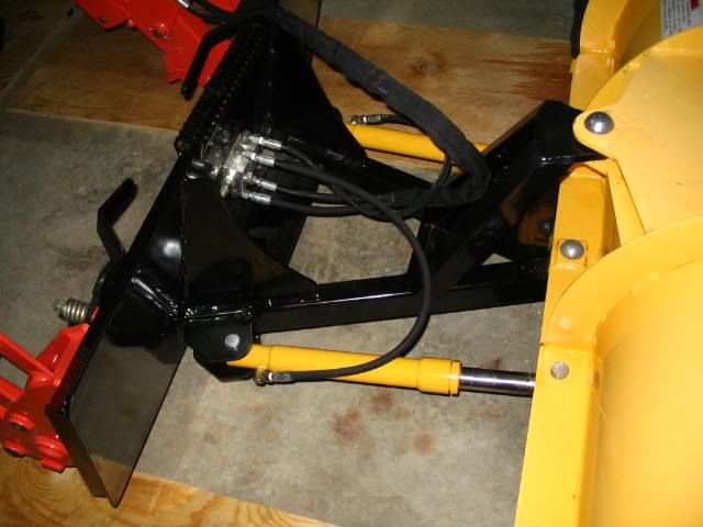

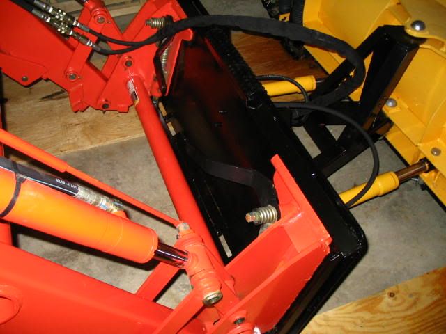

hi Ron. i attached several pics of the plow hookup from different angles. hopes this helps.

That's a nice clean looking setup on the hydraulic lines. One last question, if you decice to remove the front end loader, do you have to disconnect the lines from the rear remotes or do you have another set of quick connects near the rear of the FEL? This way you wouldn't have to crawl under the tractor to pull the lines to the rear remote during FEL removal.

there are quick disconnects but they are toward the middle of the loader. i'm not sure if that's what they're called, but they have the male/female fittings that hook together, once you disconnect the plow. they are not permanently attached to the loader, but the hoses would probably be in the way. looks like you'd have to disconnect from the rear remote and remove the hoses, to answer your question. i'll probably never remove the FEL anyway, it will be way to handy to have the bucket on the front.
take care, pat.
