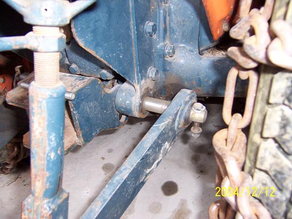

pic #2

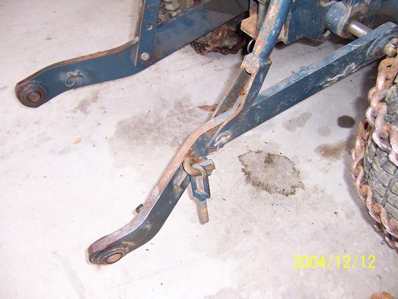

pic 3. I took these pics to find out where the rear check chains would hook up. It appears they go on the outside. Which is odd because the ownders manual depics them on the inside

thank you very much for your help - any extra pics of how the hydro outlets work would be great if its not too much trouble
as to the check chains i would say they connecyed to the bolt on pic 2 but i dont really see where they would attach to the tractor

I just built the thre pt hitch on my b 7100 it is simular to yours I bought the arms on e-bay they also had the stabelizers on the outside I just took out the eye bolt and rebolted them from the inside my draw bar hookup is lower the 7/8 bar rides above it so i made a 3 1/2 inch scd 80 pipe nipple and welded a 1/4 by 3 plate with two holes to the nipple and slid it onto the 7/8 shaft i then connected my stablilizer bars to that it worked fine for mine

well as u may have already seen, my 3 point is bent so when i start using it seriously i plan on buying a new setup, thats when i'm gonna modify it for the checkchains
