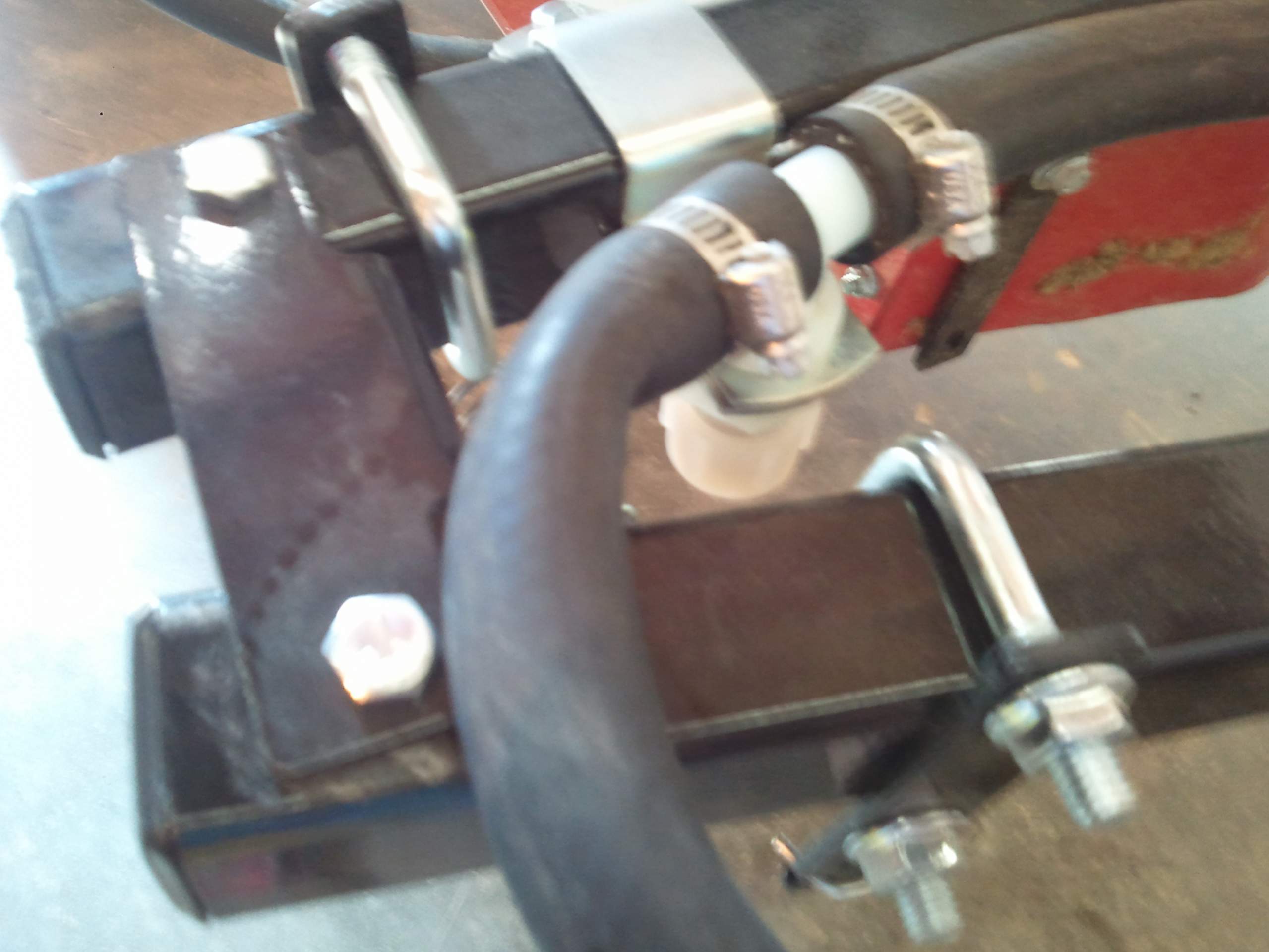

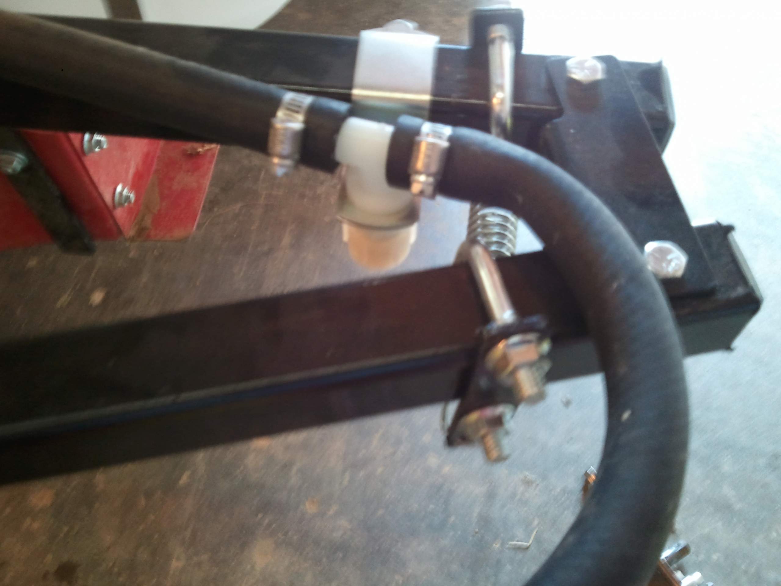

Didn't get to this last weekend, but was able to yesterday... Loosened the nuts on the spring attachment point U-bolts and flipped the spring plates over. Reattached the springs, and here's what I got (sorry for the fuzzy pictures):
Not near the crimp in the hoses that I once had, so problem solved! Thanks again for the advice LHS Inc! :thumbsup:
Eagle
I'm glad it all went well. They seem to be nice sprayers.
