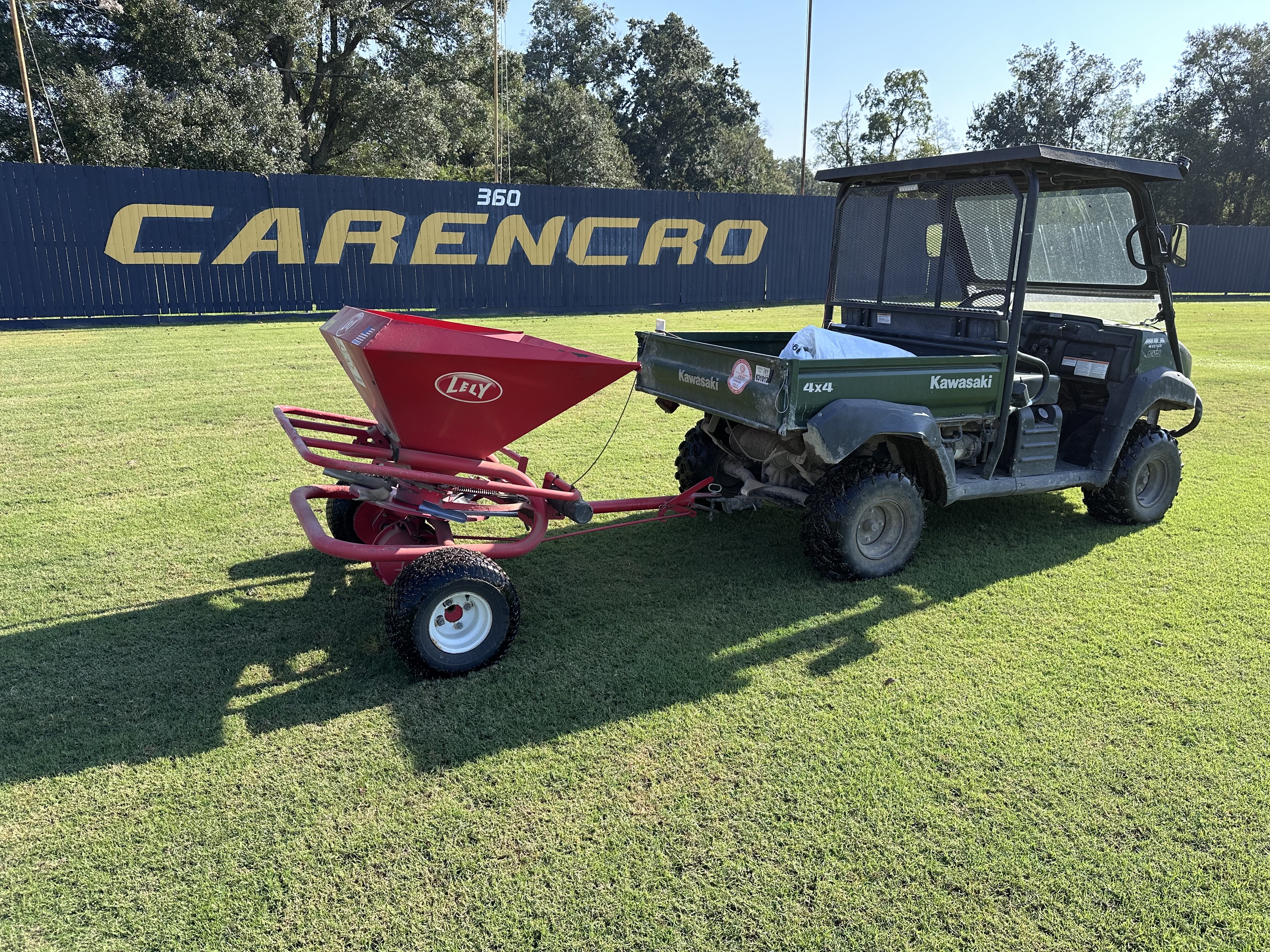

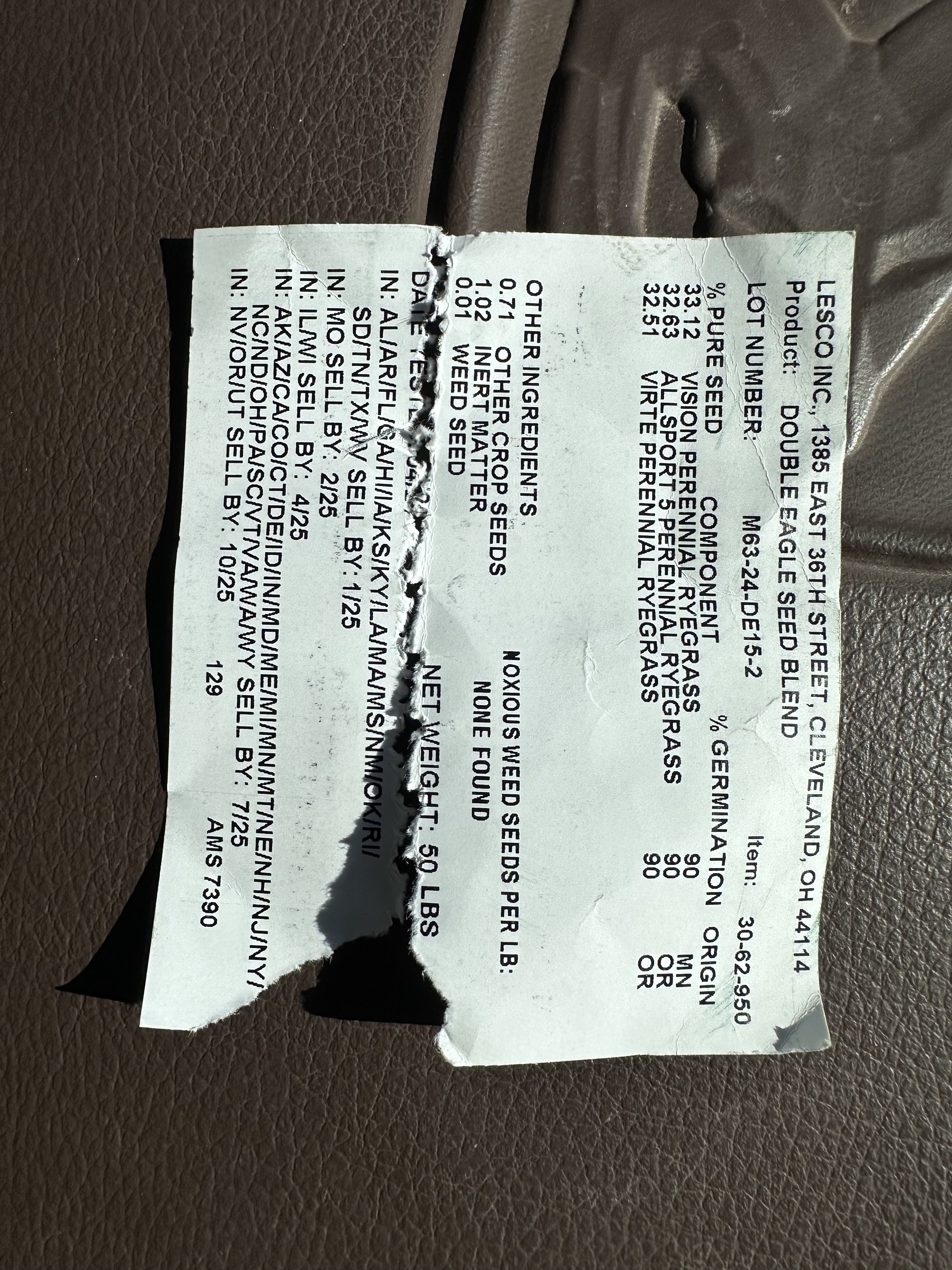

It’s time to start overseeding baseball fields with ryegrass. This field was done with my broadcast spreader. Most of the fields I plant are with a small drill seeder. I’ll post pics of it when I do a field with it.

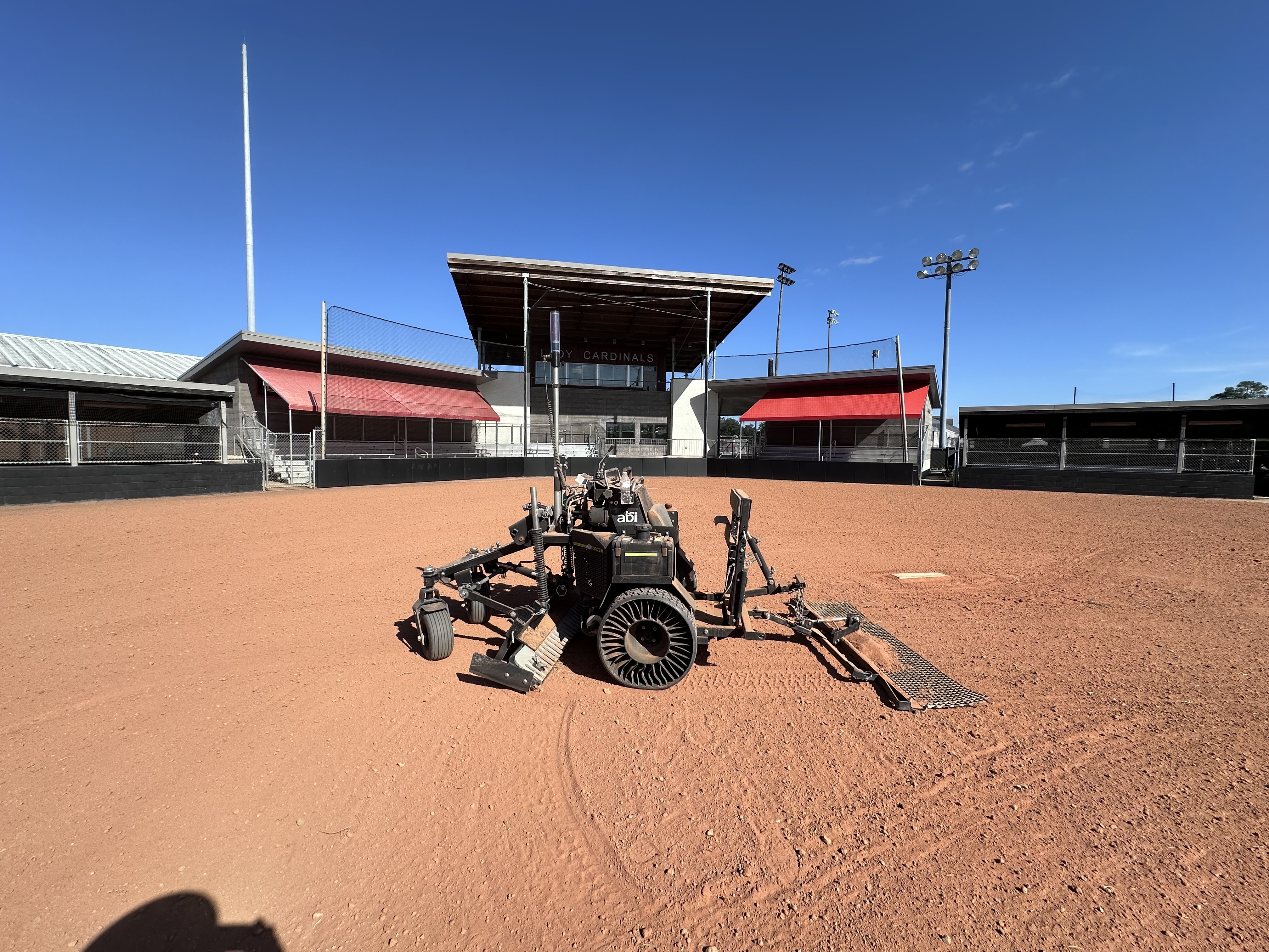

Finished this softball field today. It was a fairly big job just South of New Orleans. We rebuilt home plate and the pitchers mound, aerated and topdressed the grass area, removed the lips around the skinned area, added infield clay and laser graded the skinned area.
It took 3 days to complete this job which meant driving 3 hours one way each day. It’s never easy driving through Baton Rouge and New Orleans.

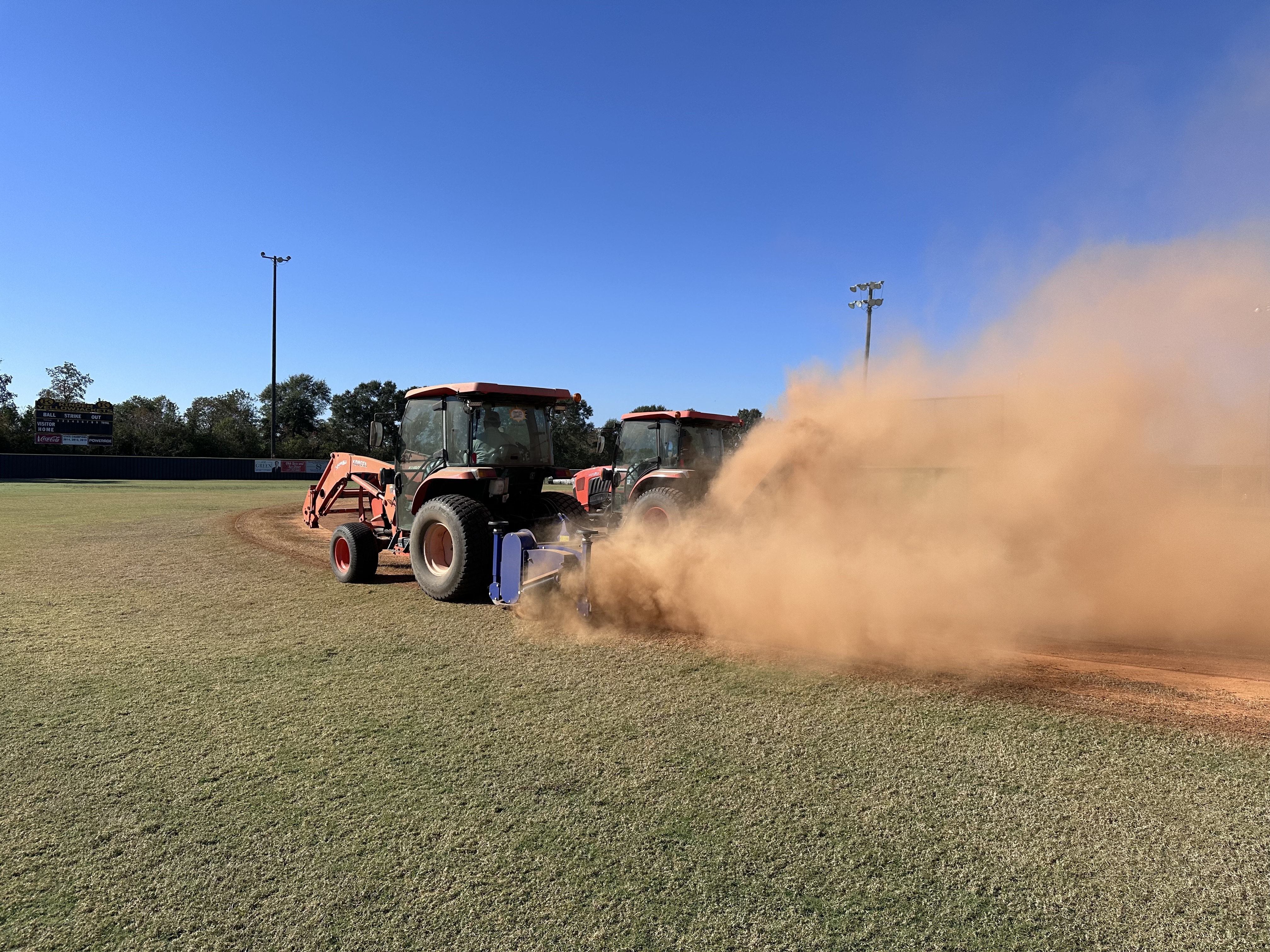

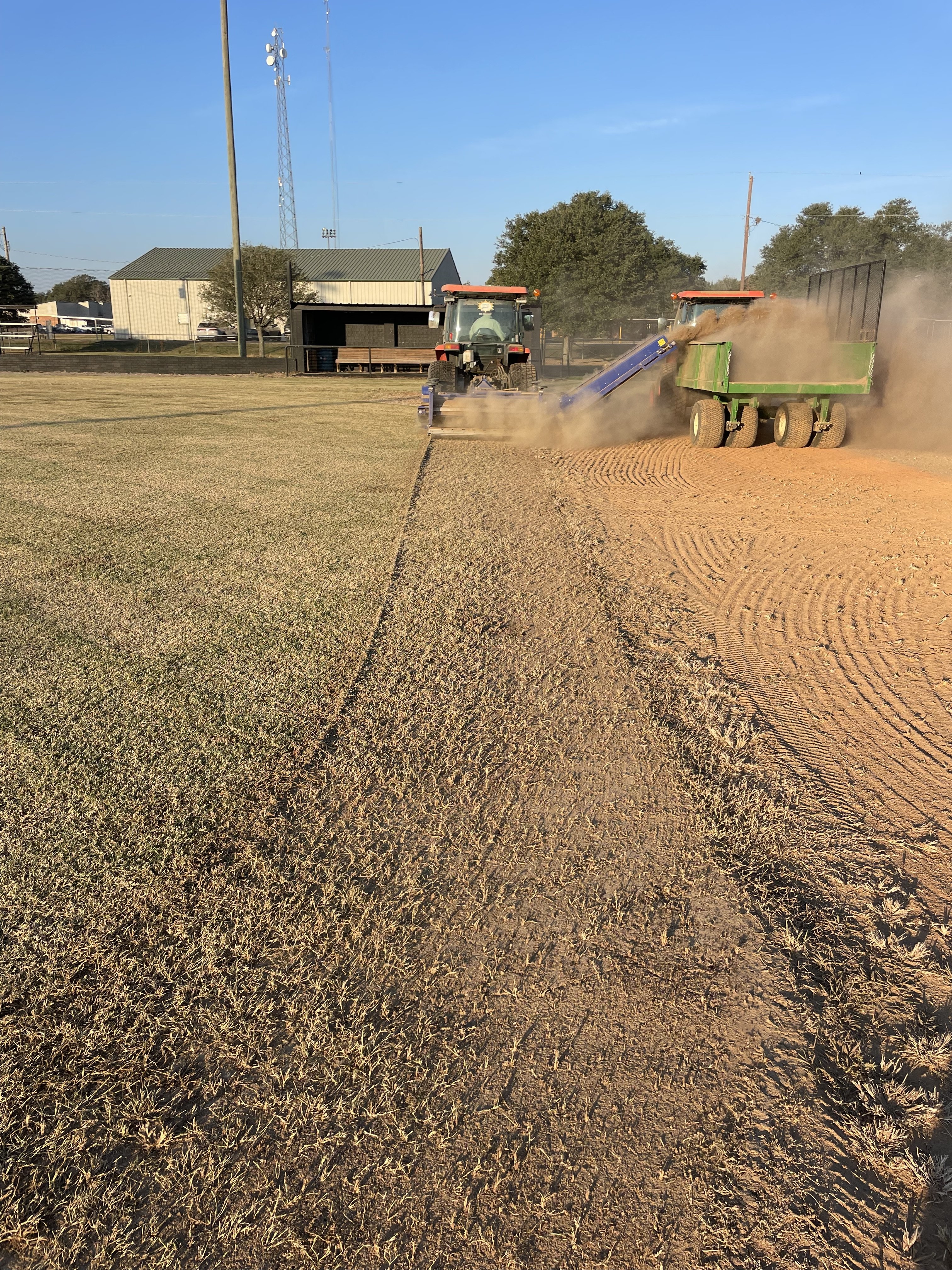

Another lip removal job today. You can see how dry we are right now. Thank God for cabbed tractors.
   / Pictures from an athletic field contractor #147
You've got some unique equipment!
   / Pictures from an athletic field contractor #148
That's a lot of material in your trailer!!!! Is the lip caused by the grass growing and thickening over time?
#149

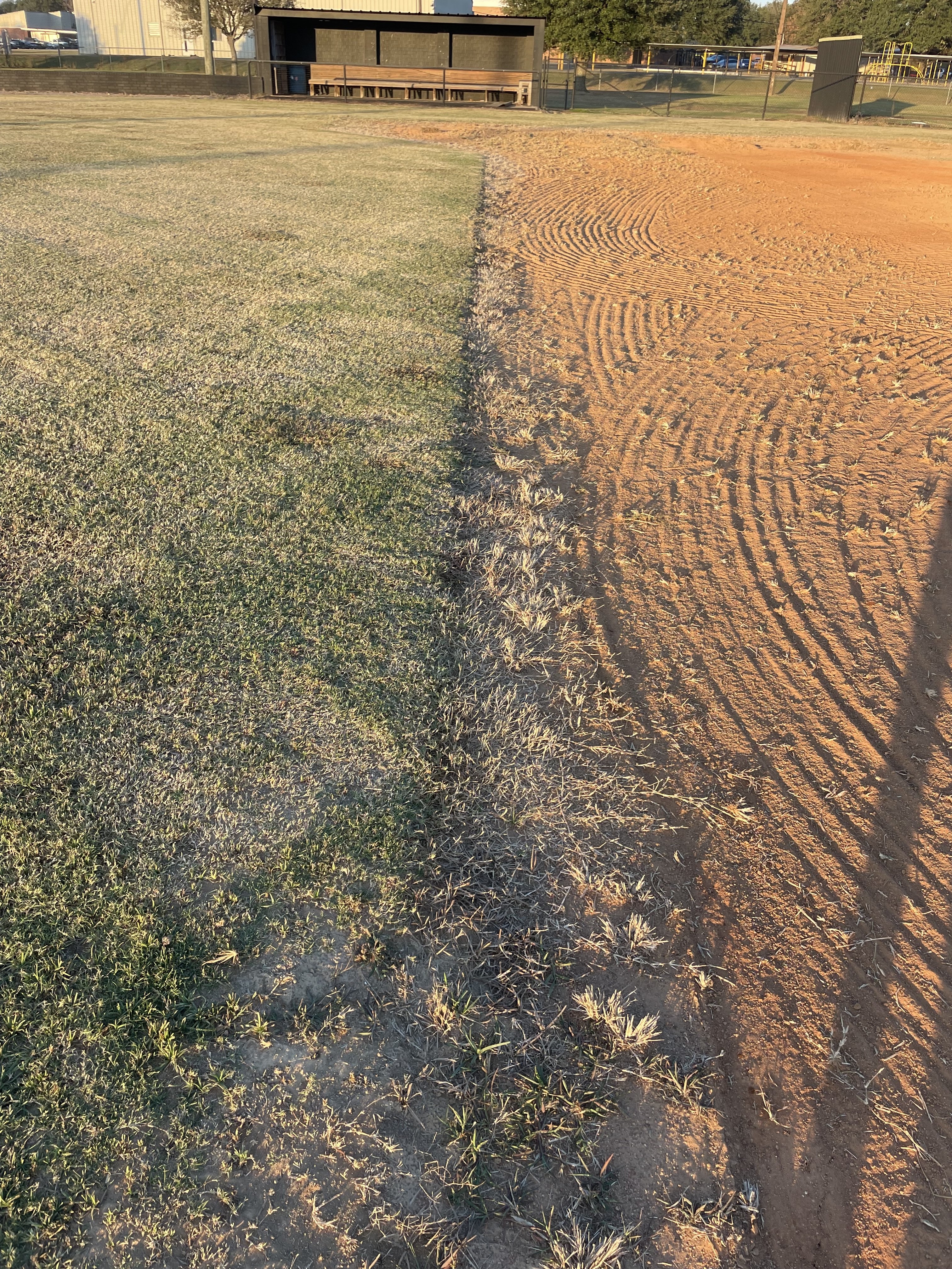

The lip is most likely caused from when they drag the infield in a circular motion, they tend to throw a little of the infield mix out into the grass. And, since there is no grass on the skinned area to hold the soil in place, wind and rain can push it out into the grass area too. And, the grass will tend to build up a thatch layer too.
So, really there are lots of reasons, but it happens on almost all baseball/softball fields.

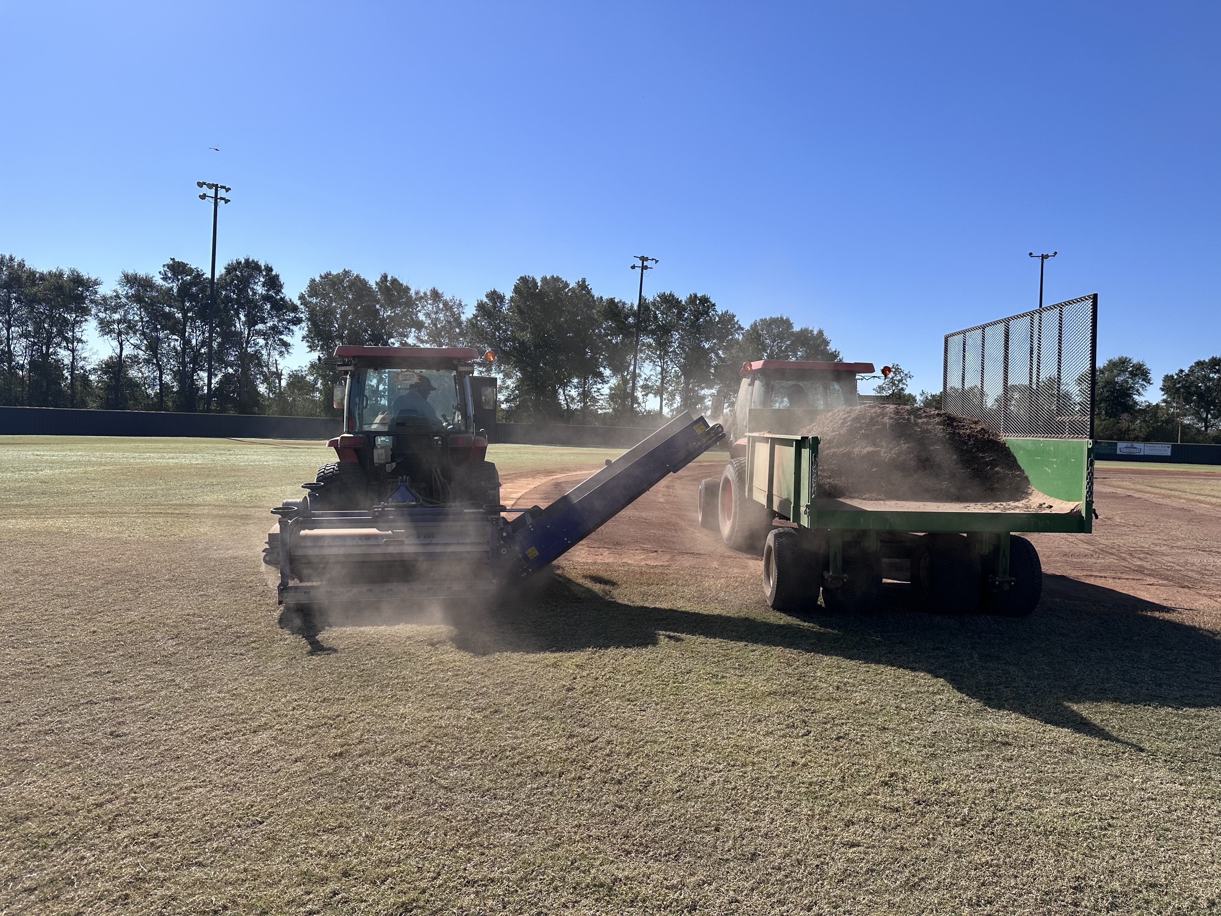

This is a 'before' pic of an infield.

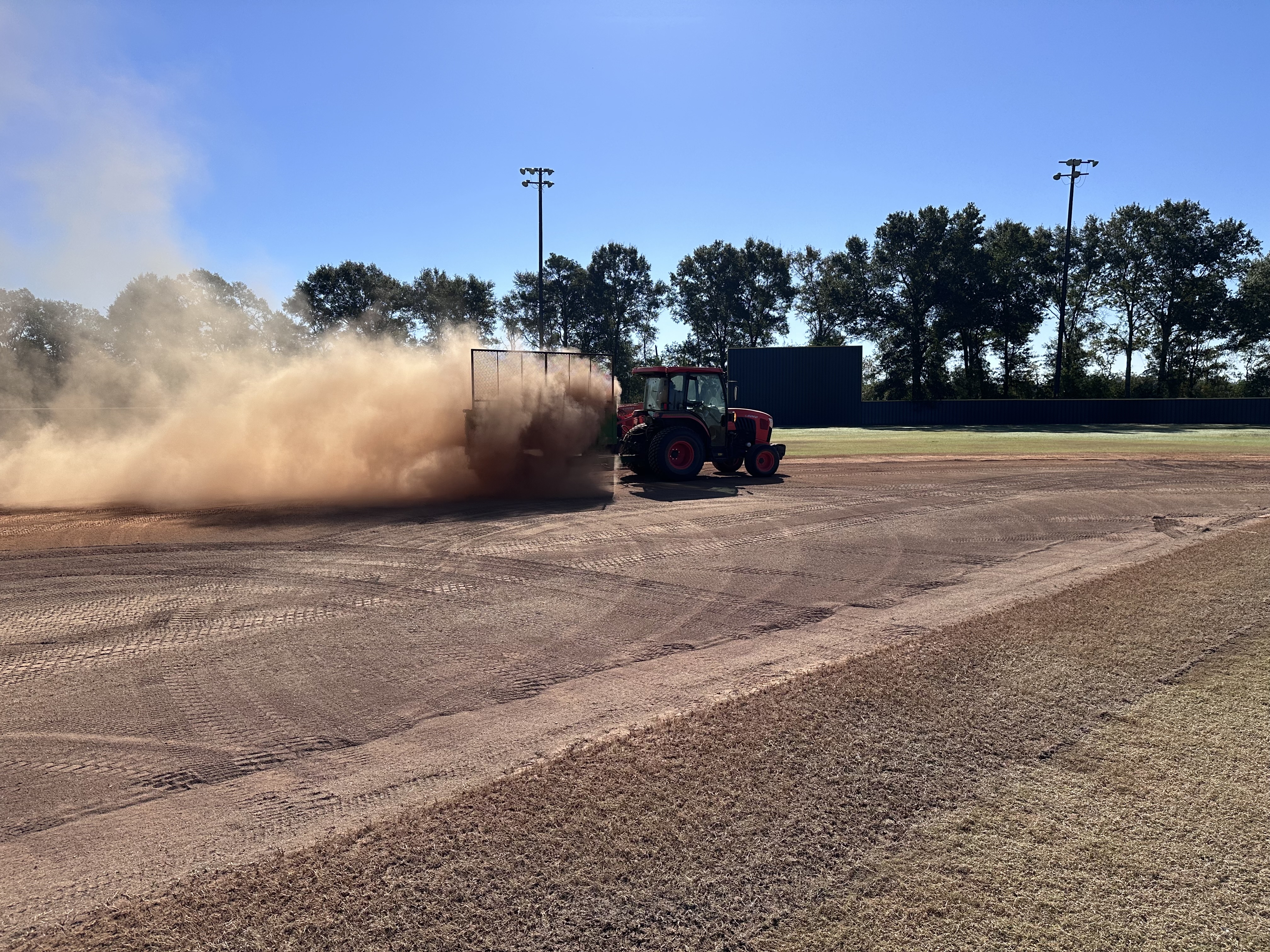

This is after removing the lips. We actually made another pass after this one because one pass wasn't enough.

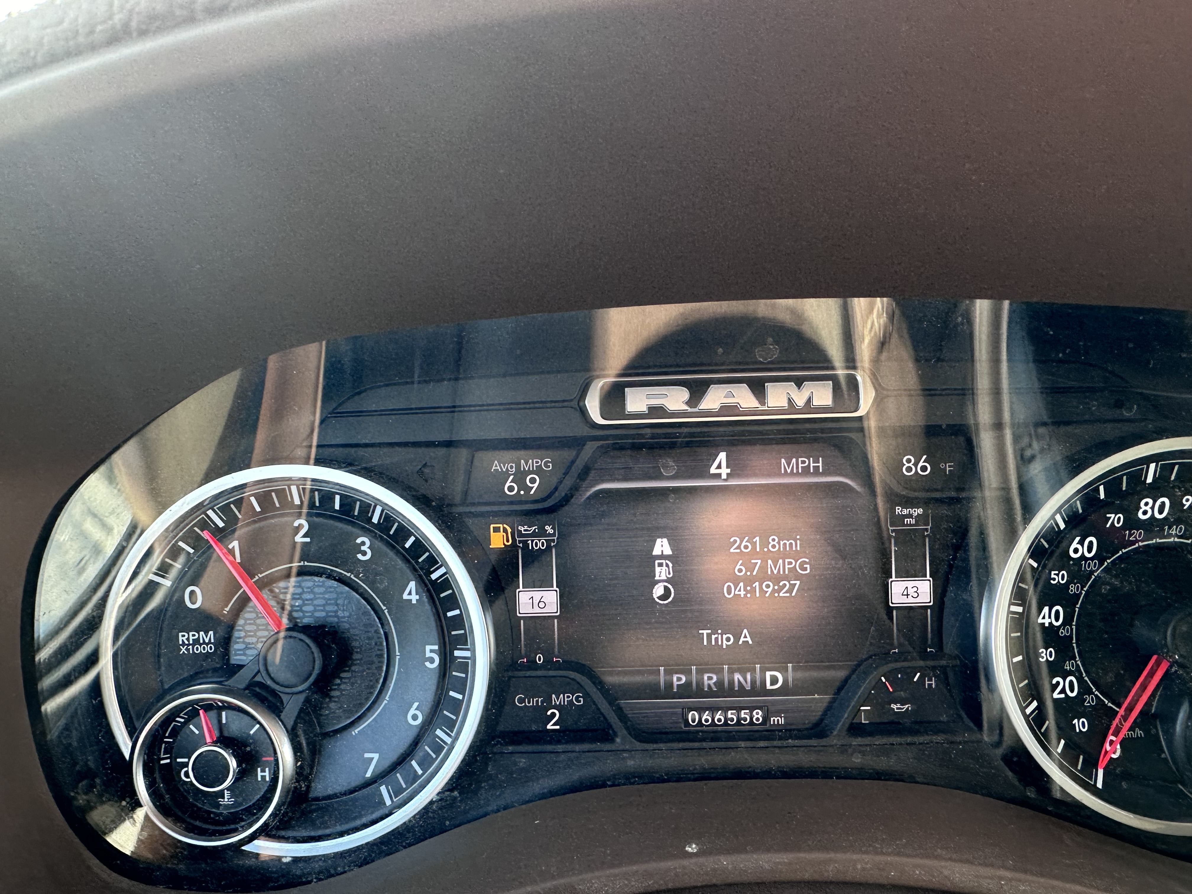

This was when I got home. You can see I averaged 6.7mpg on a 261-mile drive. This is about as far as I want to go for a job. 4.5 hours travelling one way is a long day. I did drive up there yesterday, because I was part way there on yesterday's job. Coming home was battling a 20+ mph head wind. Hauling the tractor with the wagon on the 28' trailer is like dragging a parachute.
