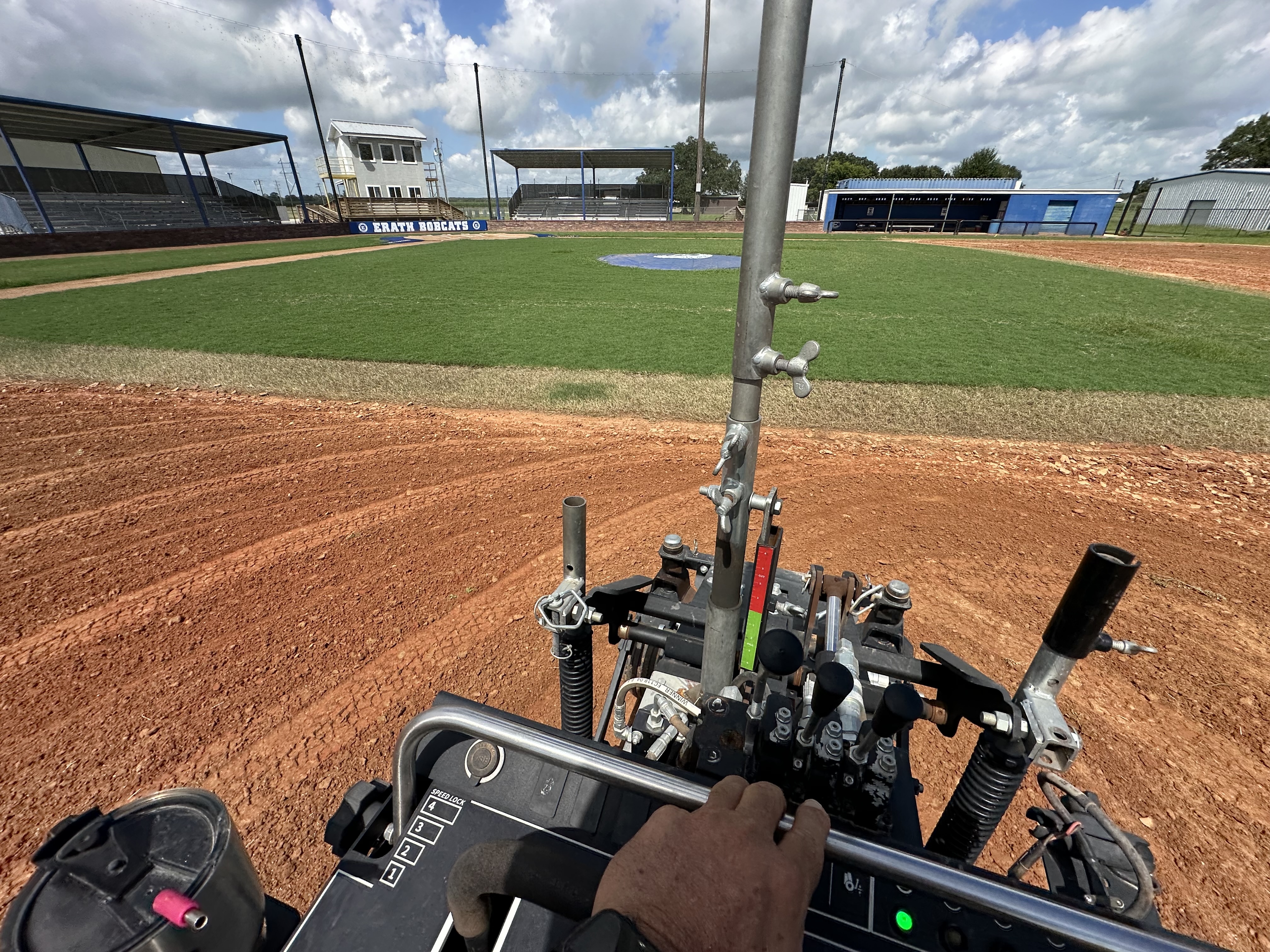

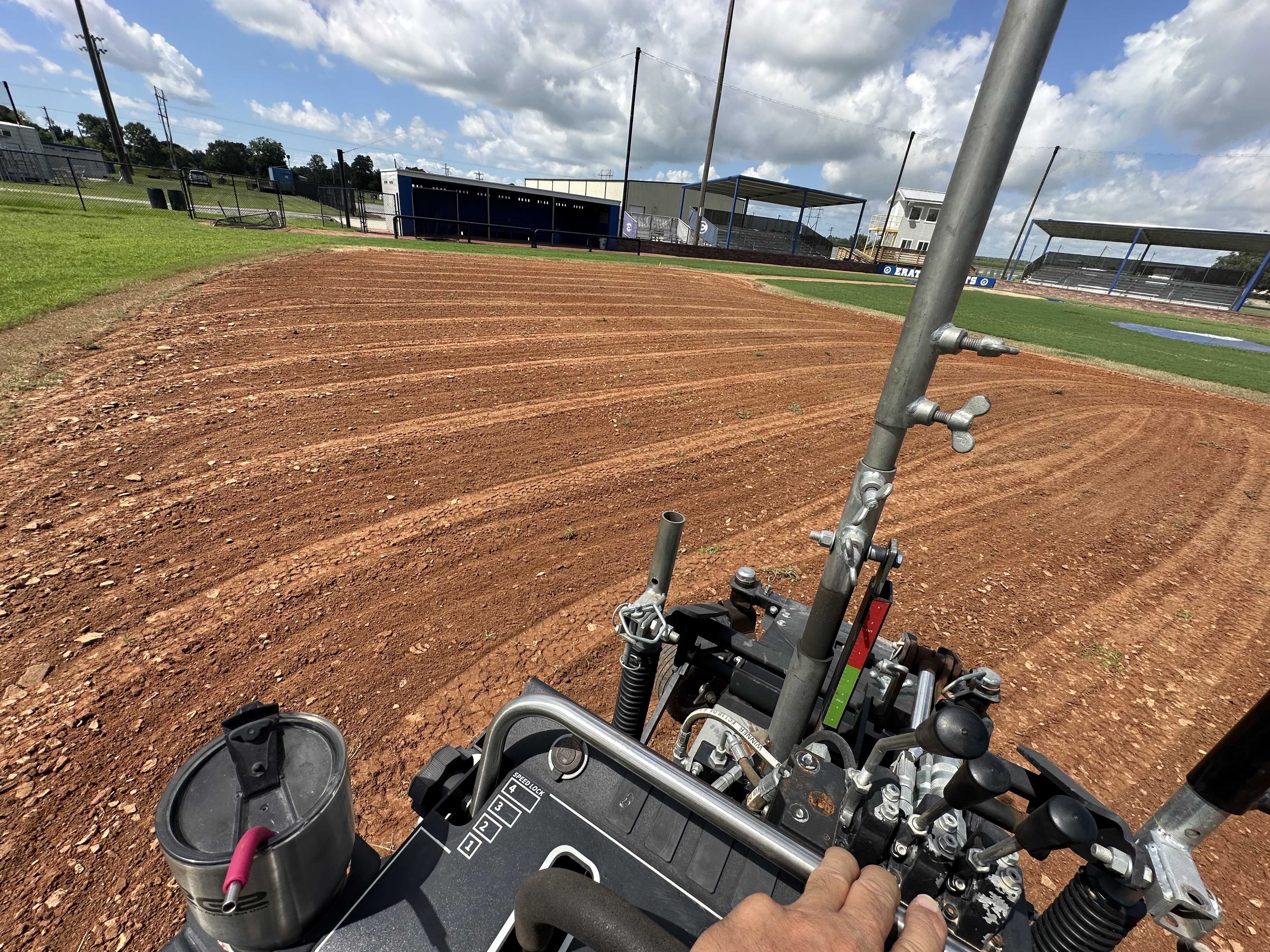

#322
A little infield maintenance today.

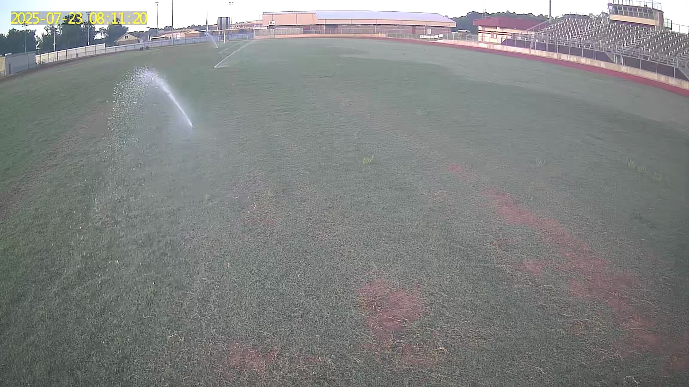

#323
View of the field we planted on May 23rd. It's about 80-90% grown in. It usually takes about 90 days to grow in to 100% coverage. We may be slightly ahead of schedule.
