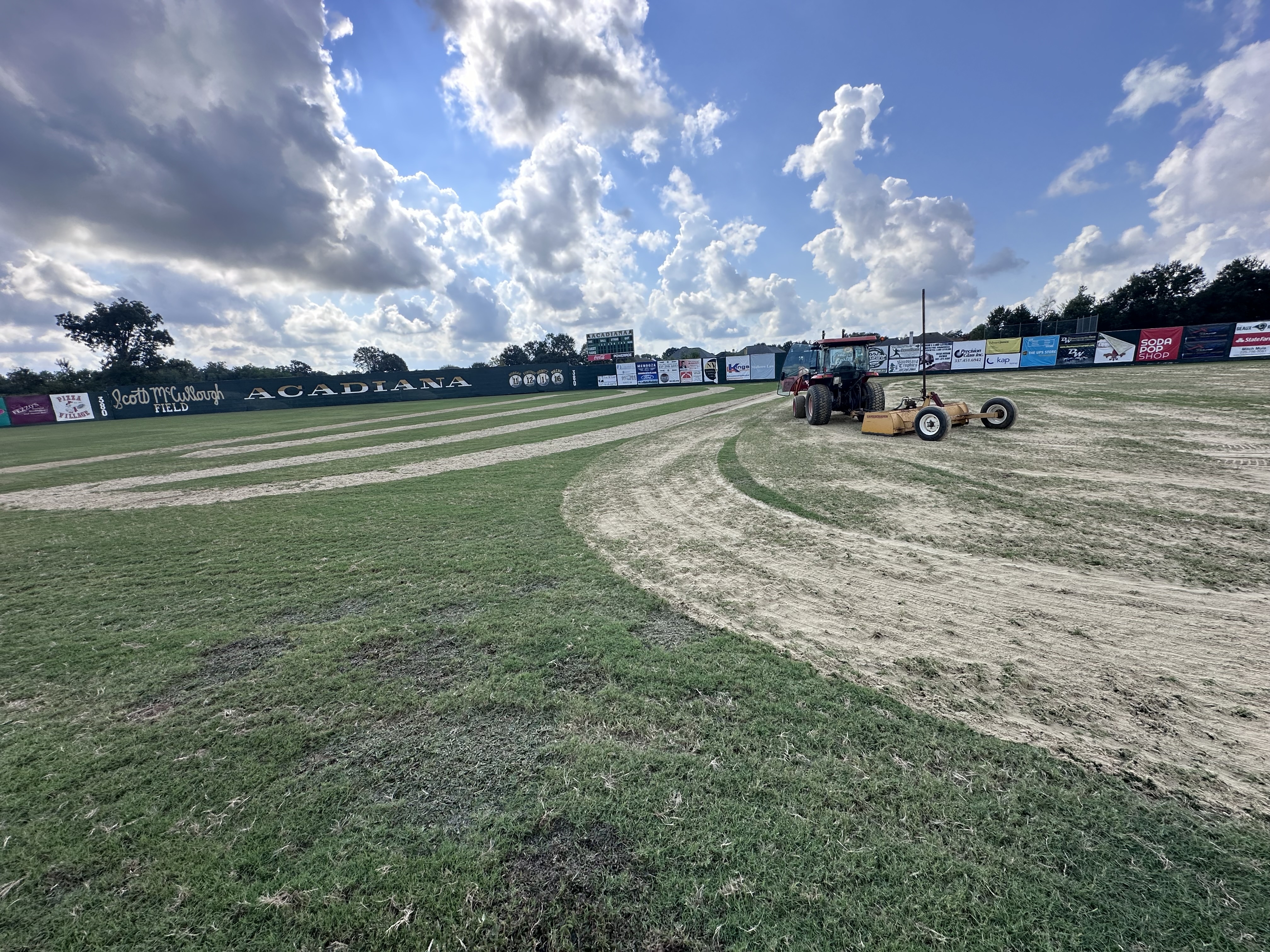

Another infield renovation today. We added 2 loads of infield clay mix, then laser graded it, then tilled is and laser graded it again.

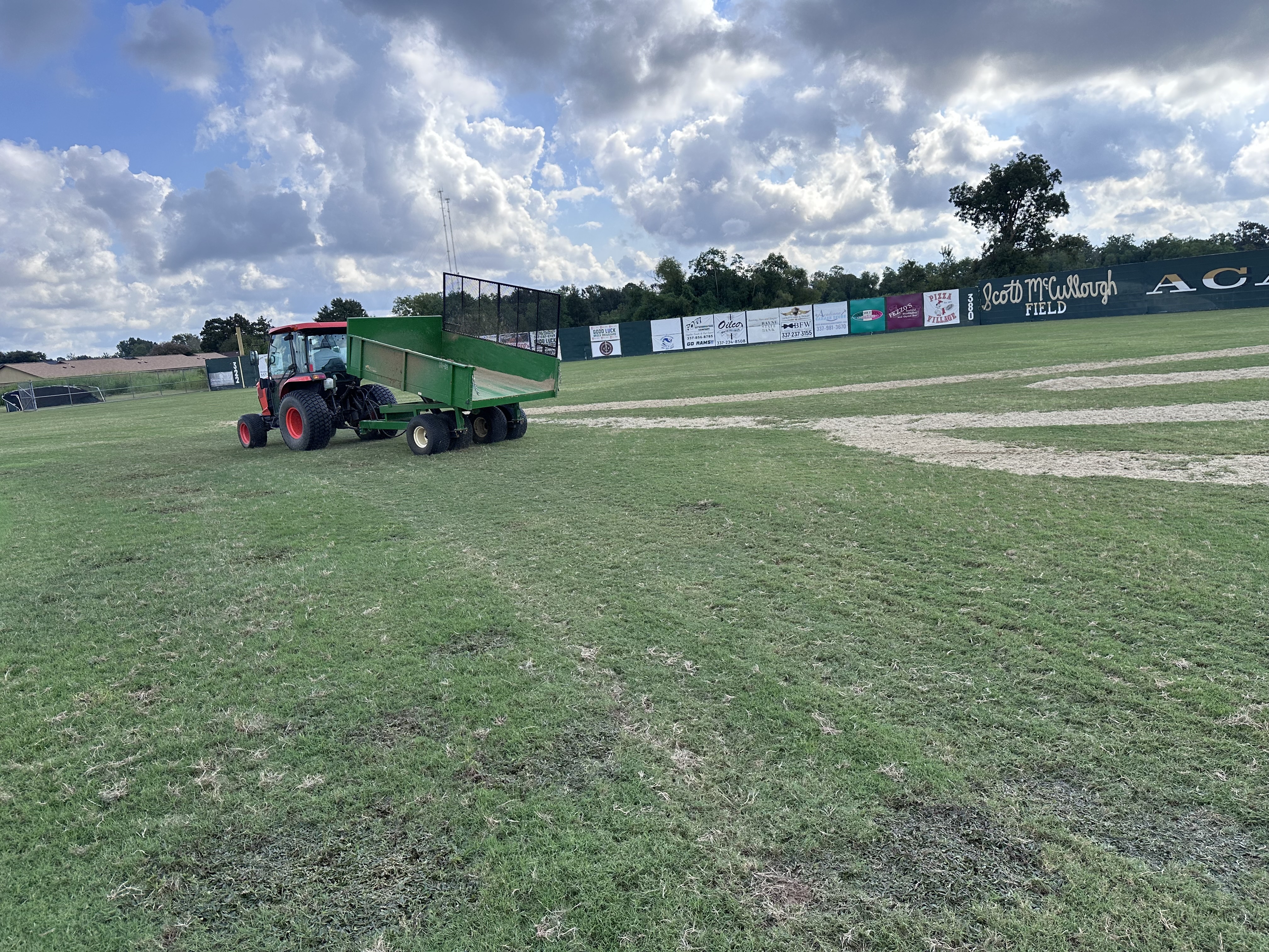

On this softball field, we added 60 yards of topsoil to try to reduce the steep elevation change in the outfield. We had done the same thing a couple years ago, but closer to the skinned area. After smoothing the new soil, I added some Bermuda seed. We have 5 days of rain starting today, so that should help the seed get going.

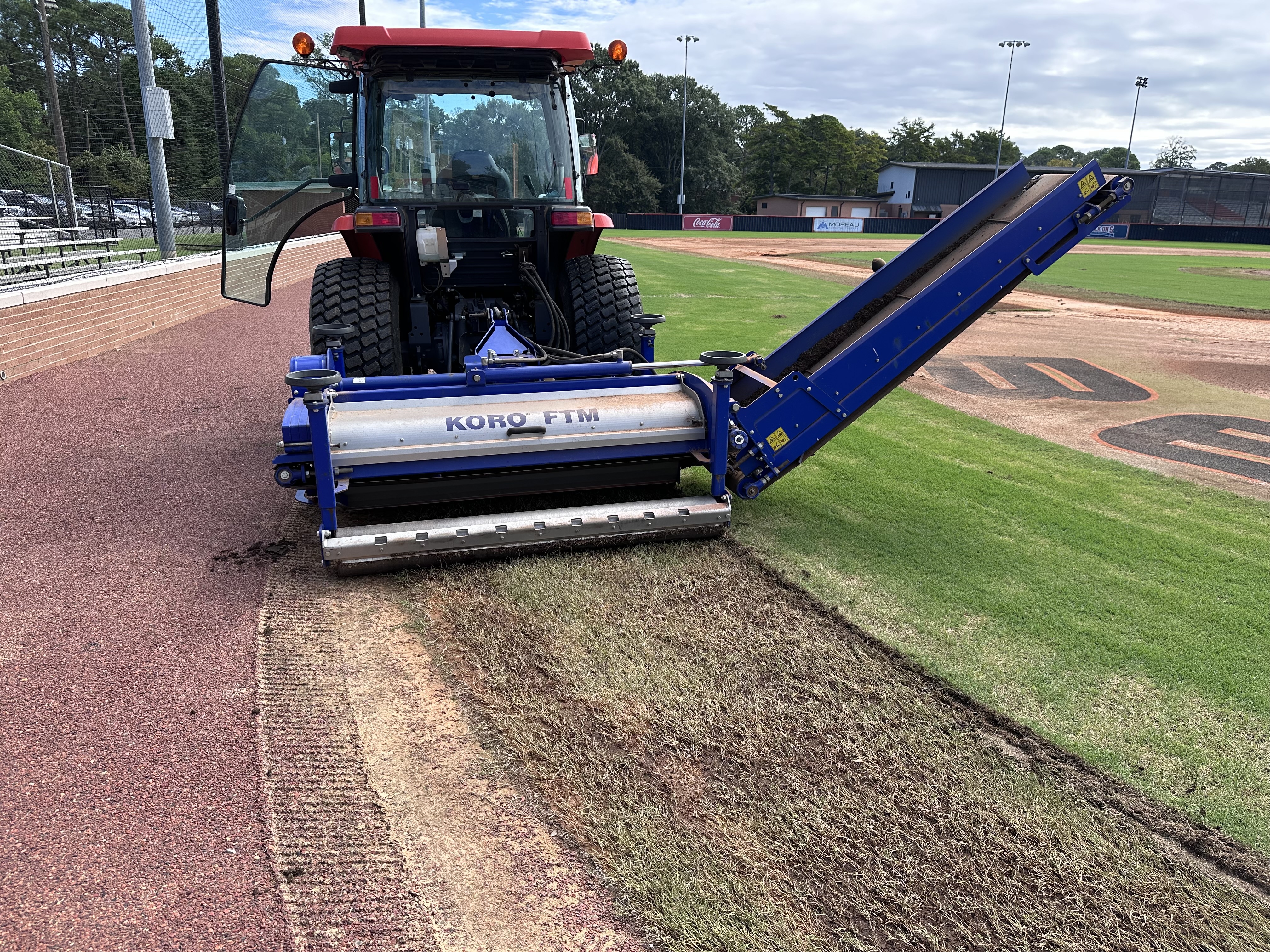

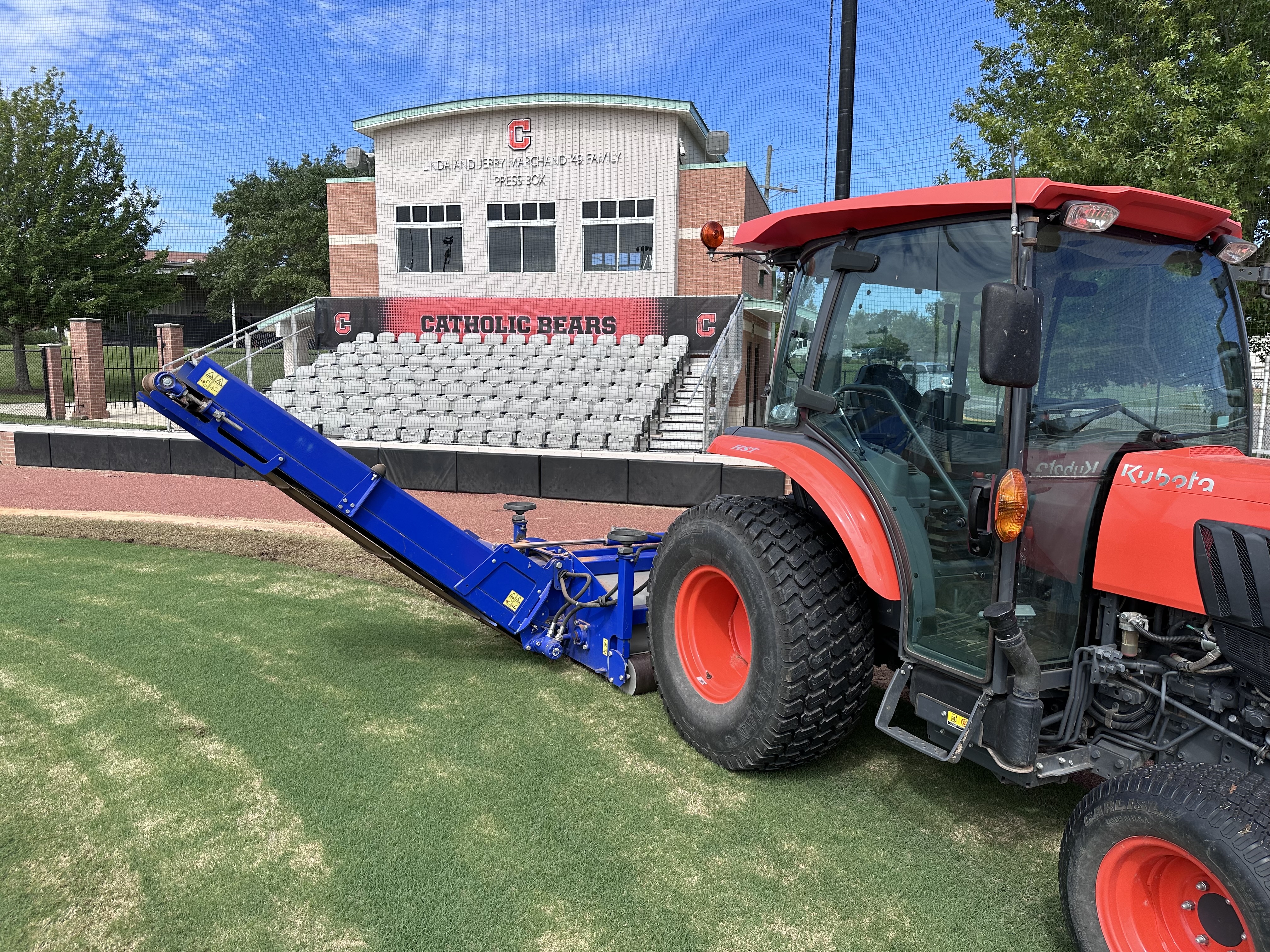

More lip removal yesterday at one of the largest private schools in the state which is in Baton Rouge. We were planning to do another field today, but decided to stay home and prepare for Francine.

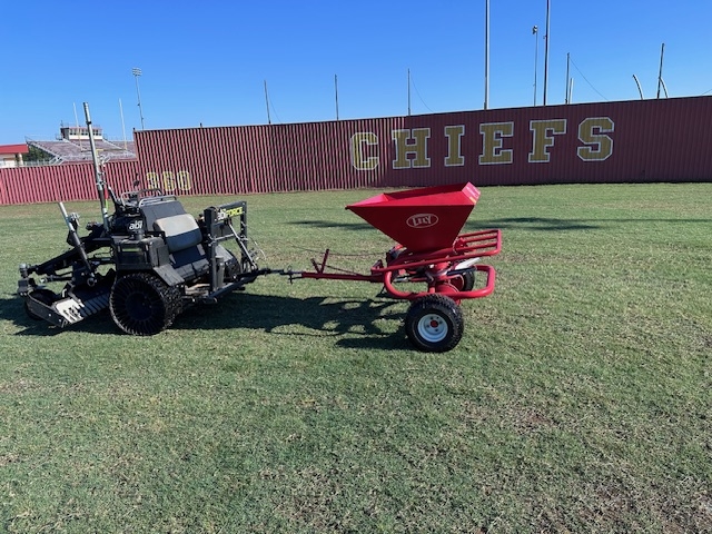

Today we dumped 5 loads of mason sand then spread it with the blade on a baseball field. We did it with the blade instead
of the spreader because they had some small ripples in the outfield that we wanted to fill in.
Yesterday we aerated 3 fields
