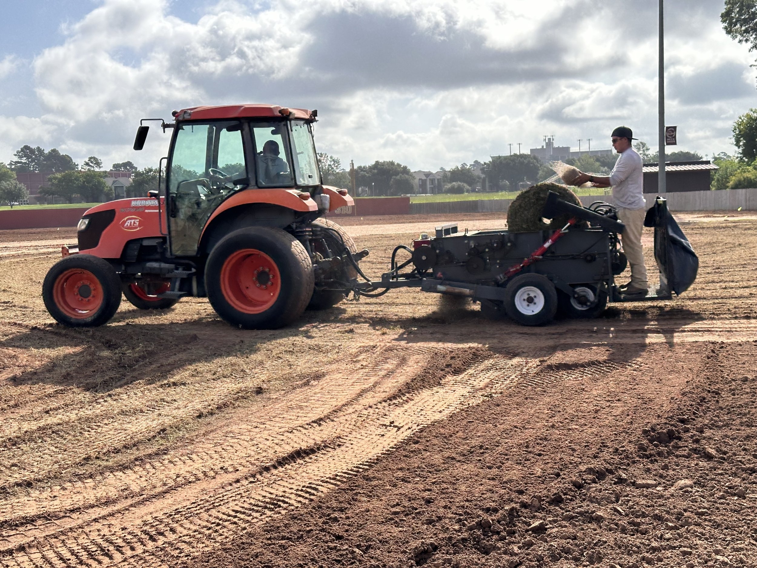

We finally got the baseball field sprigged (planted) today. We used 52 big rolls of Celebration Bermuda grass

Another pic of the sprigging machine. This was taken as they were getting started on the infield. This is not my equipment. It’s better for me to subcontract this part of the process.

It’s not hay. It’s sod. You can see one of the rolls in the sprigging machine in that last pic.
The sod farm delivered it with 2 - 18 wheelers.
We used 2 loads to sprig this field and it should be ready in about 90 days. If we would have sodded it, we would have needed about 12 loads, but it would have been ready in 3-4 weeks. Sod would have added about $50-60,000 to the job.

This method is the same thing....only different.
You are correct. That is how it is done most of the time for hay pastures. I've used that method 40+ years ago, at a farm I managed for a university.
For athletic fields, this 'sod to sprigs' method is much more effective. We can not take a chance on rain, because the sprigs must grow quickly so that the field can be used for the next season. I have been on a couple of jobs where the irrigation system did not provide full coverage, and some areas had to be re-planted.
And, it's not just any bermuda grass that is used for athletic fields. This variety, known as Celebration, was developed mainly for athletic fields. It is the only variety I use on athletic fields and is on hundreds of fields, including LSU's Tiger Stadium.

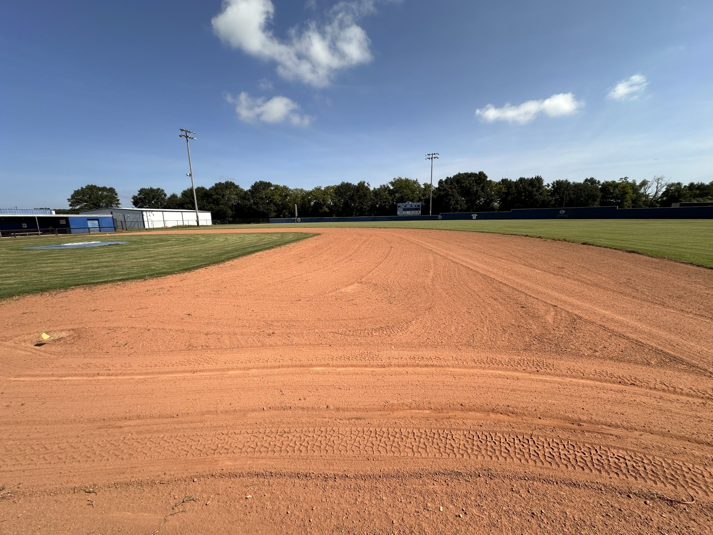

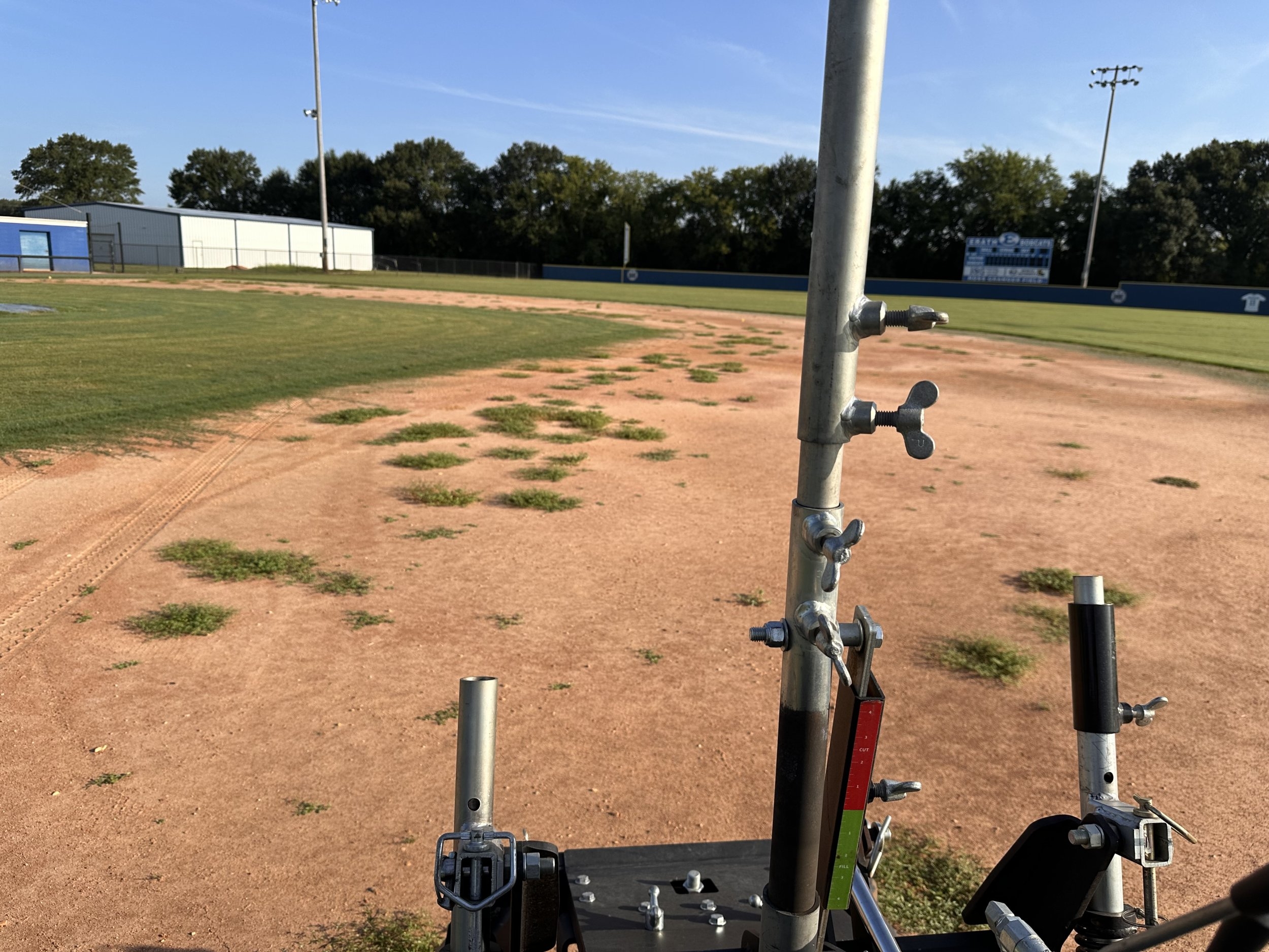

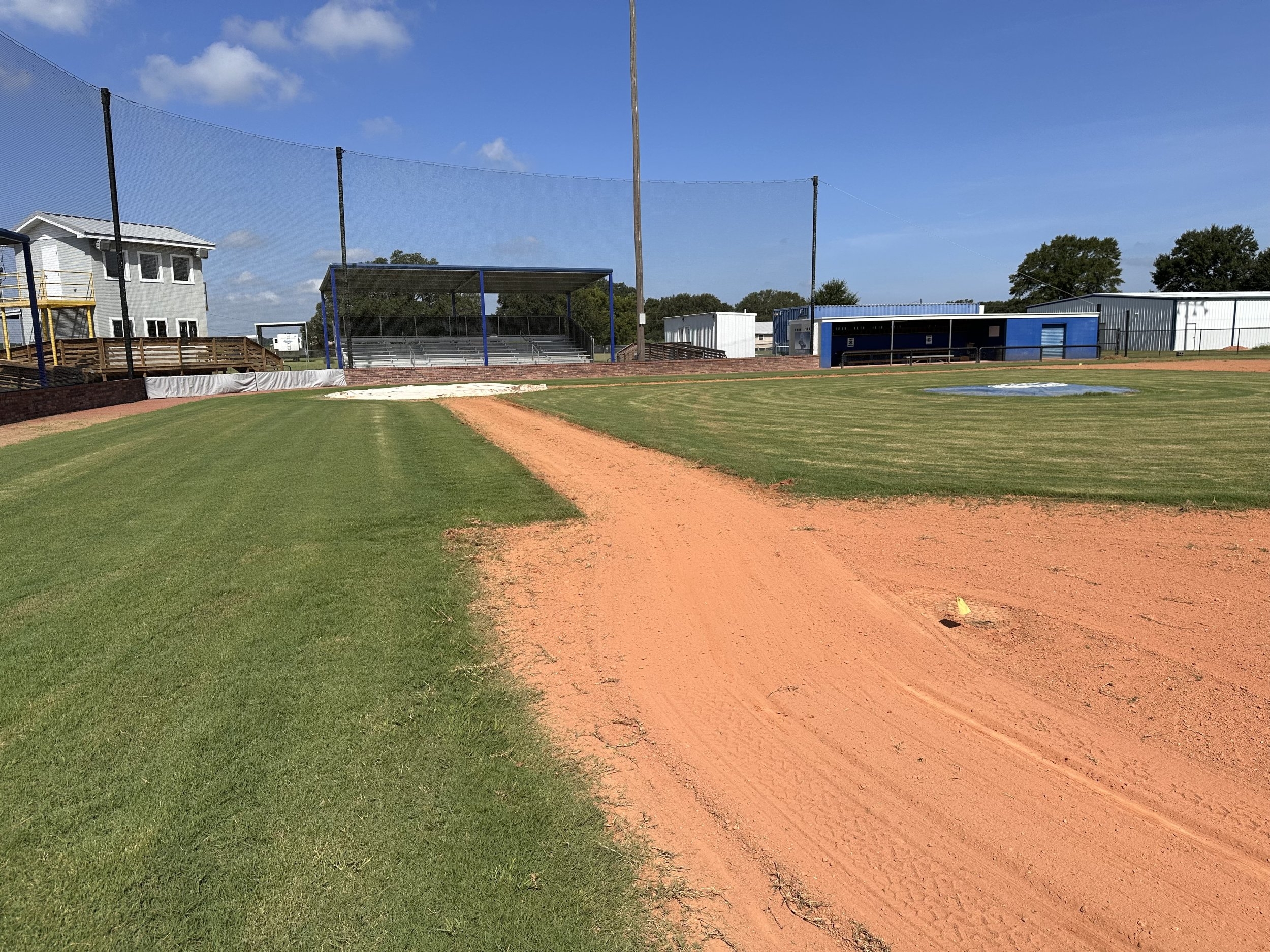

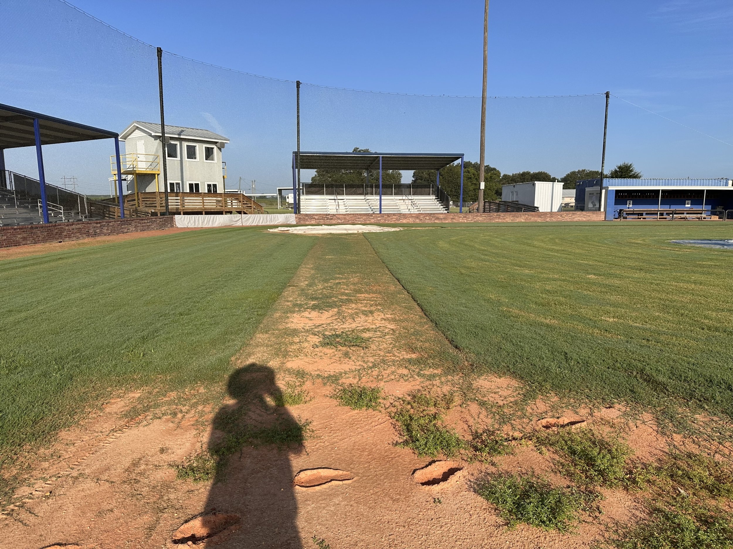

This was a quick cleanup of the infield with the ABI Force machine. Some before and after pics.
