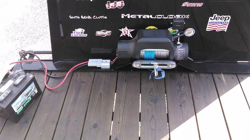

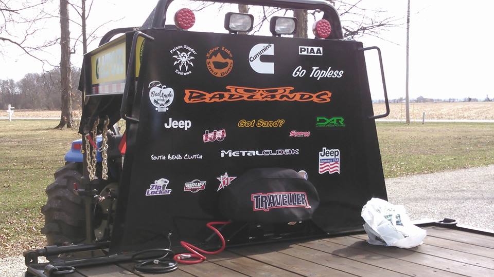

Here's my setup. The winch is one from tractor supply. Kind of fell into that one. I usually check out their clearance section, saw this sitting in the bottom of the shelf. Regularly 380 something and on clearance for $130!!! Couldn't say no to That! It's a 8,000lb with synthetic line. Winch cradle is a simple curt one. I could have made one but buying was a little easier lol. As for the trailer mounts, it's 3/8 plate cut with my plasma then bent on my press brake to make it pretty and work well. I also got a $25 wireless remote for the winch. The whole setup works absolutely amazing and I couldn't be happier. I like the winch up higher than the deck so when I'm pulling from something low, like a car, the line does not rub on the deck. I know this is a different set up than your trailer but I hope this helps! Good luck! P.s. I also made the cone holder :)

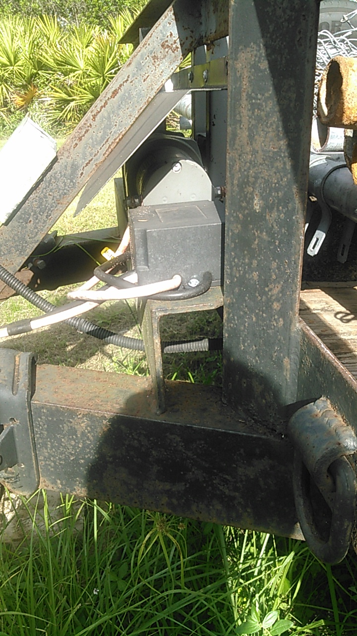

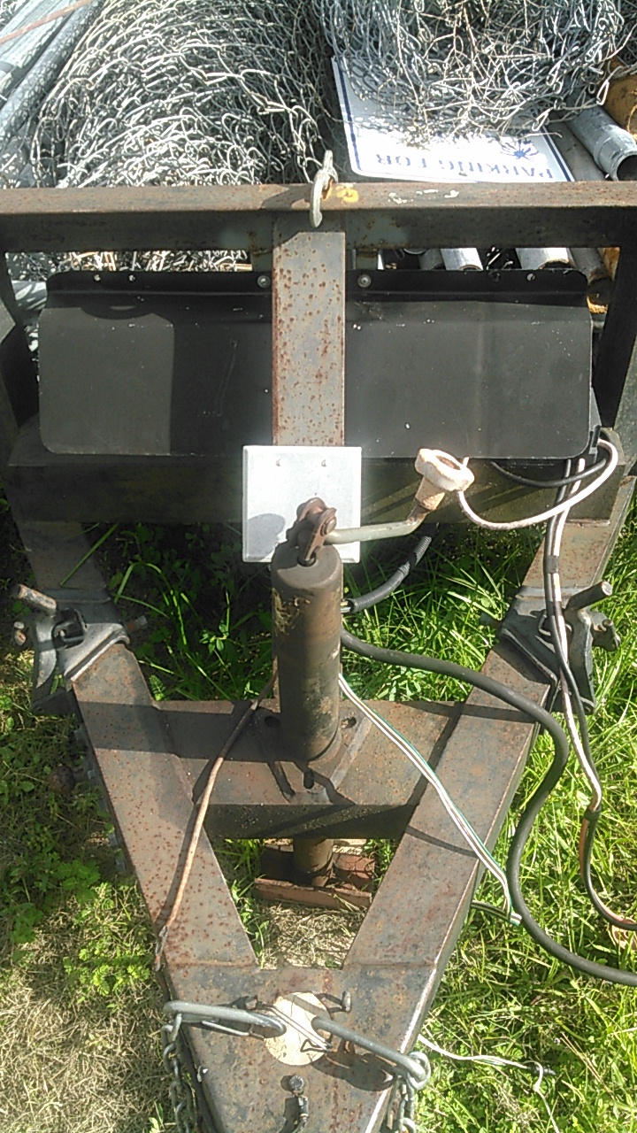

Made a bridge mounting plate so I could keep my center d ring. also tied the top of the mounting plate into the spine on the front side of the gooseneck upright.
