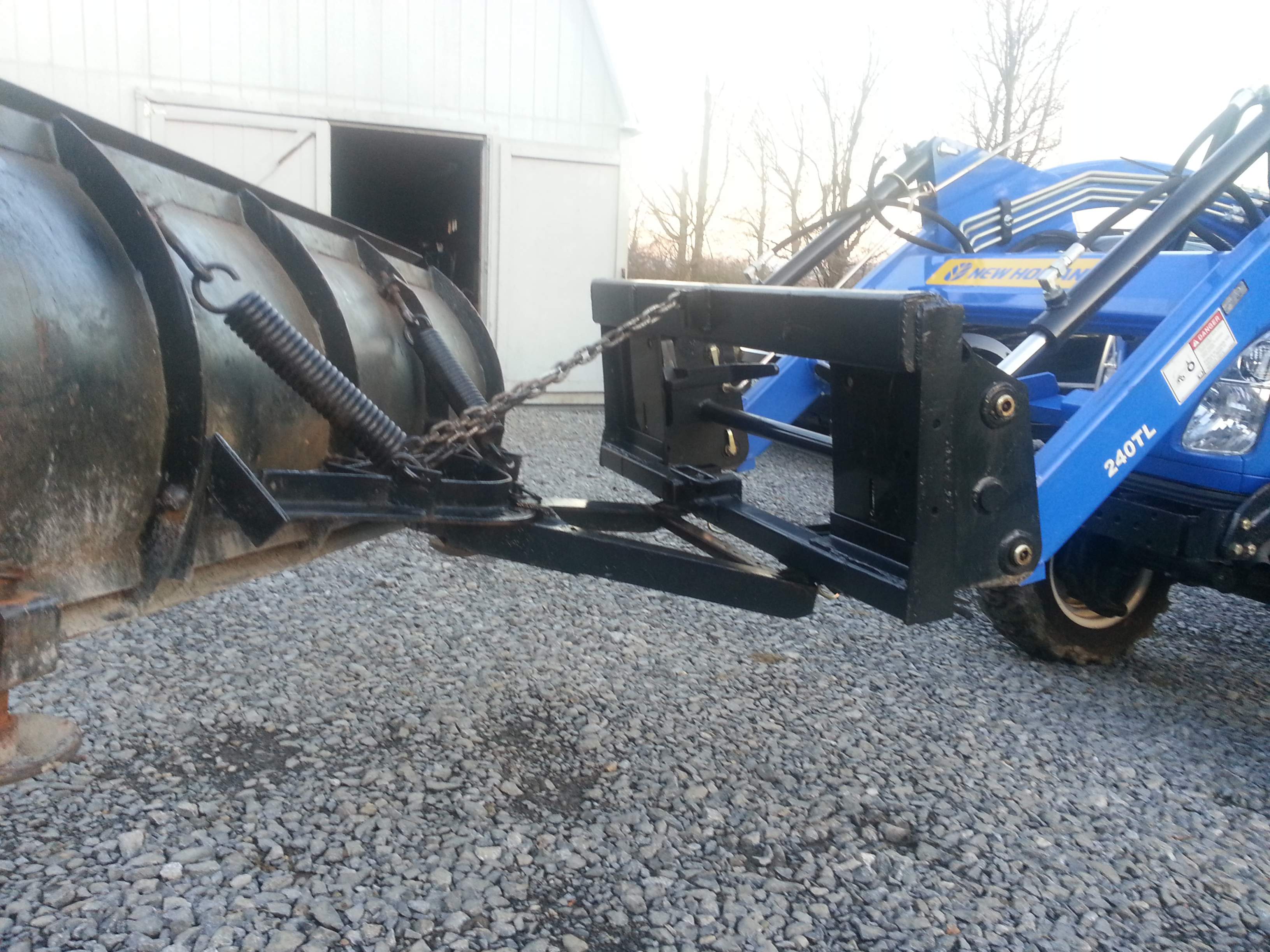

Hello , this is a quick attach plate I made from a truck bumper and a u haul hitch receiver might be alittle over kill lol , but hey its what I had on hand plus I can use a trailer hitch as well. Also making a wooden template using the bucket attachment gave me the spacing and angles. The good old chop saw , I forgot how long it takes to grind thru thick metal , you could eat your lunch while waiting lol btw my first post:D 11.18.2012 116.jpg11.18.2012 117.jpg11.18.2012 132.jpg11.18.2012 135.jpg11.18.2012 137.jpg

Welcome to TBN.:welcome:.....With your kind of skill, your will be quite popular here. Cheers..........Mike
