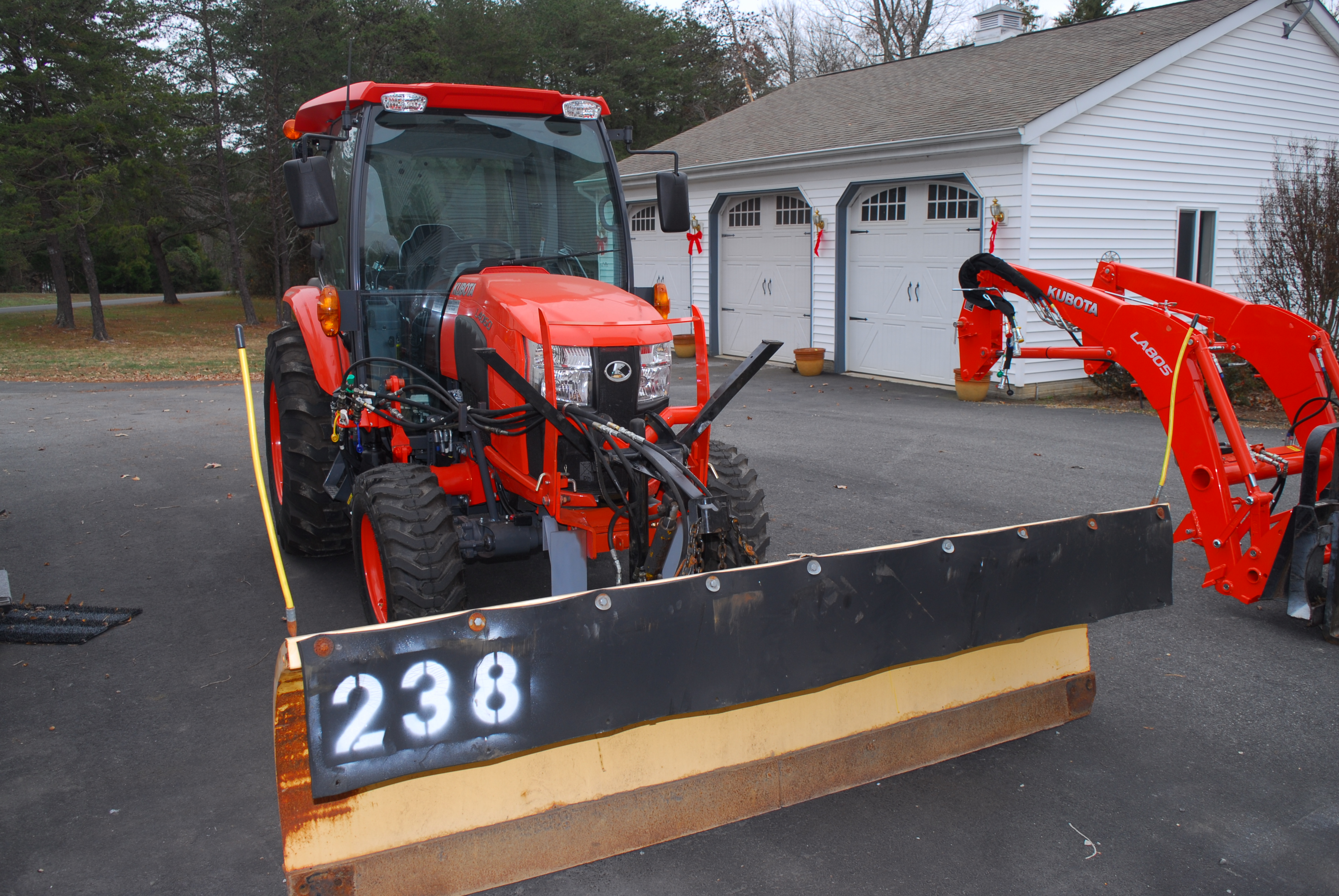

Got a 1" thick by 10" wide rubber strip for my front snow blade. Bolted it on to see if it would help cut down on digging into the gravel driveway.
Put the loader on float and gave it a go. Worked pretty well. It left a thin layer of snow over the gravel and didn't dig in as the rubber edge folded back and just slid over the snow and gravel. You could probably see the gravel in the snow on the edge of the driveway that the steel edge had dug out in the last snowfall.

I was thinking about cutting a section of a horse mat for the same reason and bolting it to my rear blade and or FEL to make it easier on the concrete and not dig in gravel, so far I haven't but we also haven't had much snow yet

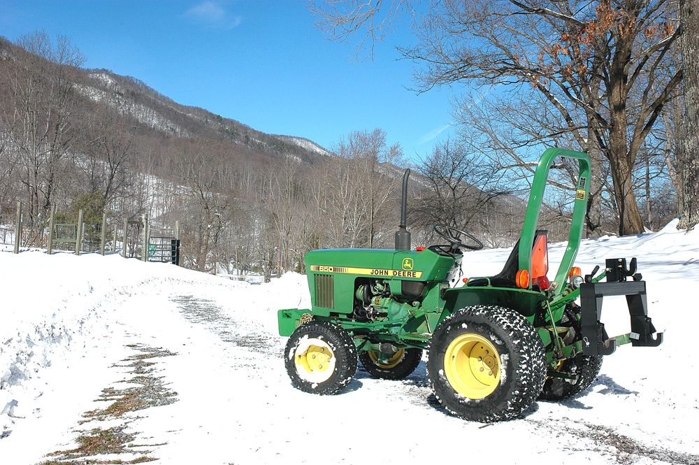

I have 4 wheel chains for this one,,, but, snow riding is MUCH more fun without the chains,,,
It would not push much snow, anyways,,, :confused2:

That is an excellent fit - what is your trick for install and snugging them up. I wanted to run mine that high for clearance, but they walked around to much - thus the spring tensioners - I have the same R4's I have better luck with the front as I can lift the tire off of the ground with the loader. Then I clip the inside S-hook and tighten everything from the bottom position as that is where all the slack ends up.
Don't know of any tricks.. I jack a wheel up, drape the chains over the top of tire, and then hook the inside fastener.
Then on the outside side chain, there are two loose links when tight.. so I just fasten to the last one, and pull the slack out by rotating the tire until I gain on those next two links.
Never have had a problem of walking out of them, as there is no slack. These chains were custom made by buying the side chain, the cross link chain, and the hooks. I wanted them to rest in the indent of the lugs at the outer edge of the tire so there would be adequate room on the fender side. Later I added 3" spacers, so now that needed room is not an issue.
