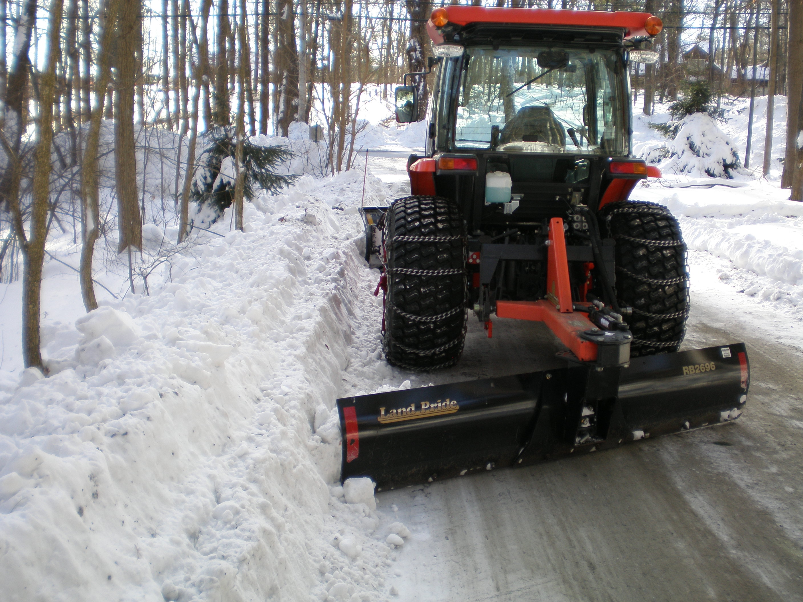

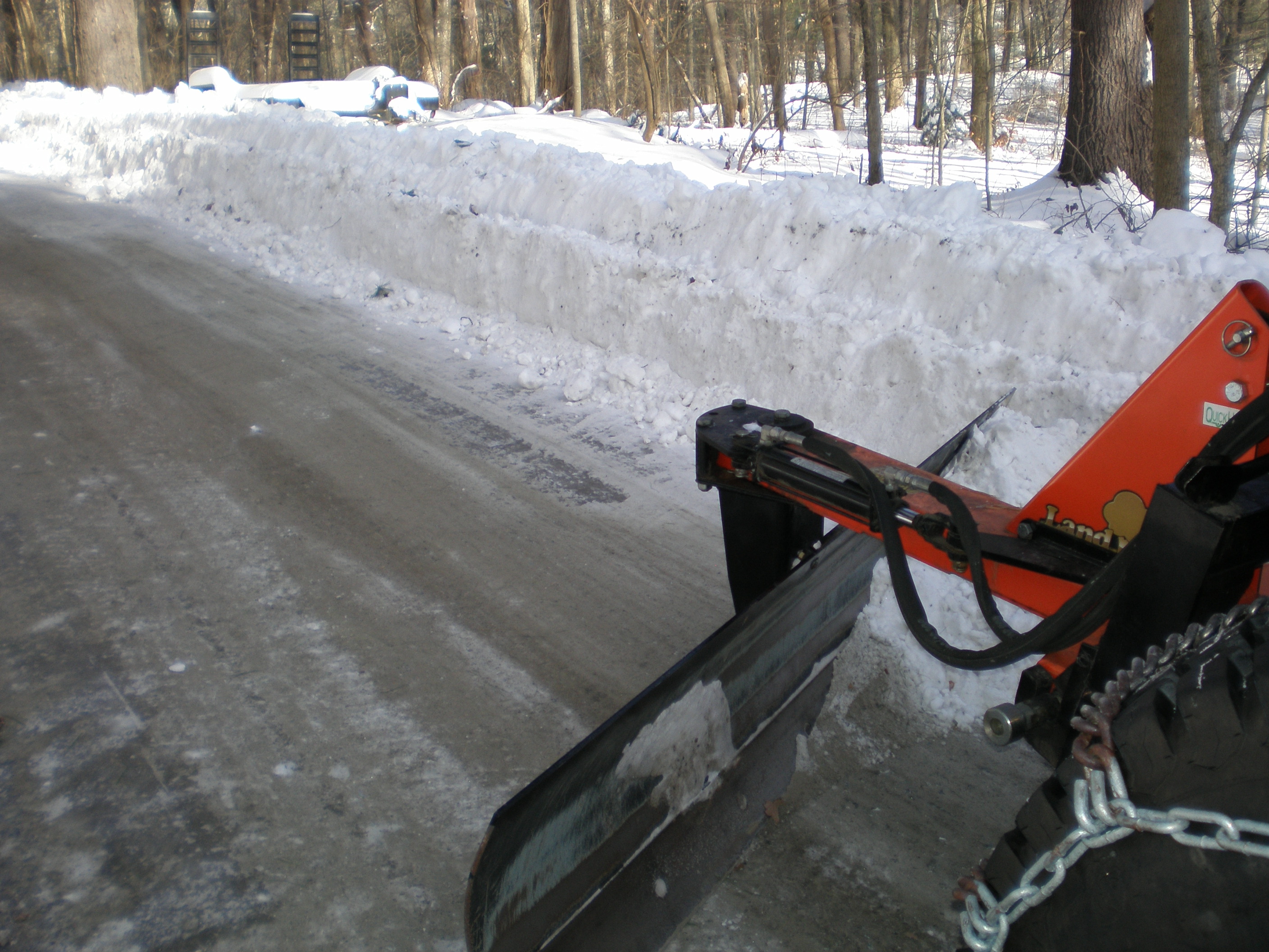

I've been thinking about a rear blower for mine, but for now, this is the first winter w/o my truck and plow and using my Kubota 100%. Works well with plow and grader blade, but even with chains on the rear the ice on the drive is tough. I ordered chains for the front but they haven't come in yet. I want to get thru this winter this way and think about a blower over the summer. I'm thinking WoodMaxx. I've heard good things about them.View attachment 534918View attachment 534919View attachment 534920
4-link ladder chains are a good choice for asphalt drives, since they're less likely to damage the asphalt. They're also the least expensive type of tire chain. I had 'em and liked them...but for a gravel or dirt drive, I think a more aggressive chain is the way to go.

I had those same style chains on my rear tires for the last few years, and would often have issues with traction even with the chains.
I was tired of spinning tires so I bought front and rear studded chains for this winter, and it made a HUGE difference. It痴 night and day difference with the places I can go now.
I do spin sometimes, but I think with the front chains it will help a lot. I hate dealing with chains, but without them in this snow and Ice cr*p I'd be going nowhere.

Roy, Like I said to piston, I only spin sometimes. My gravel drive is 1000' and the only time I have a problem is on my hill which is curved and very steep. I am very happy with my 4-link chains, just heavy and difficult for an old man to install without help. I jack up each wheel and roll the tire with the chain to wrap it around. They do work very well though and just waiting for my front chains to come in.

I HATE dealing with my chains, but struggle without them. They're ladders, but with the V-bars. They're mean. $700 for the set hurt awful bad too. But it's the kind of thing you do only once.

The studded euro style chains are amazing, until people use them they just do not fathom the extreme difference they make, on top of that I do believe that they would be easier on on paved driveway because they do not slip. My driveway is gravel and steep but I do travel on some pavement at times and we have them on two of the farm tractors that get a lot of road miles feeding cows and they don't mark up the pavement like the bar reinforced street chains did and they seem to be wearing better. I know my first set is several years old now and they haven't required repairing yet, where as my conventional 4 link and two links started needing repair links by their third or forth year.
