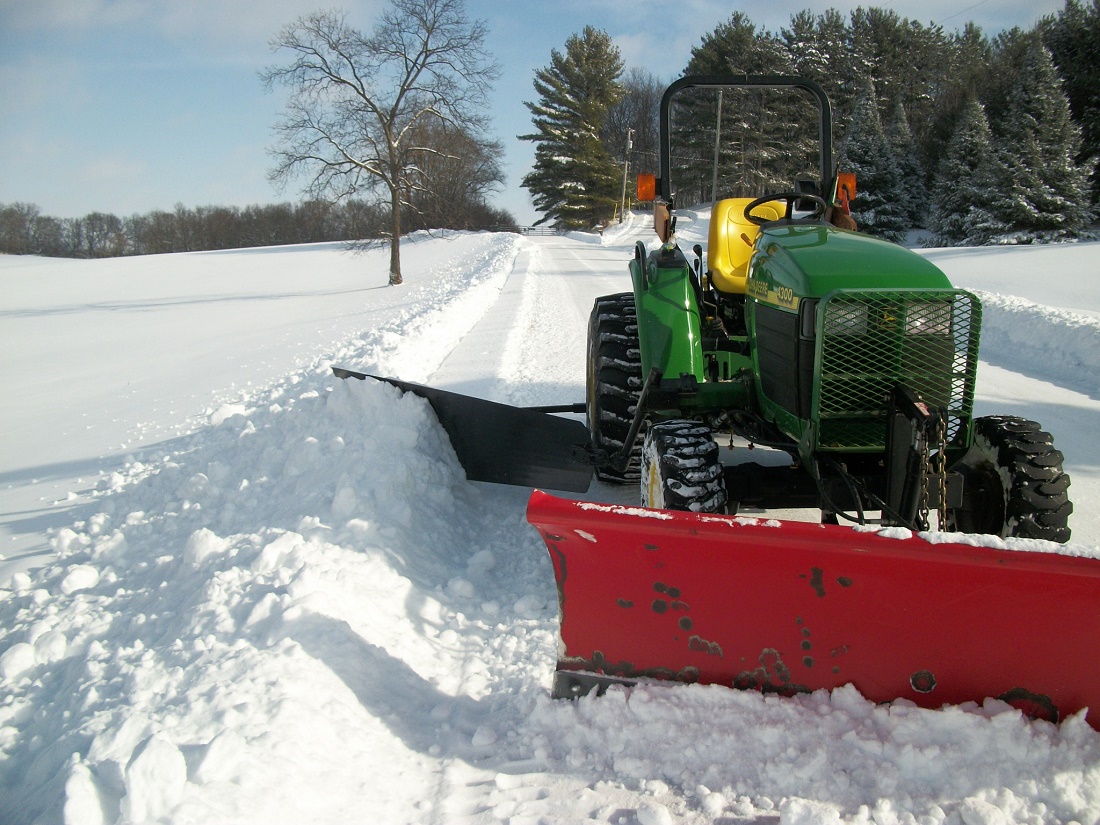

Enough snow to put the wing on today.. works great.. safer to stay away from the ditch drop-off and knock the berm off for a shelf when snow blows.. temps to drop to -18F tomorrow, with high winds.. I may just go out into that field and plow a berm up to help stop some of that blowing snow coming onto the road. Acts as a pretty good snow fence.

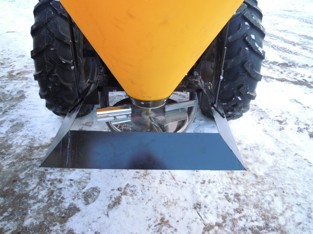

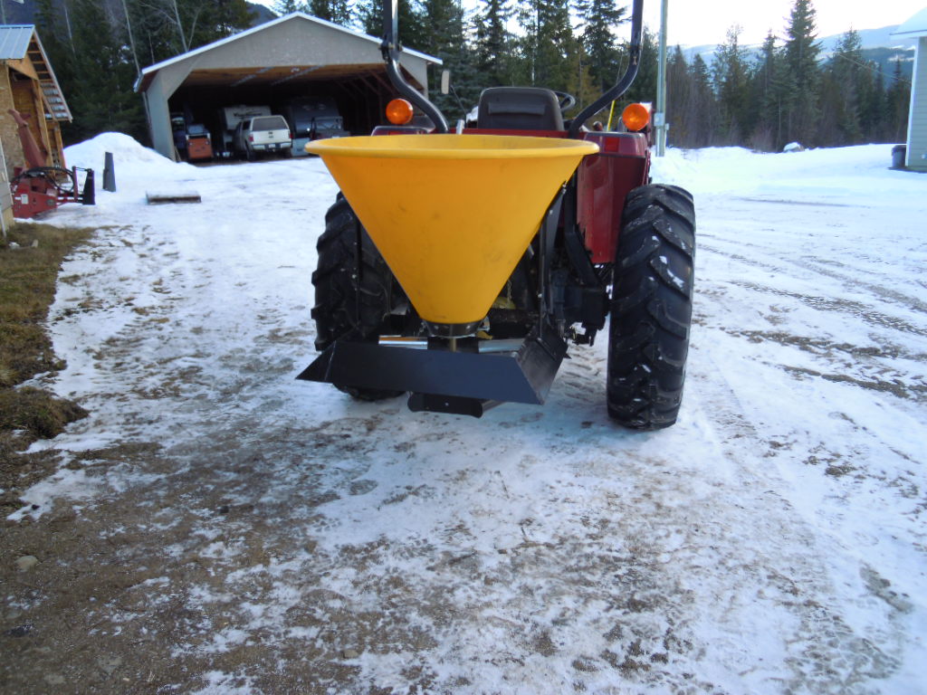

Not really a snow weapon but it sure works well on ice. With the warmer weather this year we've been getting a lot of freeze thaw cycles and the driveway has become a very long ice rink. Not bad if it's flat but that's only true for the upper 1/4 mile or so. Then for the next 3/4 mile it ranges from 10% to 15% and that gets scary on ice, especially when there is a steep drop off one side. This has been the worst since moving here 10 years ago. So I finally broke down and got a spreader but found it would throw the sand too far and would clog up with the wet salt / sand mix available at the nearest gravel pit. So I ended up making a taller, wider agitator for the inside and an adjustable shroud to narrow the spread. Works great now.

Nice concept and workmanship!

I don't know why they don't make those things so that sand flows reliably instead of tending to bridge the opening. Your modified agitator and adjustable deflector are great ideas. How do you keep your sand dry enough so the pile doesn't freeze ?? And how many trips does it take for the 3/4 mile hilly part ? Thanks.

I only got this a few days ago and have used it twice so far. So not a lot of experience yet. The top of my modified agitator is 12" wide and the salt /sand mixture will still bridge that because it is wet but not until about half of the sand is used (maybe more). Then I just use a stick to push the rest down. The sand I'm using now is not dry but next season I will have dry sand. I will get some this summer and after making sure it is dry I will store it in sealed 55 gallon drums or in a large bag, on a pallet and keep it under cover. With dry sand the larger agitator won't be needed. I know this because I dried some sand out, just to see the difference.
I'm not sure how many trips it would take to do the steep section of the driveway since I've only done the worst sections so far and I haven't done any real sanding since I made the shroud. Just a test run to see how it performed. Without the shroud, a lot of sand was wasted because it was thrown off the sides of the drive. With the shroud on I can keep the spreading width narrower and therefore use less. I'd guess 2 trips if I spread the sand lightly and 4 if I put a lot on. Once I get some more experience I will have a better idea and can figure out how much sand to stockpile for next season. I just got 4 yards of salt/sand dropped off and it's sitting on a tarp with another tarp covering it. The salt keeps the sand in a fluid state. I got some straight sand for a trial run when I picked up the spreader and it froze into a solid lump overnight. Good thing I didn't have it in the spreader. It was only a wheelbarrow load and I put it in the heated shop to thaw it out and made sure to use it all before storing the tractor. I also cleaned the spreader real well before storing it.
