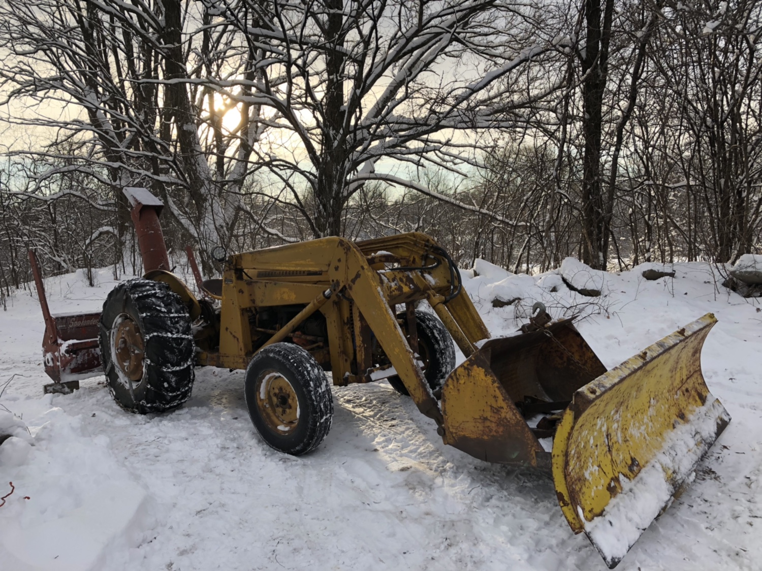

Heh, I'd love a cabbed tractor. I can build a cab for mine pretty easily, I've got all sorts of fabrication equipment. The problem is time. Always time! Ideally, I'd like to get a 4x4 tractor.
It was about 6ー this morning and we got a fresh 12", lucky we had zero wind. I did a proper tuneup on the tractor over the weekend, figured out my hard start issue, and my crappy running issue. I had my tractor wired that in order to start it, you had to pull a kill switch out (think oldschool light switch from a truck), and turn the key. Either the key OR the kill switch would turn the tractor off. It was a kind of "emergency" thing, in case I needed to kill it I could just slap that switch without fumbling the key..
Well, it turns out that BOTH the keyswitch and the pull switch/killswitch were faulty! I'd sometimes get spark, sometimes not! Replaced keyswitch with the original push-button start, and the killswitch with a random on/off switch I had laying around. Turn on gas, pull choke, flip switch, press button, FIRE!
I pulled all four plugs, one was way fouled, the other three weren't far behind. Replaced with some Autolite 3116 gapped at .050, runs like a dream. I readjusted the carb, idle, power jet, and governor. No more bogging. Greased everything up and hoped I'd be ready for this storm.

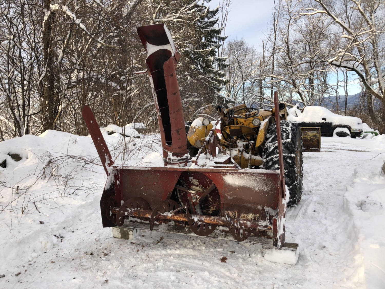

And I used the blower almost exclusively. 12" of fresh powder, moved it like a dream. Definitely need to fabricate a paddle kit for it, there's a good 3/16-1/4" gap between the fan blades and the housing. Losing a lot of snow through that, as well as some distance. It'll still throw most of the snow 10-15', but a decent chunk of it just drops out the chute. The paddle kit will help with that. I may eventually fabricate a whole new 4-blade fan for it to replace the factory 3-blade.
Yep! I definitely need to replace that PVC with a steel pipe. I don't know what I'm waiting for! I can cut a slit in the pipe no problem, it'll take 10 minutes! Just procrastinating! I think I'm a glutton for punishment. I still need to convert my machine to SSQA. I already have the kit to do it, again, just no time to actually do it. Once I do that, it'll be real easy to fabricate a mount for the plow to SSQA plate. I've even got an extra set of spool valves to power the plow's left/right angle. Hoping to install that this coming summer, too. I see your frustration, it gets to ya after a while!
Also forgot to mention, my machine leaks oil out the rear main seal like a seive! Need to split it to replace that. Lastly, I'll jump on my phone quick and attach a few pics since I didn't last time.
View attachment 589472View attachment 589473

I have a plasma cutter, makes splitting the pipe a ten minute affair. :) welding a few tabs on it to secure (if needed) is only a few more minutes.
The angle iron sounds like it could work well, too. I’m trying to avoid the sharp edge altogether though.
