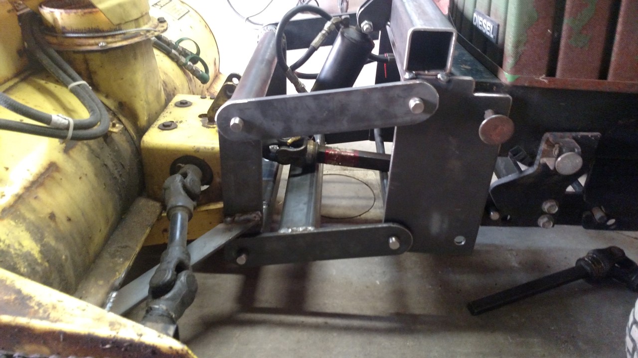

I just finished refurbishing a 47" single stage John Deere blower that was originally for an 855 compact tractor, I think.
I fabricated a new parallelogram type mount to attach it to my JD 430, then had it all blasted and powder coated JD yellow.
Put new bearings on the auger shaft, checked and lubed all the u-joints, and install new warning decals.
Looks much better now.

How tricky was fabbing up the drive mechanism?
   / Pictures of your snow weapons #5,574
Actually, gearbox on the blower is in the center, so it lines up with the PTO on the tractor. The mount keeps both u-joints on the PTO shaft running at the same angle, so it runs very smoothly. I did have to make a relief cut in the lower cross brace on the tractor mount and in the cross tube on the lower linkage, but only because I didn't plan the position of the linkage low enough. It only gets close when the blower is lowered all the way down to push the front of the tractor off the ground. So, it really isn't a problem.
The previous mount simply pivoted the blower up and down and put the u-joint in a pretty bad angle when the blower was raised up. I would have to replace the u-joint every couple of years.

I like the parallelogram linkages. Did you have to modify the PTO Length?
Can't wait to see a video of it in action.
   / Pictures of your snow weapons #5,580
The parallelogram mount keeps the u-joint angles correct when the blower is raised and lowered. The original JD blower mounts are this type.
No, the length was very nearly the same as with the previous setup. Besides, the PTO shaft is a universal type that is rectangular tube and bar, and could compress a few inches or extend almost a foot and still work. The original shaft that was made for it was a splined shaft that had been shortened or lengthened at one time and was seriously out of true, and would vibrate quite a bit. I bought the new shaft at Tractor Supply and shortened it up to work.
If we get enough snow this year to use it, I'll have to post a video of it in action.
