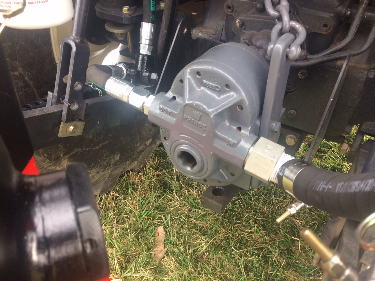

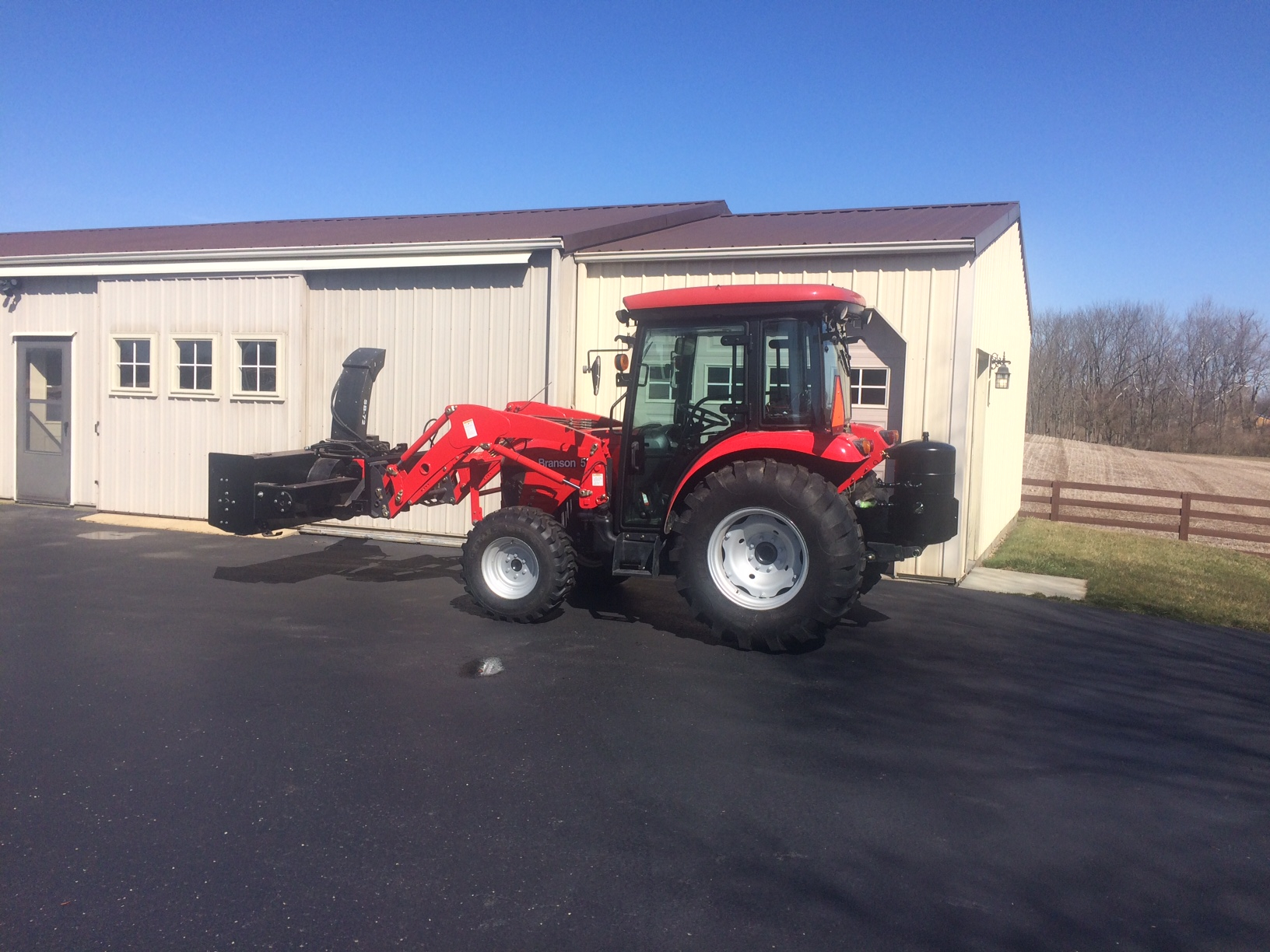

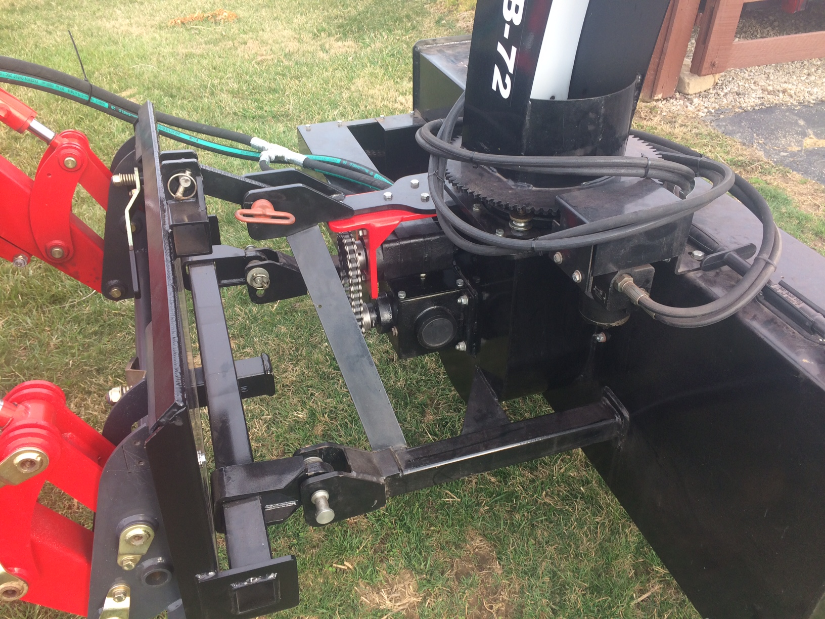

Snowblower on the front...hyd. Driven gear pump

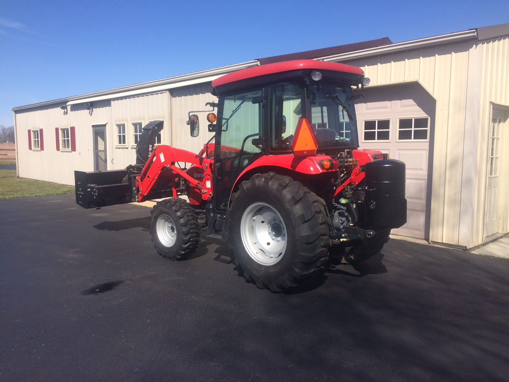

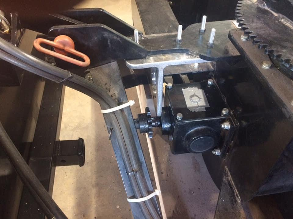

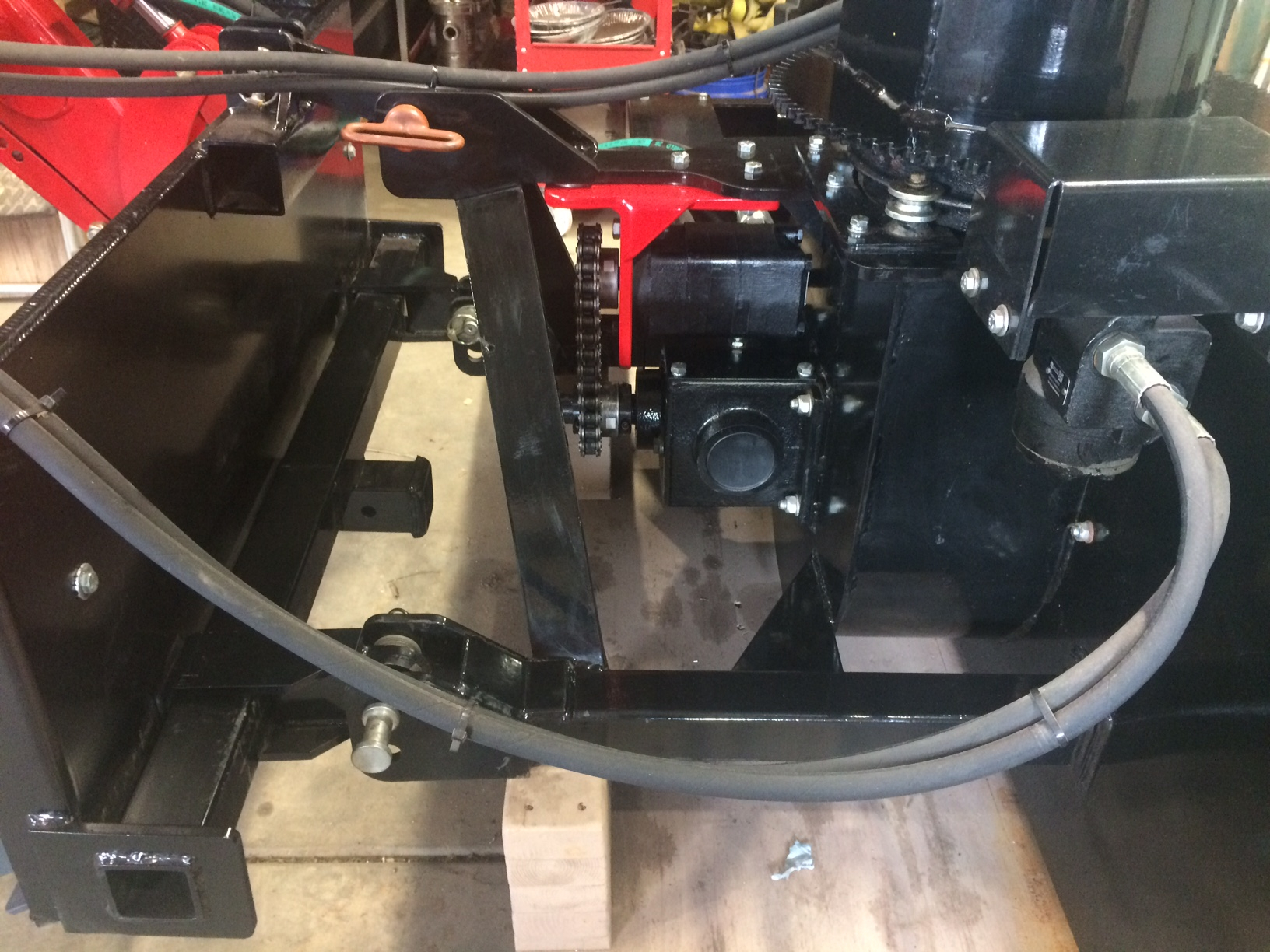

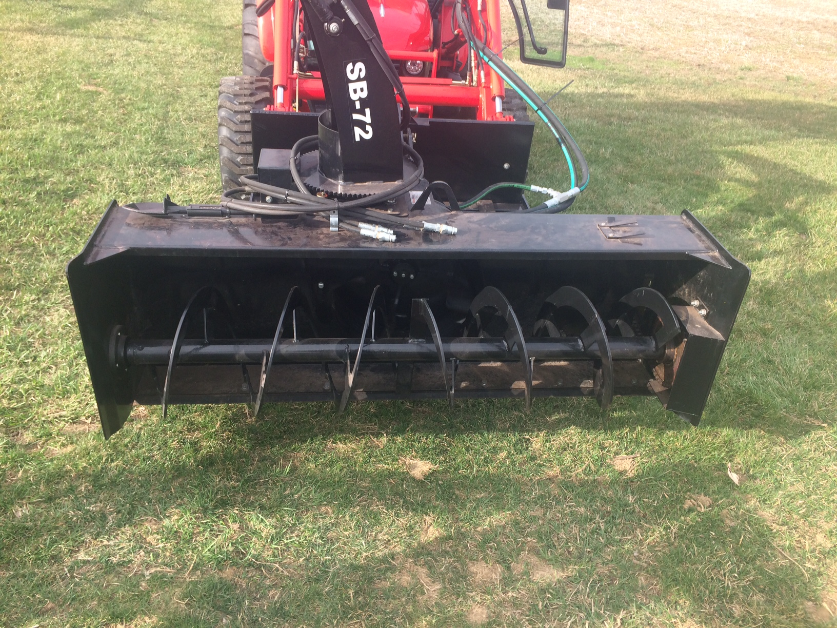

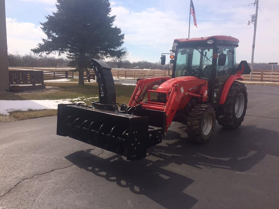

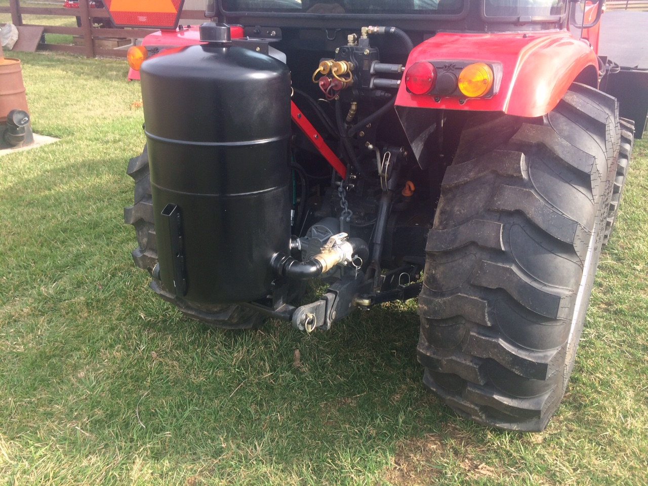

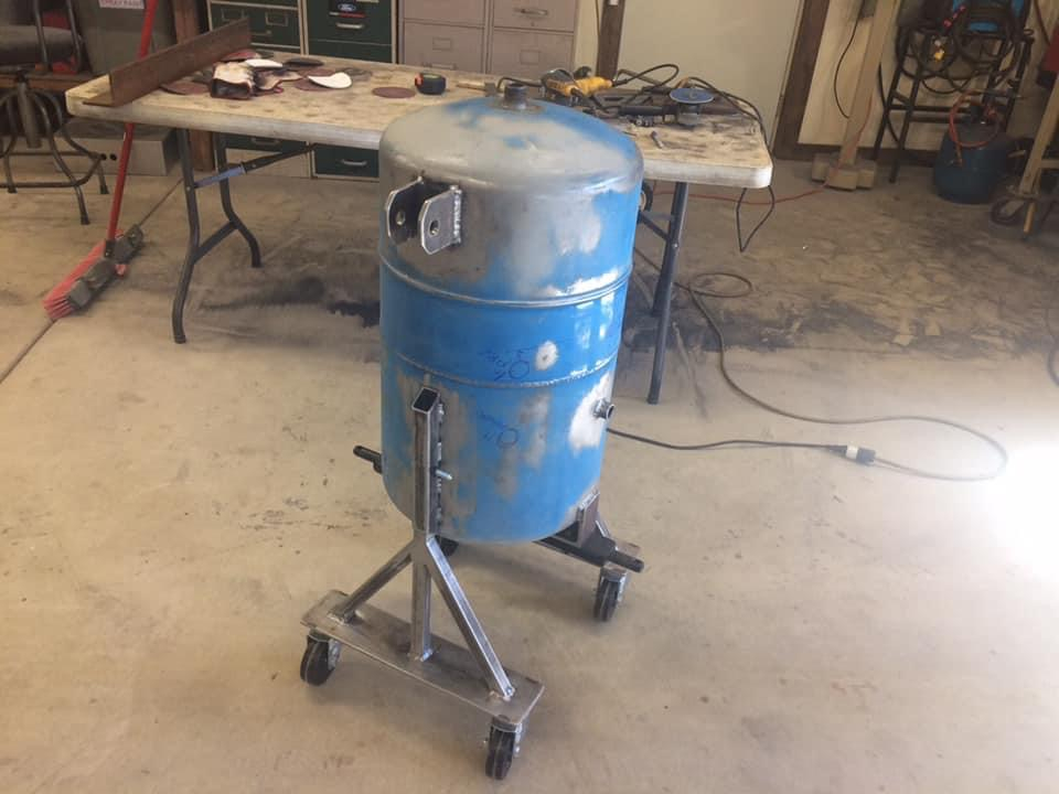

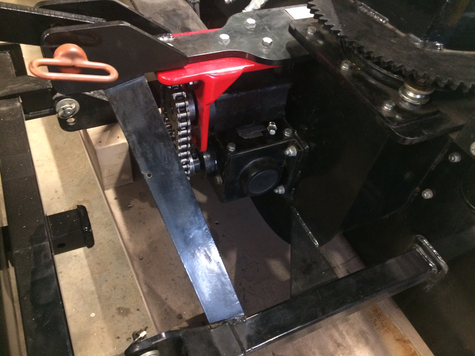

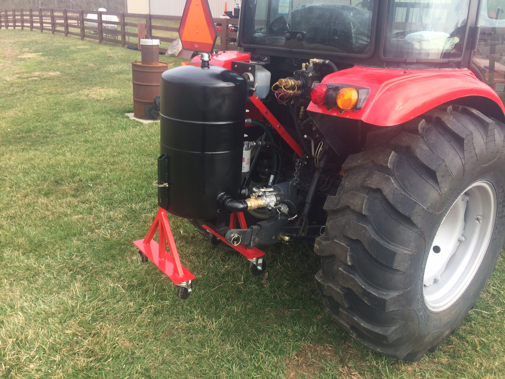

I converted a rear mount, PTO driven, to a front mount hyd motor driven,...using a PTO pump.

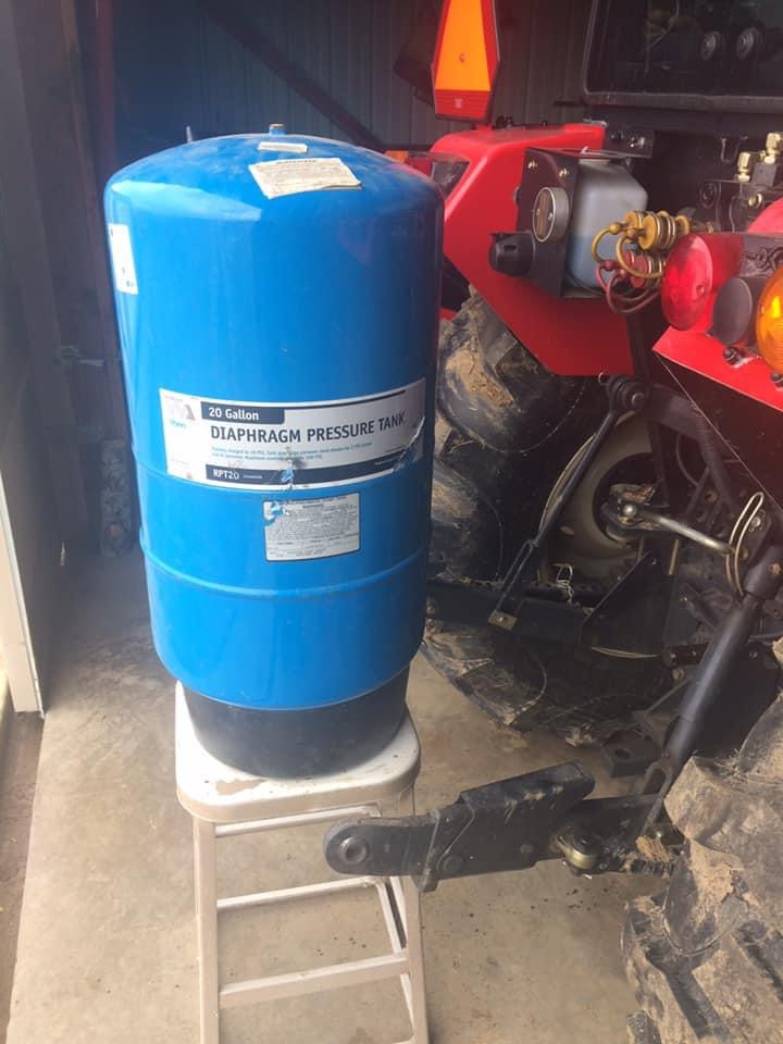

...converted a 20 gallon, Well water pressure tank ( yes I removed the rubber bladder) to a hydraulic tank.
works great!

Nice work! I really like your valve/camlock setup!
You're going to love the loader mount blower! :)

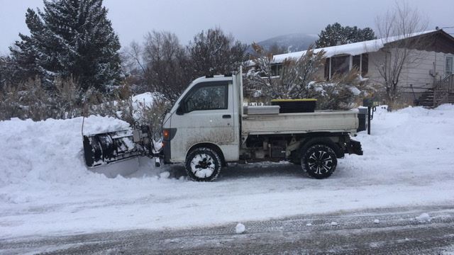

Interesting. It looks a little bit underweight, but I bet an enterprising person (like most of us...) could find a way to mount that to a front end loader...
It is much too light and lacks power.

I wish my 6' loader mounted blower was lighter so that it would float a little better.
It looks like a Prince pump (or very similar). I use a 21gpm Prince pump and it is plenty of flow. I don't have the hydraulic motor sizes handy, but with 21gpm I'd swap them out for larger motors to gain torque and slow auger and the fan speed down a bit.
I used a 38hp tractor for years and it was fine. (Although my current 66hp tractor with cab sure is nice in the winter! ;) )
