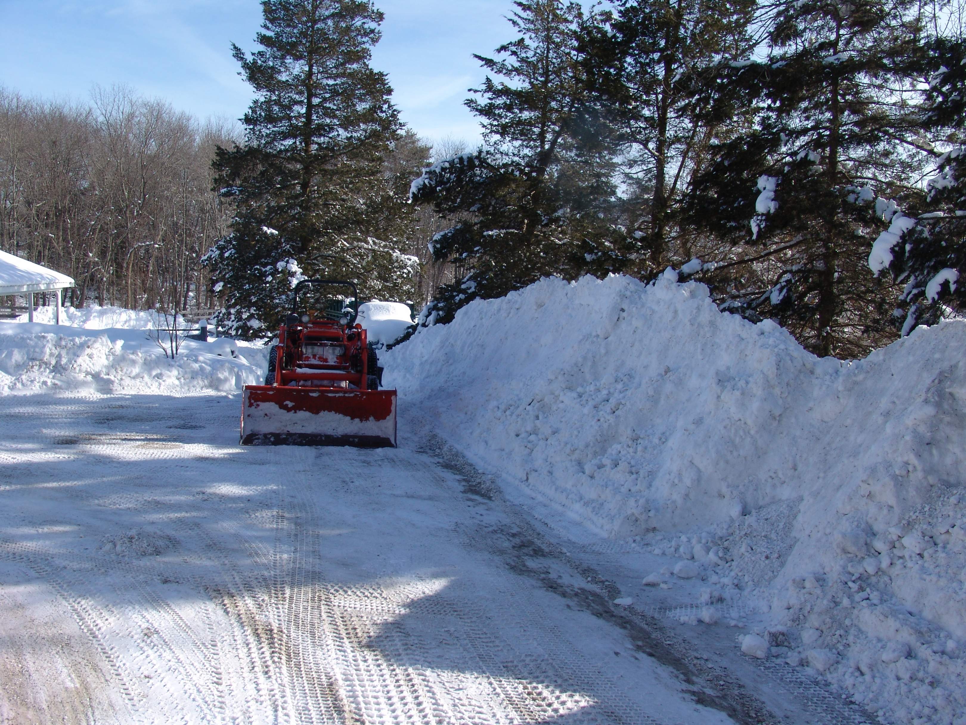

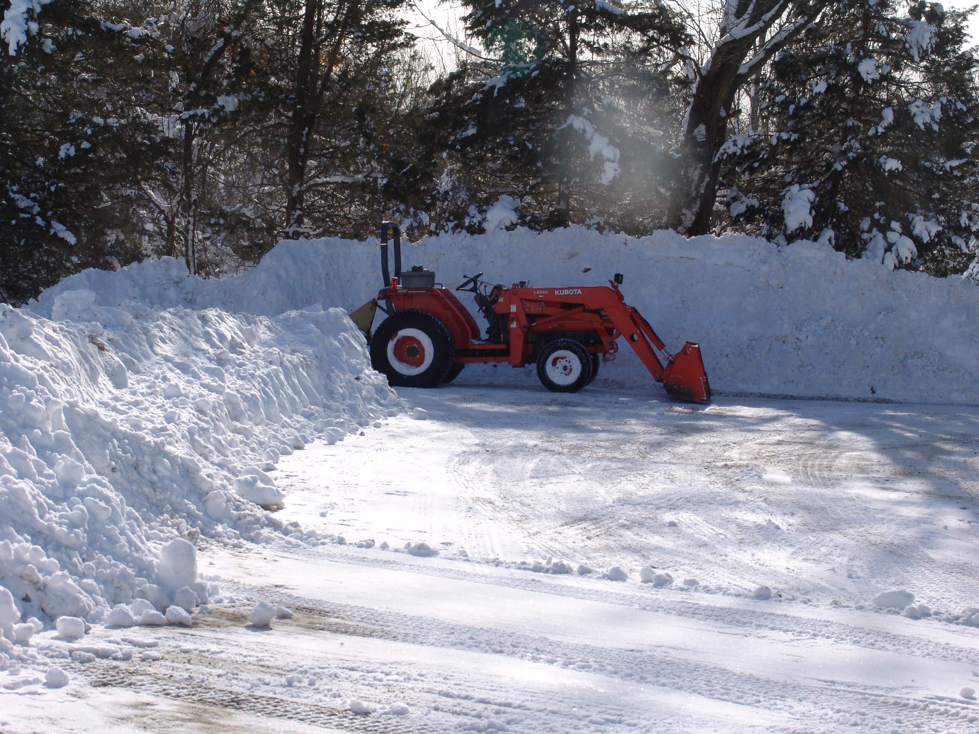

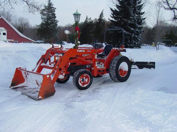

Plowing gravel driveways is tough business. I've done it for over a dozen years and still sucks. I have a KubotaL3600GST with a LandPride landscape blade and FEL. I turn the plowblade backwards - meaning I push the plow in reverse while the plow face is still facing the tractor - and that prevents the blade from diving into the gravel. The blade will ride over the gravel and not dive in and while you don't get down to bare gravel that way, you also don't have to spend a few weeks raking the driveway off the grass and back onto the driveway in the spring.
