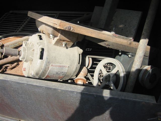

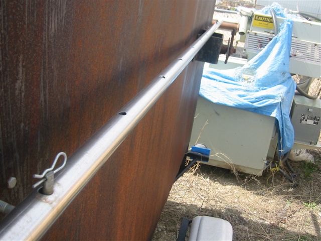

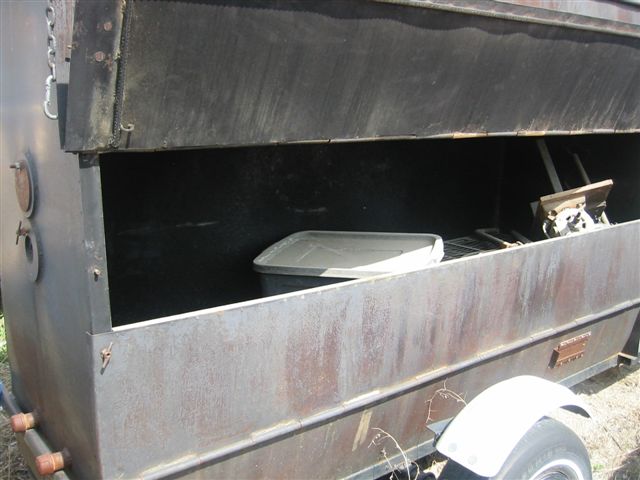

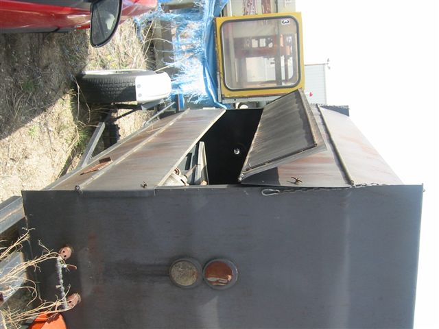

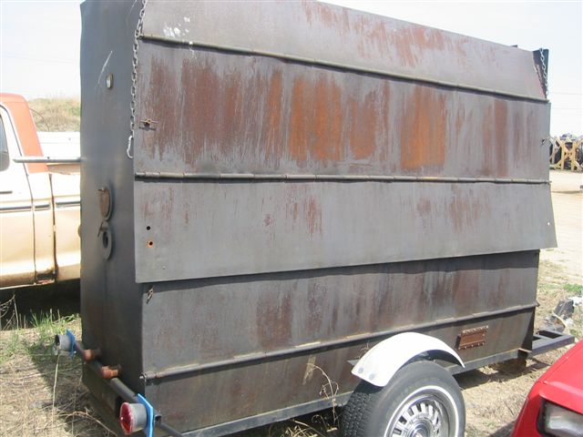

Hi Hog, this was #1 prototype, its big but works better than a compact, the good one is at the lake, basically the same, on the front there is 2 sections on the top and one on the bottom, I have holes in this one but added slots for the new one to remove the pig, this one required a support below the pig and slide the rod out, quite a feat when its 300 degf and there is spikes going thro that needs removing, we finally got good at sliding the drive off, pulling the rod back out of the hole and then pulling forward could remove the rod but its not as good as slots, the size is 8 feet long, 6 feet tall and 3 feet wide, this one was gas fired later charcoal as the new one, if you were closer you could take this one as it sits rusting nowerdays.
It was a crude prototype, done sone half dozen pigs, half of beef and did try a deer
Laurence
