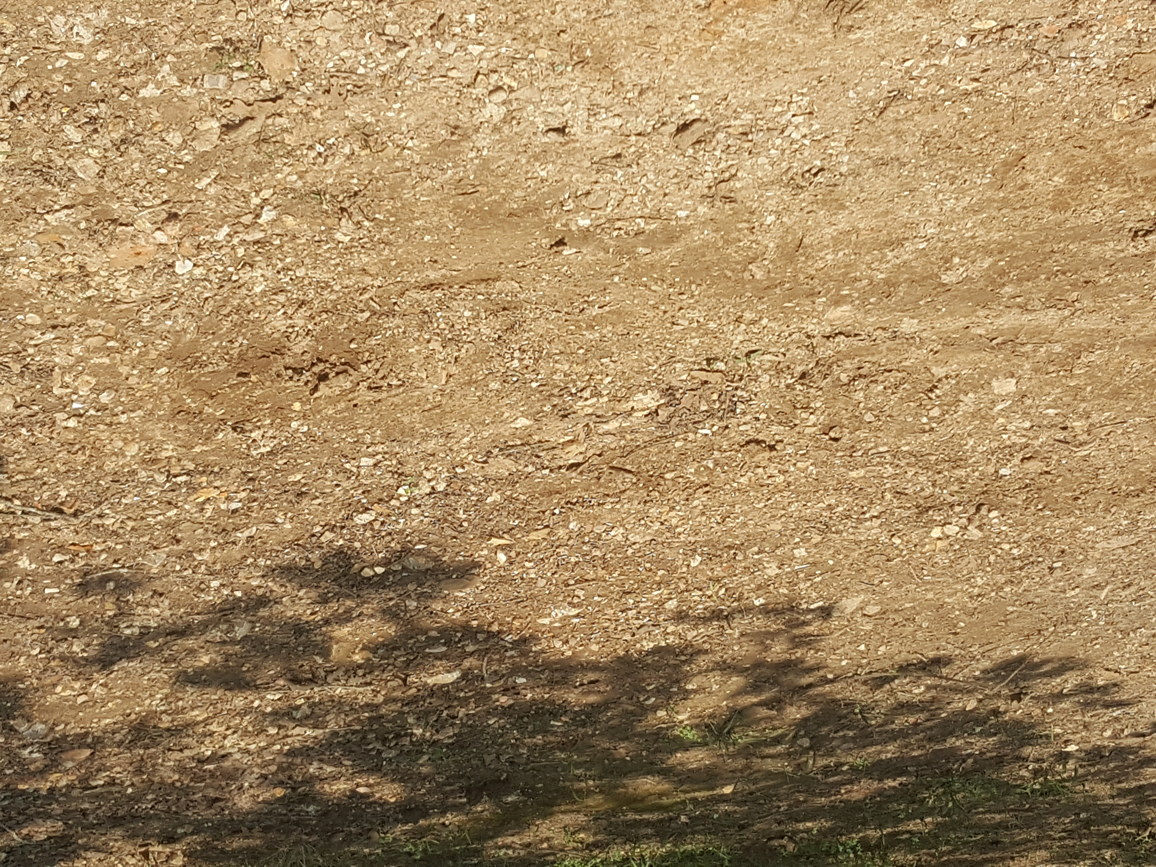

The piranha bar looks and sounds great; my indecision is based on where I live. It is the Ozarks hills in southern Missouri and the rocks are everywhere. Would the landscaping that I am doing be better done with a toothed bar where the projection is probably double that of the piranha? 20180816_133519.jpg20180816_133519.jpg

I have had mine for 3 or 4 years, 6’ bucket, have dug many many rocks, and I do not worry the least now when I catch a tooth under a rock and use the curl on the bucket to lift the rock. The bar takes more than the hydraulics can deliver and the horrible sound of digging and scrapping rock seems to do no harm to it. I have no bucket or tooth bar distortion from Seriously abusive use.
I am sure it can be damaged but my worries just like yours proved ill founded. It is much stronger than the bucket edge would have been without it.

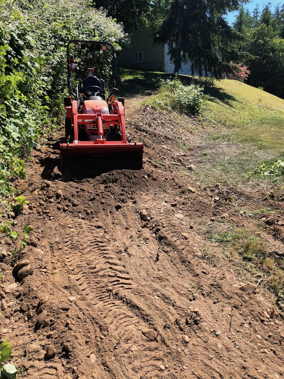

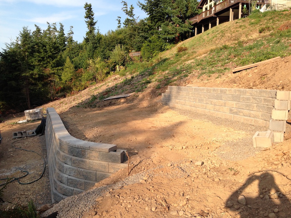

Fair enough. I have had my PTB for about 5 years and it has been the best mod I have done to my tractor. I have dug roads into side hills, and cleared lots of brush and vines, and cut and filled several terraces. I go just a little under the surface to clear vegetation and it works great. Back drag, scoop soft and hard materials and have never had a reason to take it off. About 400hrs on my BX now and none of those hours are mowing.
I don't have any experience with a ratchet rake but I haven't run into no need to improve on my PTB around my property. One or the other is a no brainer if you are going to do any dirt work. I did measure the thickness just now and it is 1/2in and must be hardened steel because I routinely hit rocks and work it hard and it still looks great! Just saying with pics to prove it. Keep in mind this work was done with a SCUT!

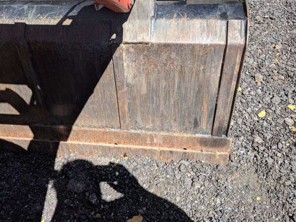

How thick is that steel? 1/2 inch or more?

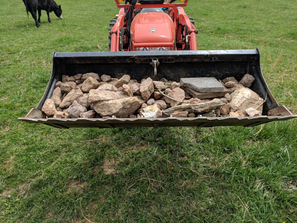

Without being anywhere near that I could measure - I would say it's about a 1/2" maybe a little thicker & dragoneggs says his measures out to that.
I'm at work so I don't have my photo library and these are the only two previously uploaded shots I have that show the PTB.
That load of rocks is 1 of 4 that I picked up off of roughly 2 acres and that was just "surface rock" that I didn't want to hit with the bush hog.
I have the same hard clay & "field stone" like GirlWhoWantsTractor and this thing hasn't hit anything that's bent it or backed it off yet.

Wow, that's a nice wall project. Did you lay the stone? What kind of foundation do you need?
Thanks! Yes wife and I did the work, 88lb Allenblock I think. For the base, I dug a small trench and laid crushed gravel so the first course is mostly buried. Had to terrace the slope to put in my wife's garden. Here is an old thread with lots of pictures of the build if you are interested.
