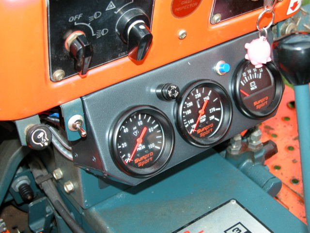

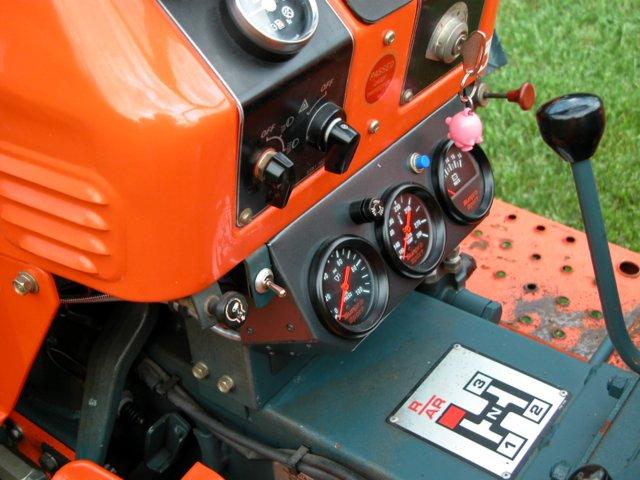

Not in the same league as most of the other guys' work, but maybe this will inspire hackers with old tractors, like mine. I felt the need for a temp. gauge, voltmeter and oil pressure gauge, and back when I did it, someone had posted a link to a supplier who had the whole package on sale for $12-14, so I couldn't resist. They've worked fine for several years now, so it was a few bucks well spent. My only wish would be for an excuse to upgrade to a larger Kubota, but this one still gets 'er done, so I suppose I'm stuck.

My friend I have to say you did one very fine job installing them. Did you fabricate the box there in? I don't know who or even how you could have done it any better. Perfect. Hats off to you :cool:

Thanks for the approvals, guys. Yep, I bent the gauge box from some scrap half hard aluminum I had. I had found a clearance can of gray spray paint for a buck, and it matches the Kubota color pretty well- another incentive to do that little project. 4shorts- does you cab have AC and heat- I'd imagine it does... Pretty nice concept- I get tired of snow blowing in my face, brances wiping more snow down my collar and cold wet feet.
One thing my old tractor doesn't have is provision for any additional hydraulics (I used my single takeoff for power steering, and though that was a needed and welcome mod, I still would love to have a blade rotator cylinder on the back). I get tired of hoping off and on the tractor to swing the scraper blade this way and that when I am plowing snow. Maybe in the next life I will live in the Upper Pennisula, and get to play with lots of snow. When we get our occasional 25" storm, I wind up using the bucket, since I don't have anywhere to push that much snow off the side.

What a nice neat job you did , it looks factory installed.

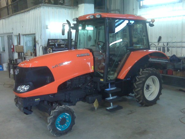

Uggh! they call this pimping? just saw this on facebook.

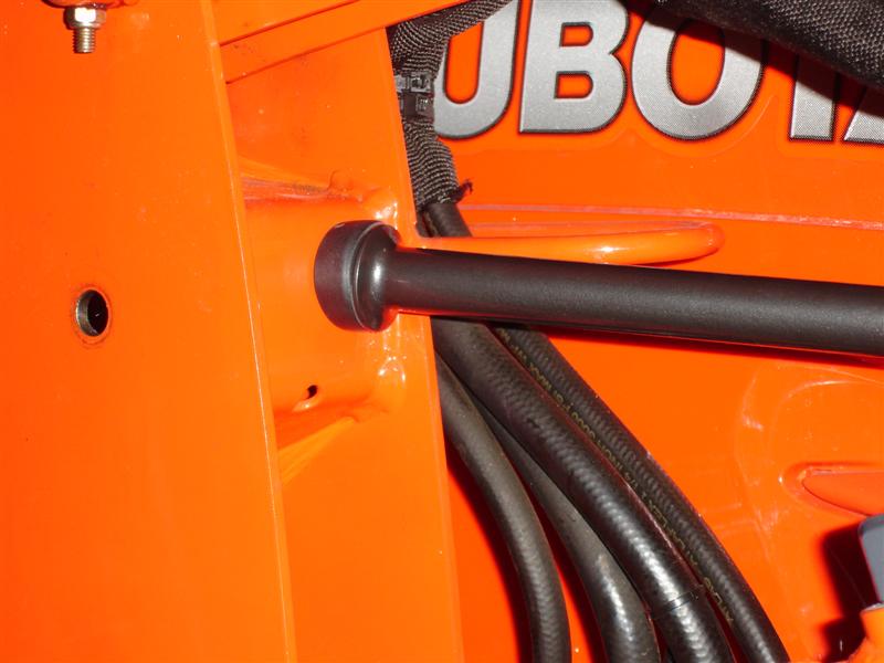

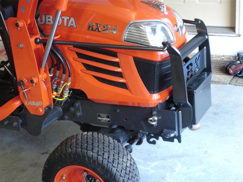

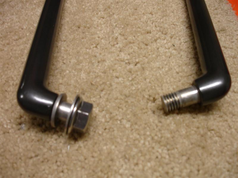

Oops, forgot my pimps;

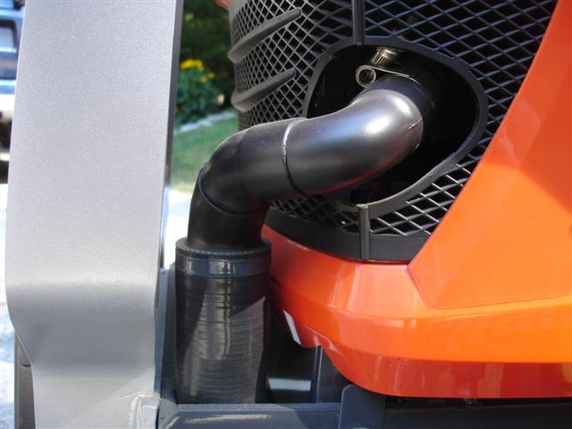

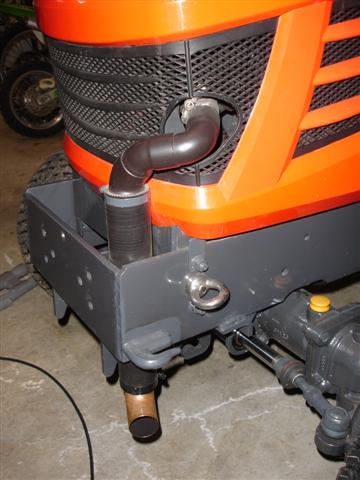

Custom exhaust with high temp silicone tubing to keep the poop off the loader arm - does kick up some dust so may angle up a bit this spring. Tubing allows flex in case the end gets tagged. Joints are 1 1/2 copper fittings.

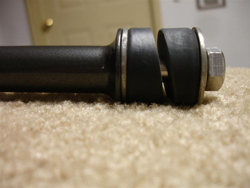

FEL arm braces took the flex out of the arm / mounts after bumping the psi up to 2000 . . .
Also added ss eyes and grabber hooks to the frame for tie down and yanking stuff + a small tab above the eyes to keep the cowling from vibrating.

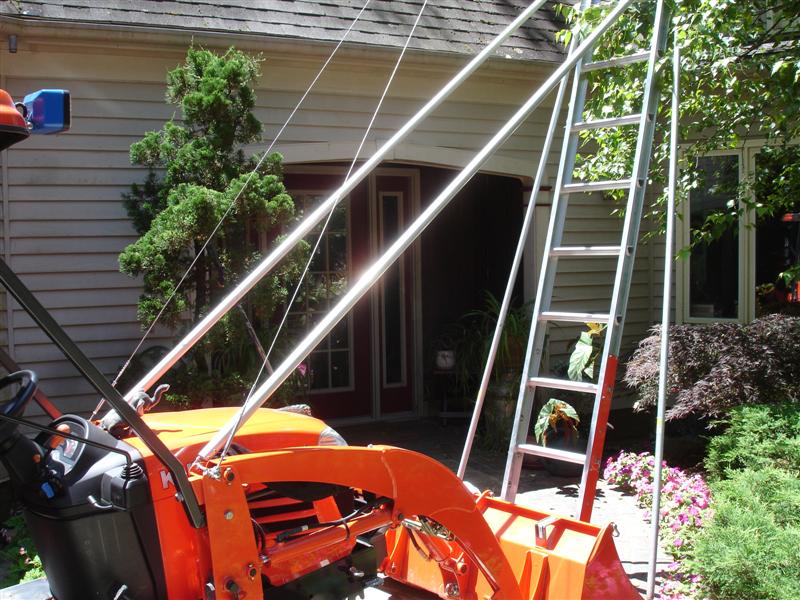

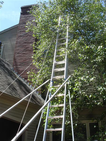

Anyone with a shrubbery problem might want to give this one a shot . .

Those are truly pimping stuff for the BX :D . The tubing you made for the exhaust, does it smell during the summer after heavy use ? I been thinking of going to my local muffler shop and have them customize a slide-on, twist to lock of some sort. I truly hate those black soot on my FEL. :mad:

No smell on the tubing (being high temp silicone rubber - Verocious Motor Sports web site) or from the exhaust which used to bounce off the arm and back in my face. 1 1/2" copper fitting slit on three sides with a dremel and a small abrasive wheel is a perfect fit to the stock muffler outlet stub. I used 650 deg. rtv at that joint and a heavy duty ss clamp which you can see in one of the pics (also from Verocious). Soldered up the fittings and used high temp stove paint on it. There is a small L bracket on the interior corner of the frame that keeps the hose from bobbling around, yet lets it slip. Very easy three beer pimp if you can solder.
