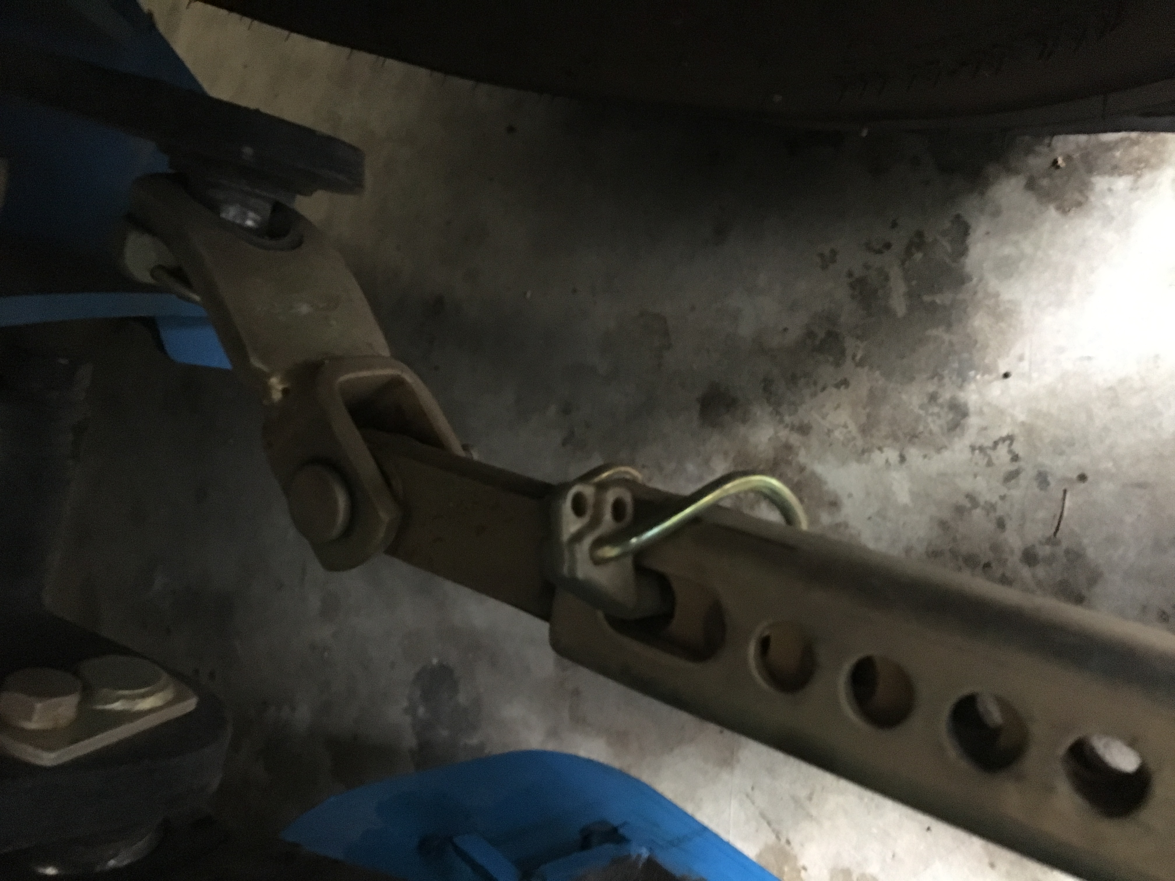

Not sure which "pin" you are talking about. Pretty sure it is not an ouch clip or hair-pin, not for that price anyway, I buy pins of various sizes there often and you can also find a smaller selection at Harbor Freight. If you have a TSC near you, go and check as their supply is pretty good. If you are talking about this stabilizer pin, they have them at TSC under lower link pin.

Okay, a simple hitch pin, similar to, but smaller than those used to connect a ball hitch into a receiver. The one on my LS is similar size, I'm sure about 3/8" diameter. It makes sense (Kubota sense) as to the price too because it is an "assembly" there is no part number for the pin on your list.

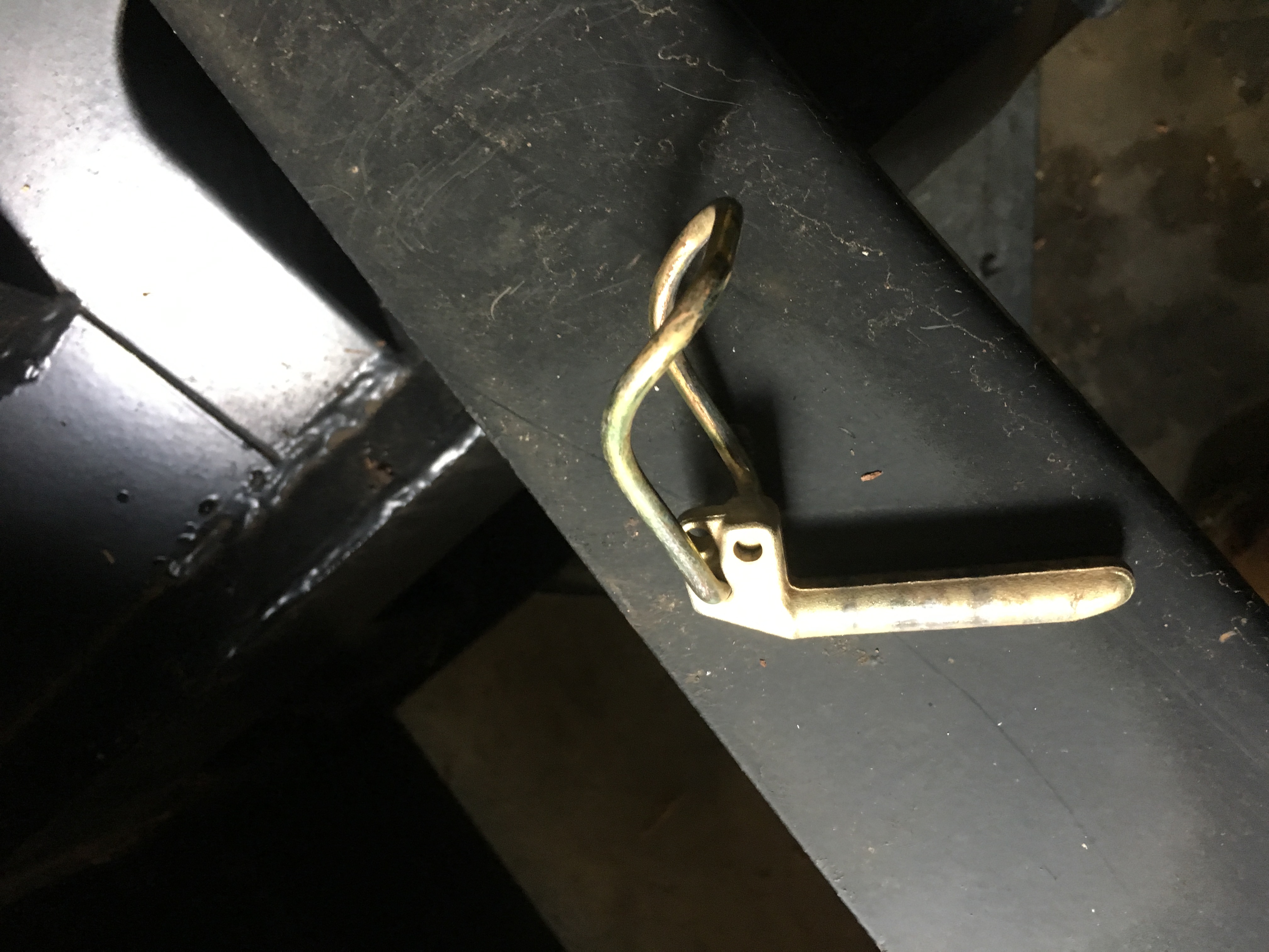

This is what mine looks like:
Grab a 3/8" bolt and see how it fits, get a piece of round stock the same size and bend the end to make the L on the pin, drill your hair-pin hole, grind a taper on the end and you have it. Or, drop a 3/8" grade 8 bolt in there with a hole for a pin and let it be.
