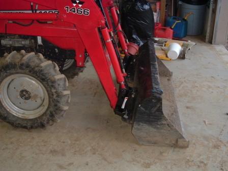

Here is a picture I took last night after adding the quick attach and putting my original bucket back on. Hook-up is a simple as it gets. I didn't need any special brackets for the bucket side; anything that is set-up to fit where my bucket goes should go right on. The only thing is you need to have top pins in all the items you wish to swap; not a big deal IMO...

   / Pin lock quick attach #15
That is the MF one that we were originally speaking about. It's as simple as you can get and with the cost of steel, I don't think that I could build anything that would work as good for less money.

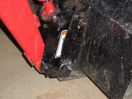

DMF, How about a closer up shot, because from the description over the phone from the ATI people this is definately different...now that you can post pics /forums/images/graemlins/wink.gif

I took a close-up this morning, but it's still not the greatest picture. It's not readily apparent, but the top part is a "hook"; you leave a pin in the top hole, slip the hook under it, roll the bucket until it hits the stop, slide the bottom pin (with the handle) in, fasten the quick-clip and away you go. It's really very slick. I'll try to take some pictures with the bucket off this weekend but it's my daughter's birthday party on Saturday and Sunday I have to bust my butt to get my pumpkins planted or they'll never be ready for September/October so additional photos may have to wait ubtil next week...

Thanks for the closeup! I think I see whats going on there! You got that whole setup for $250? Thanks, and enjoy your daughters party. Ive got my sons college graduation party this weekend so Im in the same boat!
