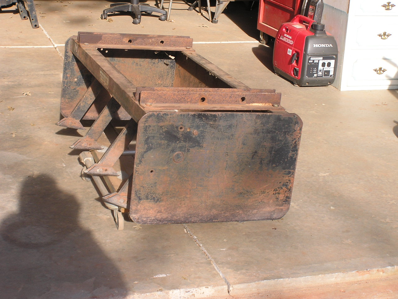

Newbury, I know what you mean about the issue of a SSQA on a small tractor. I have a B7500 and ran into your problem some time ago when I made a snow plow mount that attaches in place of my bucket. But a few years back I made my own simple quick attach as others have also. They are much lighter than a SSQA but the only downside is that any attachments other than the bucket you want to use will require the same channel type mount as your bucket. To give you an idea of what I'm talking about you can see mine here: http://www.tractorbynet.com/forums/build-yourself/244457-did-i-go-overboard-quick.html?highlight=. You can find others if you search the Customization and Build it Yourself categories. I don't have a grapple, but I do have my bucket, a snow plow, forks and a 3 point quick hitch that I can quickly put on my loader arms regardless if its on a level surface or not.
