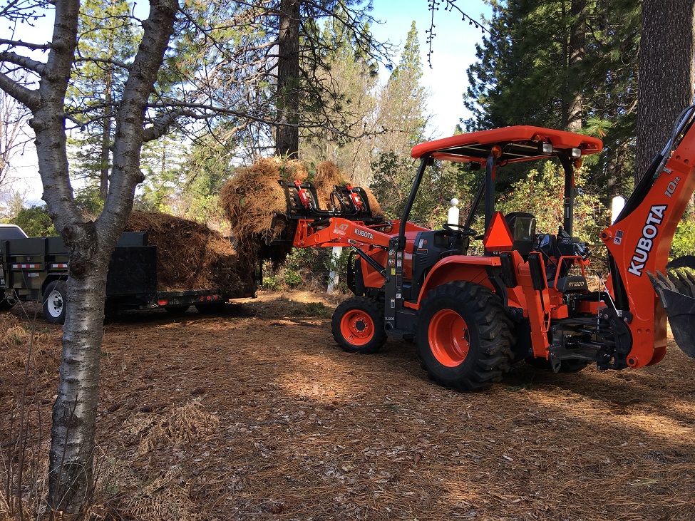

If you really wanna be spoiled, we make a Wicked Grapple for pine needle packing; just ask Rich from California! :D He has one on his L47 Kubota.
Yes, we pay good money for pine needles around here. I had 50 bales put out a few weeks ago at my house!
