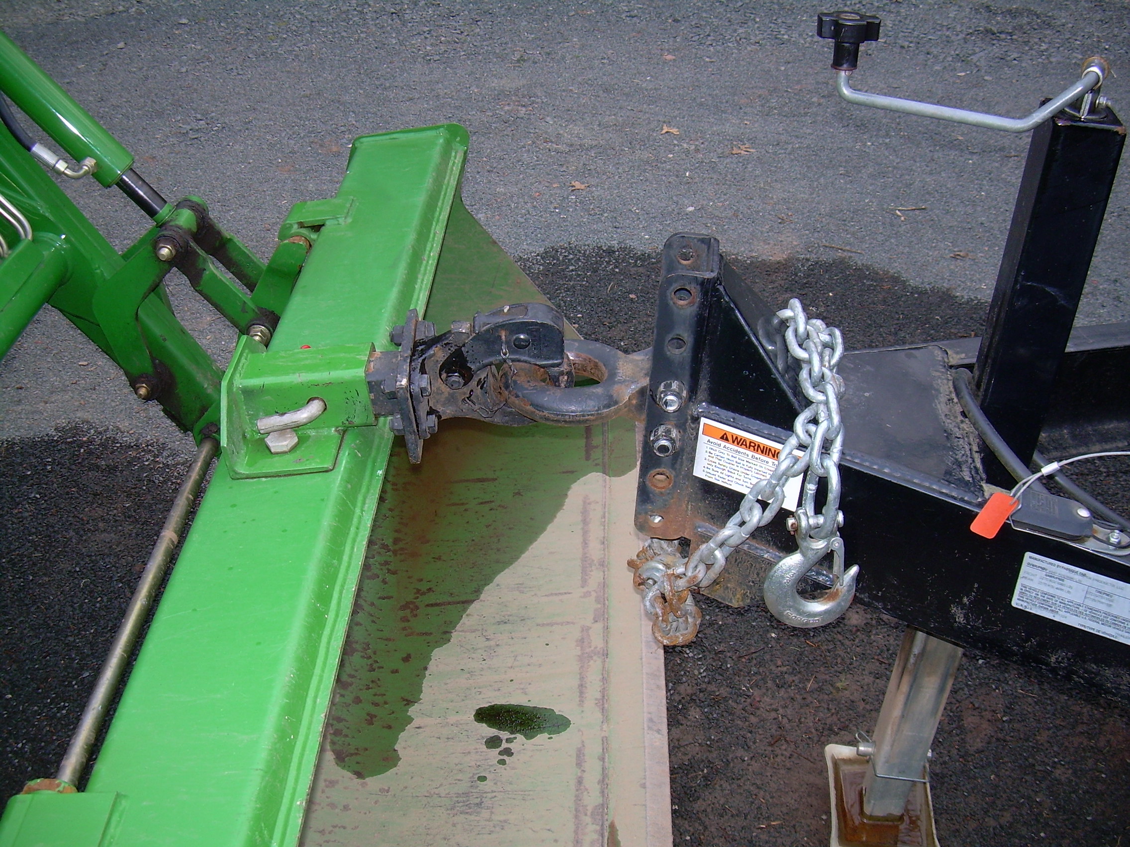

I'm considering buying a dump trailer for use around my property with my L3400, for hauling dirt, etc.
Sorry,
I missed the part where you were going to be using it around your place on the L3400.
A pintle would be a easy hookup and slop wouldn't matter.

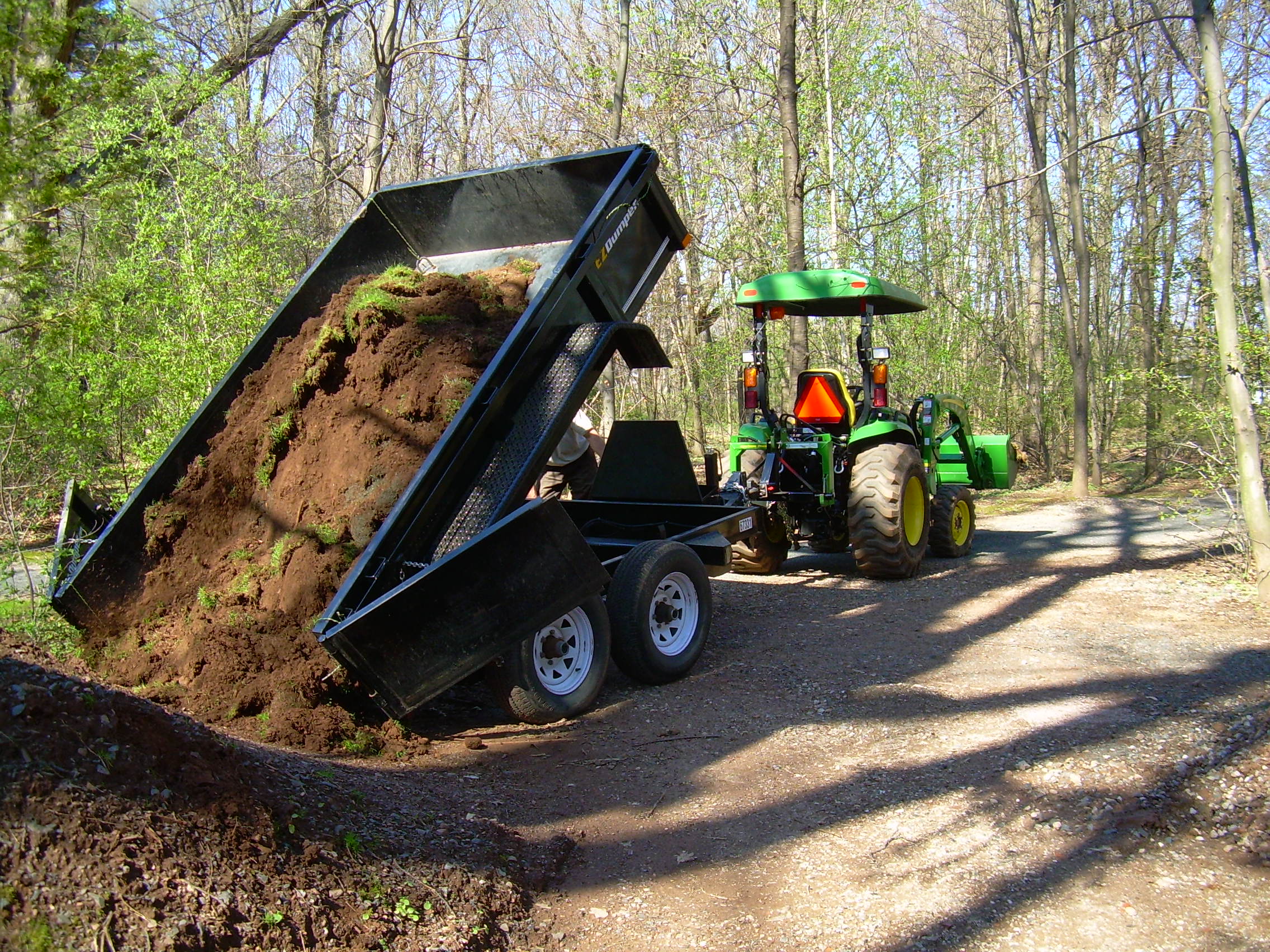

Uncontrolled 3 pt rise can occur in at least a few ways I know, like galaxie mentioned backing up a hill could do it, also going down a hill and applying brakes, but for sure it will happen with a dump trailer, when you tilt it up, before the load slides out, there's quite an upward force on the tongue.
I've got a 5 ton dump trailer and it happens to me.

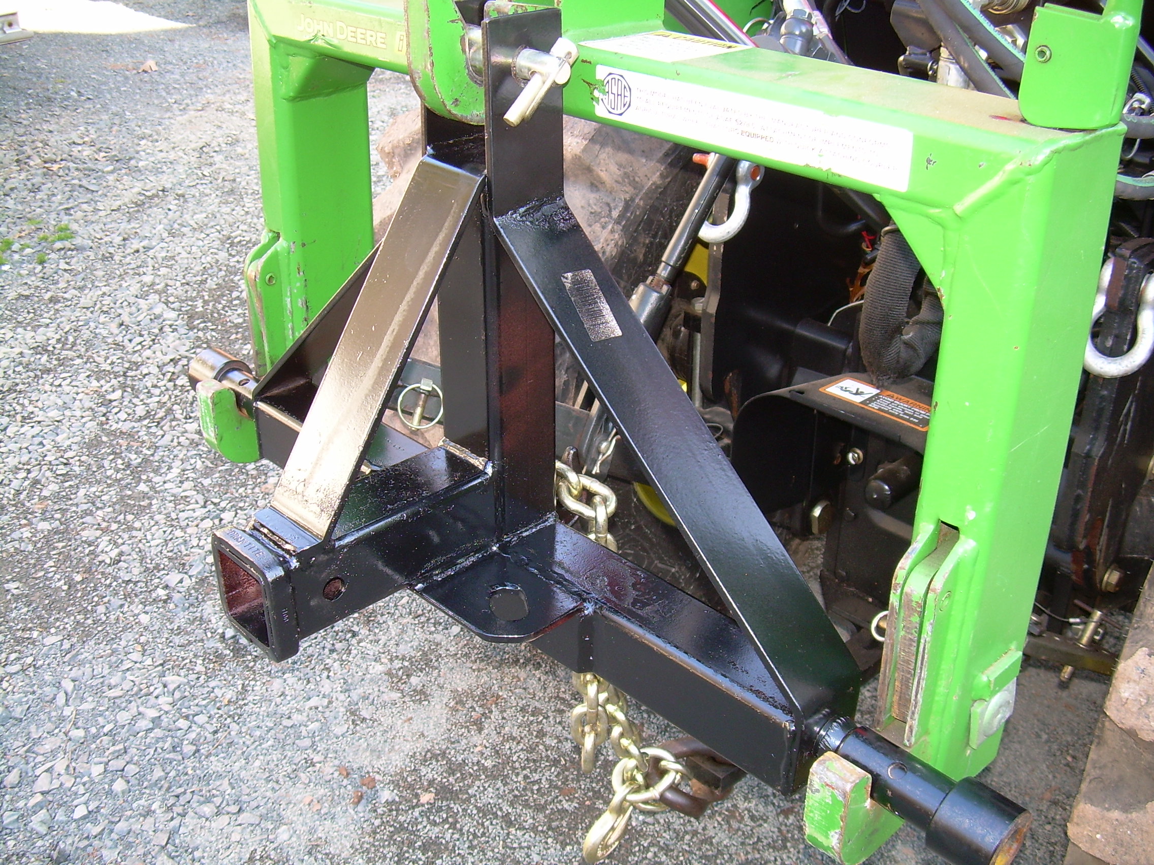

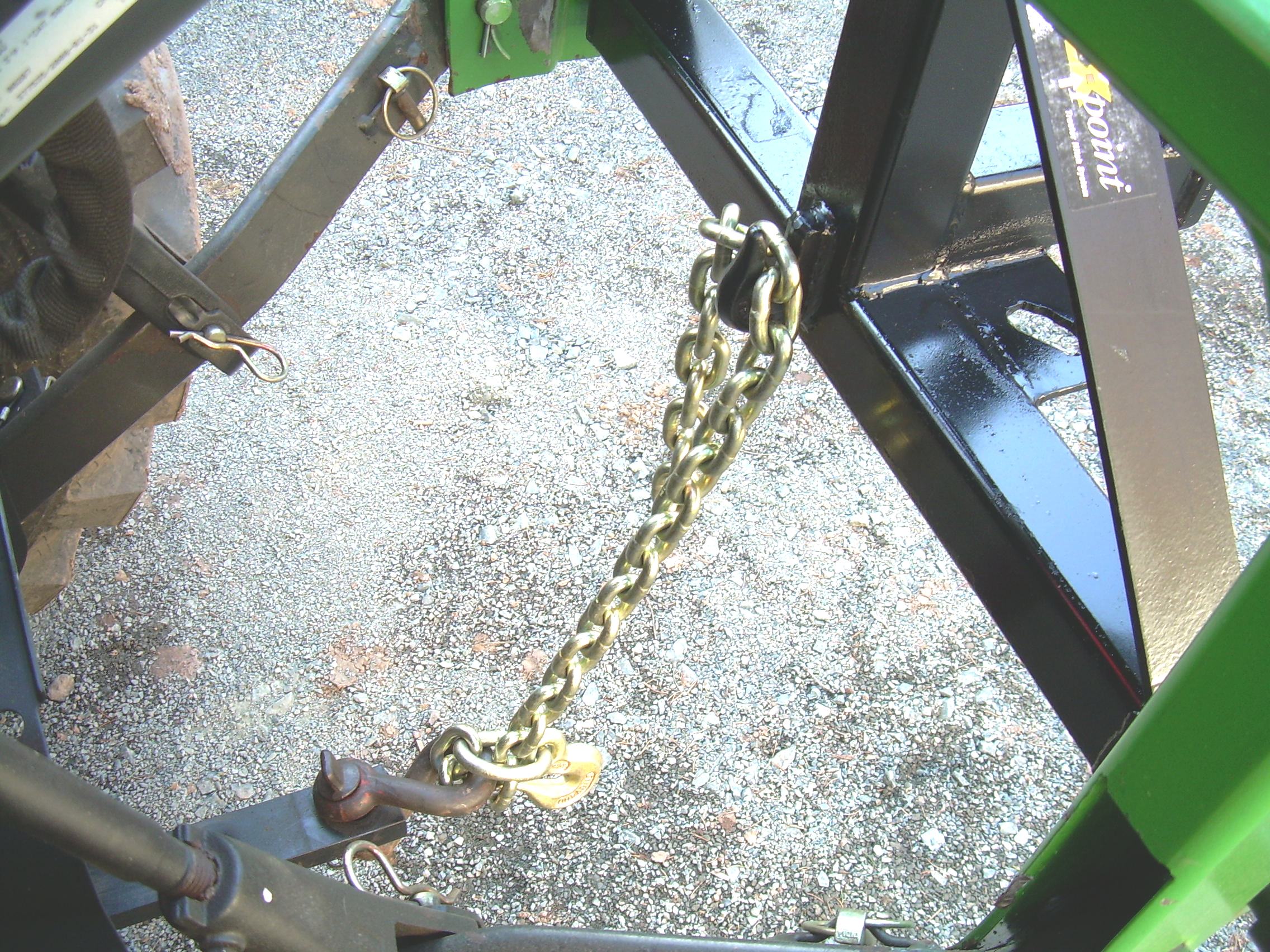

I've got a 3pt receiver type trailer hitch. I bought mine from Flexpoint, but I had to add break away chain loops and to stop the 3pt rise, I welded a grab hook for 3/8 chain that I attach to the draw bar.
Installation for Flexpoint, EZmover Tractor Hitch, Tractor Hitch, Trailer Mover, Boat Trailer Hitch Receiver Adapter
It would not be hard to build, and I would of done it myself, if I knew I'd have to mod it anyway.
I just today modded my 3pt quick hitch, added a receiver directly to the QH, so I wont even need the easy mover.
