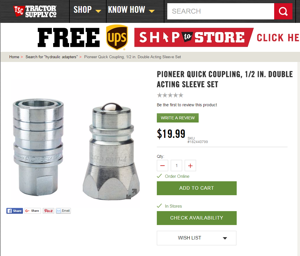

IMHO this "double acting" coupler is what you need.

It appears that the fittings I got from TSC are not I.S.O. 5675 agricultural standard. I will have to return them and see If I can get the ISO ones
