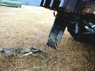

It seems that poly (roll) pipe is the default choice for anyone wanting to install pipe with a subsoiler. I have installed both poly and PVC with my subsoiler and PVC wins hands down.
Here is a picture of my pipe puller in action with 3/4" PVC pipe. I have installed about 2 miles of pipe on my farm with it.
Here are some uninterrupted run lengths that I have installed without problems:
3/4" PVC pipe - 1200 feet
1" PVC pipe - 900 feet
2" PVC pipe - 400 feet
All it takes is a ring at the base of the subsoiler foot to tie the rope to. You pull the pipe underground like a long rope instead of feeding it through a tube. It has surprisingly little resistance.
I think PVC is much better pipe with much better fittings, and the last time I compared prices there was very little difference.
Gabby

how do you fasten to the pvc pipe? lets say you have 200ft of 1" pipe glued and laid out on the ground: you tie one end to the subsoiler, stick it in the ground and start pulling the pipe?? is that how it works?

Make a pulling head out of a 1" cap with a hole drilled in it. Run a rope through the hole and knot it so it can't pull out. Then just glue it on the pipe, tie it to the subsoiler, and start pulling. It helps to dig a starter hole with a sharpshooter shovel. At the end, cut off the cap with about 2 feeet of pipe attached for next time.
Another tip - put a sharp knife edge on your subsoiler shank to slice neatly through the sod.
If the ground is hard or your tractor is small, you will need to make a pass or two with the subsoiler before pulling the pipe to get full depth.
You won't believe how easy it is to lay pipe this way. I have also pulled electrical cable the same way.

I've pulled it stop-and-go one stick at a time, several sticks at a time, and hundreds of feet at a time. The 1200 foot run was about 300 feet at a time. It depends on the space available. 3/4" and 1" pipe is flexible enough to curve it around if necessary in order to pre-assemble it or feed it into the hole.
