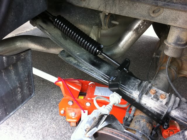

The truck is a different story. In Ford's attempt to make their trucks ride less firm, the rear leaf springs experience axle wrap straight from the factory. Sadly, the 157" wheel base truck I have has the odd-ball long top leaf springs and nobody has stiffer aftermarket alternatives. I had add-a-leafs on to fix the axle-wrap problem but one top leaf spring wore faster than the other side throwing the trust angle off and wearing out my rear tires super fast.
I'm now on a quest to get anybody to fab up a stronger top leaf without gouging me. I go over to Kramer Spring next week.

Axle wrap? What are you doing to cause the axles to wrap. I've only known that condition to happen while 1/4 mile drag racing. Any spring shop should be able to help you out.

What am I doing? Nowadays setting the cruise control at 55 mph wityh an empty truck on an uphill can cause the leafs to start wrapping. My top leafs are worn out at 45,000 miles.
Ford used the same chassis, hanger bearing and driveline angles from their old, less powerful engines on their new 5.0 and twin turbo 3.5L. The problem is more pronounced on the 3.5L which makes upwards of 420 ft pounds of torque over a very broad power band. My truck is a 2011. Ford redesigned their 157" WB trucks in 2012, job 2 to use shorter springs, but those truck owners with the 3.5L still complain.
Traction bars stink on vehicles that have a wide loading range. Spring clamps just make the leafs bind and wear faster. I used the road master active suspension product which worked great until the springs failed.

On the other hand Ford's ant-sway tech really does work well and when my truck's rear leaf springs aren't screwing up because they're wearing out, it tows the 6100 pounds of Kubota 61-2 excavator plus its trailer around very well and my 5x10, 2800ish pound dump trailer almost as though it isn't there.
Here is photo of my rear leaf and the road active suspension. The photo doesn't make clear that the entire stack is supported by only one leaf.
Your statement is confusing. All leaf spring suspensions are held in place by the top spring. That's the main leaf that connects it to the vehicles frame. Some cars may only have a single leaf spring supporting the axle. Trucks have multiple leaf spring packs. On many of the vehicles I've owned I've had a local spring shop add a leaf directly under the top spring for extra carrying capacity and for less rear end squat when trailer tongue weight is increased. The add a leaf I had installed is just about as long as the main leaf just shy of the main spring mounting eyes.
