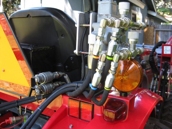

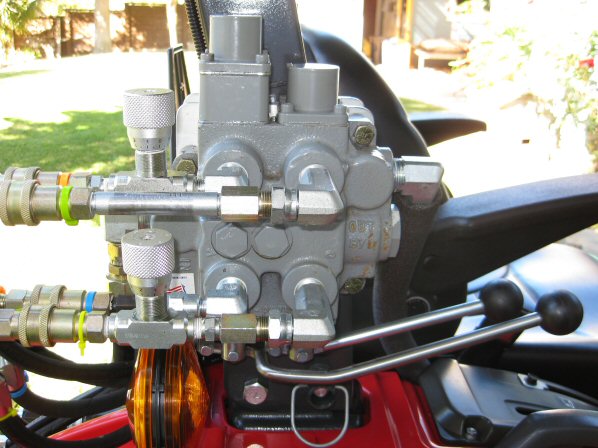

Once I attach the outlet manifold see attached...
I hard pipe the lines to the rear of the tractor where I connect a set of QDC directly to these lines (using a "T") then continue piping the lines to a spool valve to control the T&T
I figured the "machined T" would give me something to mount to the tractor and make it convenient to access the QDCs ??
Is this not practical?

Why have QDs before the spool valve? :confused: Usually the QDs would be at or after the valve work ports. Then the hoses that go to the "TnT".
Sorry, I am just not following what and why you're doing what you're doing. :confused: :eek:

You can NOT Tee those lines from the manifold to the new valve.

Pipe straight to the T&T valve and come of the PBYD of that valve for any additional remotes...
is there a reason not to hard pipe it from the manifold to the valve? or should I use a short length of hose to dampen any shock/vibration issues?

Correct, the new valve and ant additional valves (like on a logsplitter) need to be in series, The only acceptable place for a Tee is on the low pressure tank lines. Hydraulic fluid, like electricity will take the "path of least resistance", so if you Tee the high pressure lines fluid will just go through the other way.
Hard piping is fine, but not an easy job-it's also expensive. The steel pipe used for hydraulics is not easily bent into small places like where your manifold lives up to the new valve.

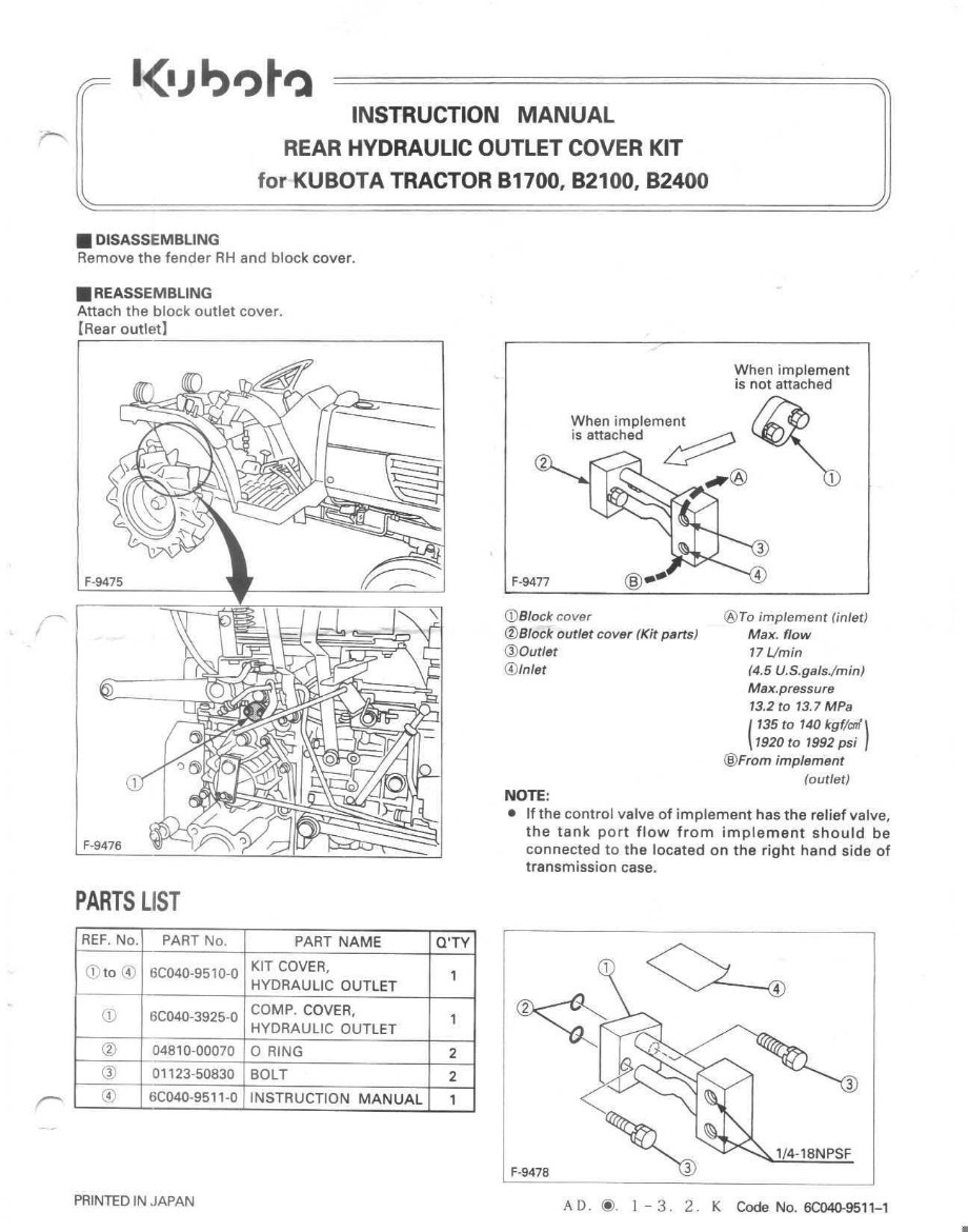

Is the (hydraulics) hard piping on a tractor not the same or similar to (SAE) brake lines ?
according to the instruction sheet (see post #6) for the outlet manifold it says the inlet/outlet ports are 1/4 18NPSF what size steel pipe would that be? I can work with 3/8 brake line fairly well...

note: on the Kubota instruction sheet for the outlet manifold..it states 1/4 18NPSF...
1/4 seems small? what size tubing/hose will best to use?
